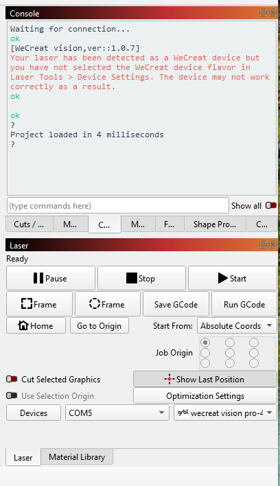

Using LB 2.1.00.-RC11 on Win 10 machine, and Wecreat Vision Pro 45.
When Starting up LB I get this message:
I have been using this set up on previous LB versions using flatbed and then rotary mode. I just took out the Rotary Pro, updated to RC-11 and now get this error message. With a project loaded, upon sending it to the laser, the laser head crashes into the near right corner, then back to the back left home position and never turns on the laser.
I cannot find anything in the Laser tools>Device Settings that looks like it would select the"Device Flavor" . what am I missing??
Wes

Try this For your device. I got this from Aaron.F .
After I imported this file my 45W worked perfectly.
Thanks Dave, i gave it a try, with mixed results. First attempt al went well, until last 10% or so of the design, when the laser beam turned off, and it went thru the motions without cutting anything, and laser did not return to home. Tried again, and it went beserk, moving laser to lower right corner, then started trying to move further, loud ratcheting noise. Tried several different settings, just a lot of strange positioning. So…rolled back to LB 2.0.05 and all is well. So, will just stay there. You know, if it aint broke…
Thanks for the file, when time allows will look at that again and see if I can sort it.
