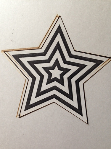

I was wondering if you could help me with another problem I am having. This past week I noticed that my machine had lost some power. I cut 80# cover stock paper with my machine. I was setting my machine’s speed to 50 and it’s power to 30 and that did just fine. I had read that a lack of power could be because of a dirty lens or dirty mirrors so I cleaned them all. When I placed the lens back in to the laser head, I placed it with the round part of the lens facing up. Is that the right position for the lens? I don’t know if the cleaning made much of a difference. When I attempt to cut, I have had to keep slowing the speed down and upping the power. I was able to cut this star out with the power at 90 and the speed at 20. When it cut, it also left and additional mark that ran parallel to the actual cutting mark. The laser cut the star right on it’s black outline but left those additional marks inside and outside the star. I also cut a circle at the same time as this star and part of the circle did not cut. Do you have any ideal why this is happening and am I setting my lens back in the laser head correctly? I set my laser focus to 6mm as I usually do. Also, what temperature should the room be that houses my laser cutter? Thanks you Oz! Your advice is very much appreciated! Below is the cut star.
That is almost certainly from the beam hitting the nozzle / cone on its way out. The reduced power is because the beam is being partially blocked or reflected, and that ‘echo’ you see off to the side is the reflected part of the beam. Check that the laser is hitting the mirror at the top of the lens just slightly above center, and that the beam is going straight through the air nozzle, not hitting either side of it.

Okay. That’s really interesting. So that “echo” is a result of the laser beam not going strait through my laser head? And the reason for that is because the laser beam is hitting the last mirror in the wrong place? Does that mean that I have to check the alignments of all of my 3 mirrors or just the last mirror? Can I place a piece of masking tape in front the last mirror and pulse my laser to figure that out? And why should the laser hit the mirror slightly above center?
Honestly that depends on the machine and the 3rd mirror - many of them, because of where the mirror sits, need to have the beam hit just slightly high because the mirror is set back slightly, and hitting it high pulls the beam forward. In reality I should’ve said hit the 3rd mirror wherever you need to in order to send the beam perfectly vertically through the nozzle.
I would check alignment everywhere - if you took them out to clean them, it could be any of them that’s out of alignment.

Thanks Oz and Jayeleitch! I realized that the mirror in my laser head was slightly off. I re-aligned that mirror and I think I have power again! I appreciate your help!
