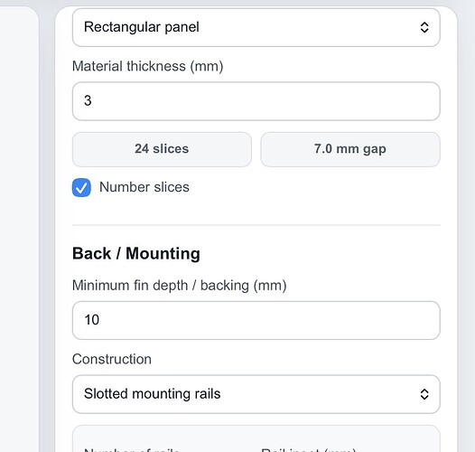

Did not see this either… There are a lot of pieces. Is there an option to number or letter them? I seem to remember that being mentioned, but did not spot a setting for that.
Yes you can opt to have the slices numbered and even choose the height of the numbers.

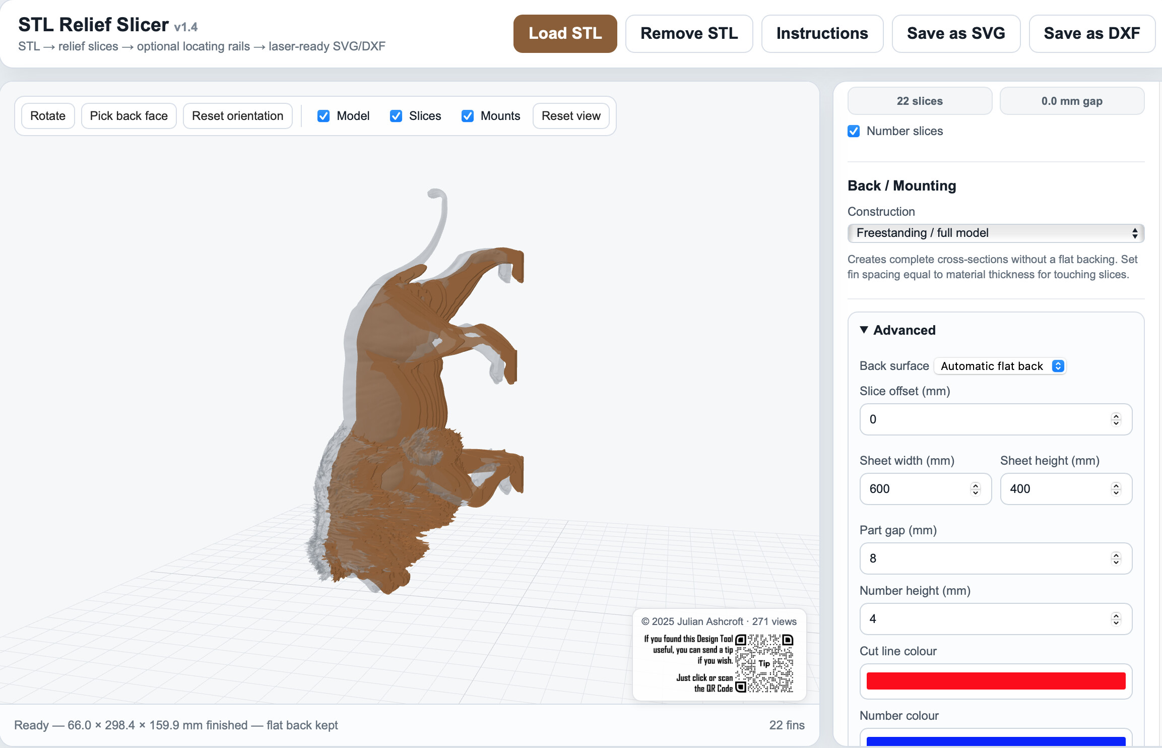

I have found how to slice for freestanding models.

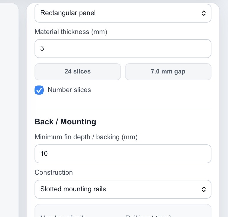

The app has just been updated (v1.4), the svg lines should now be visible in affinity style editors, the sheet fit should work better now. The Raw Relief has been renamed as Freestanding / full model. To get rid of the gaps just reduce fin spacing to the same as the material thickness and you get a solid model.

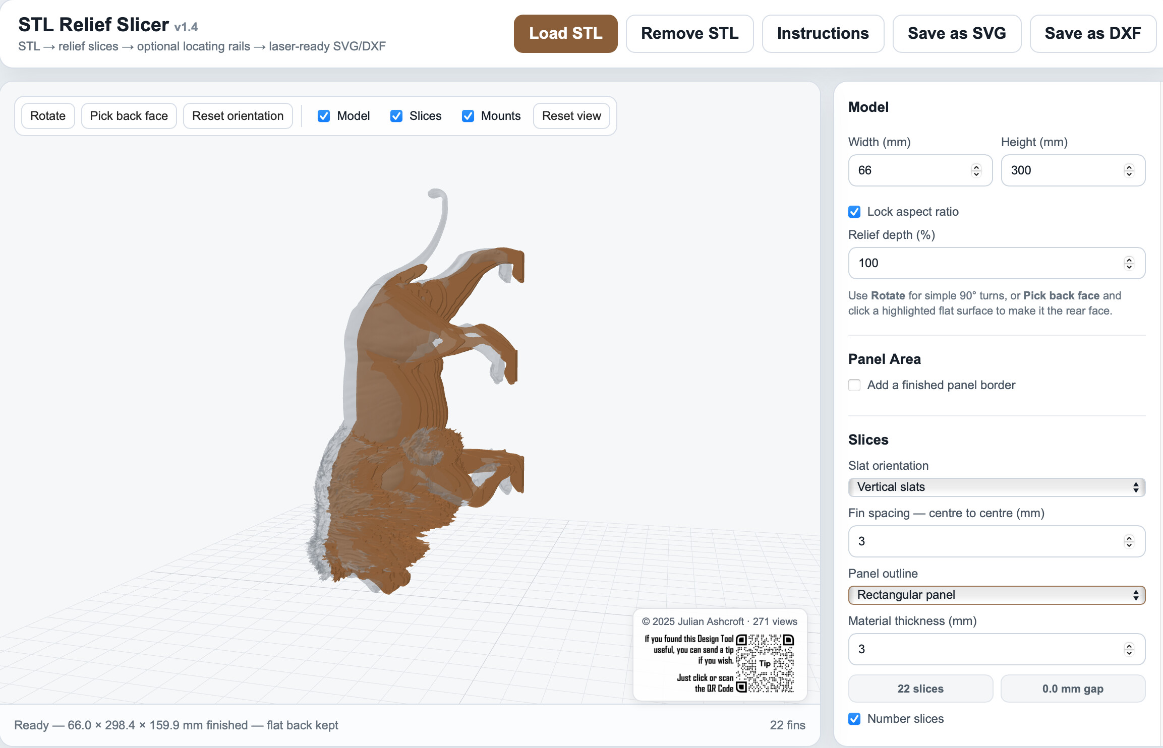

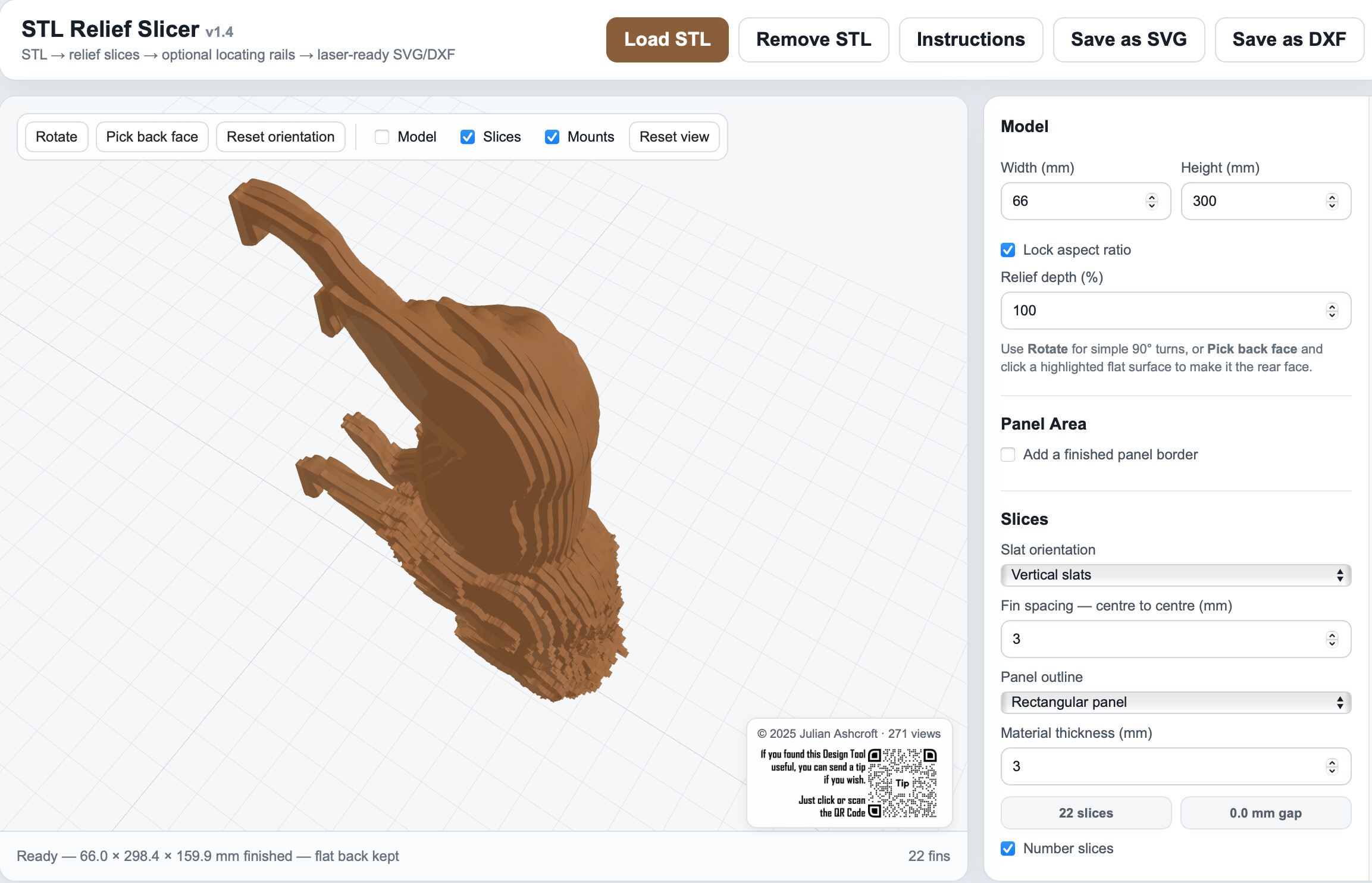

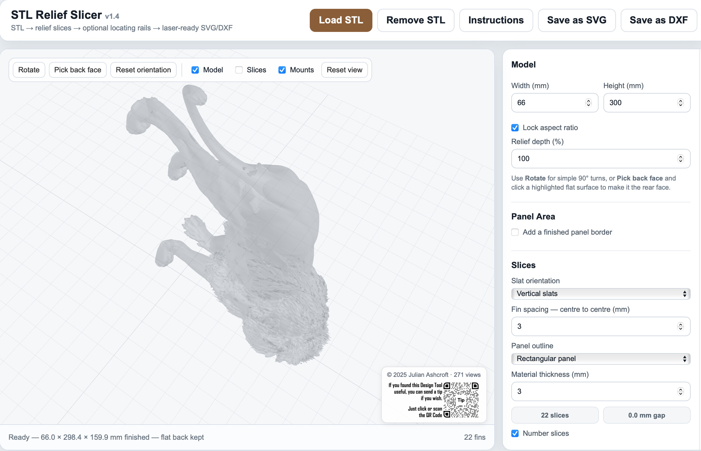

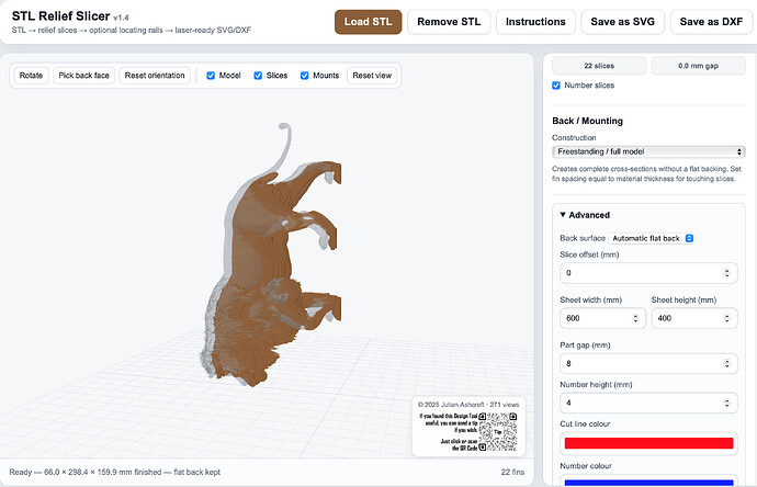

I have just sliced a Lion, but it missed off his tail. I attach some images to show.
I can send the STL if it helps.
I certainly do not mean to criticise, but
it looks as though the App scans a line of the model and draws the shape, but if that model widens after that line it stops.
For instance the Lion has no back leg hips as they are wider than his midrift.
Thanks for the changes so far. It makes it more obvious.
Send me the stl and I’ll have a look.
