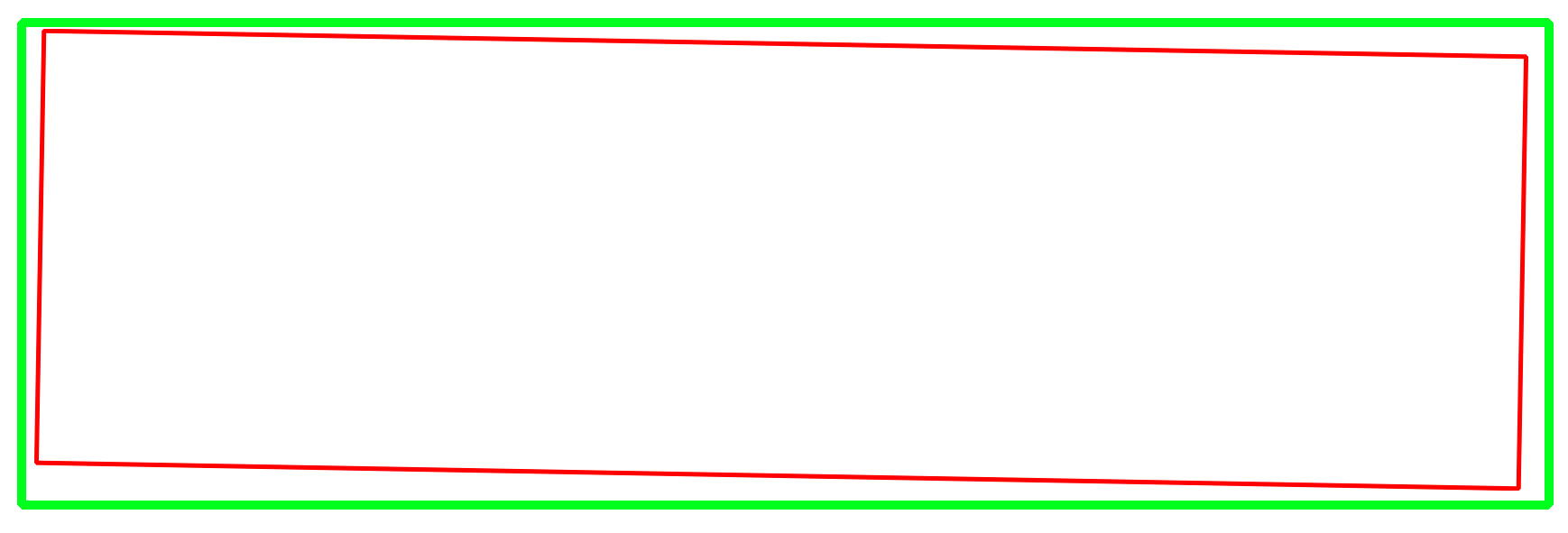

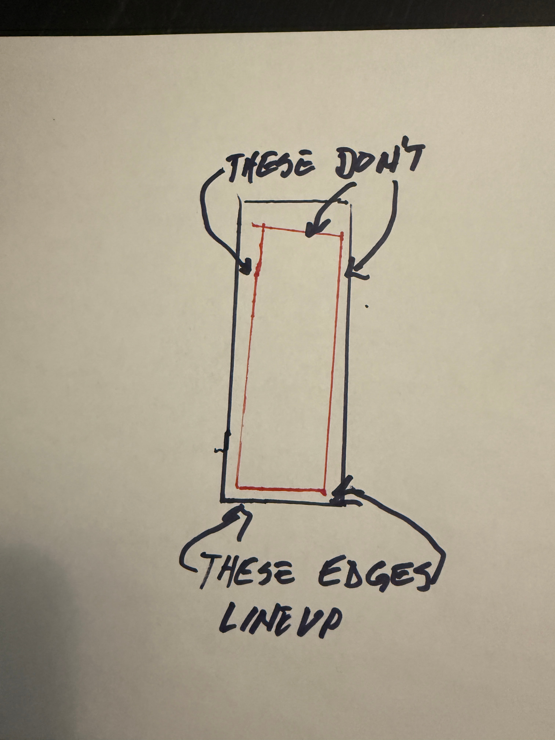

I’m trying to find the setting to straighten the framing red light. Seems like it’s at an angle.
In the image, the green is the piece to be engraved and the red is the laser. If I adjust the piece to line up with one side of the red, the other sides are off. I hope my image makes sense.
Any help on tweaking this?
Thanks.
50W Fiber 200x200
So if you engrave a rectangle, and then project the framing laser, you get the results in your sketch? I don’t believe there is a way of changing the skew of the framing laser without changing the skew of the source laser. How is the calibration of the lens?

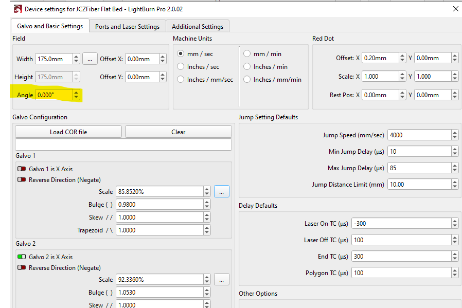

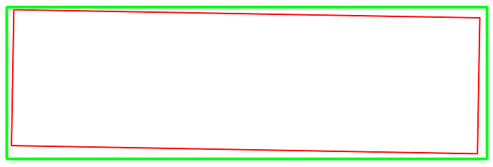

The image below might show more clearly the issue with the framing. One out of four edges line up. I saw on an LB facebook group post that the ‘Angle’ adjustment in Settings may fix it but haven’t tried it yet.
Ok, understood.

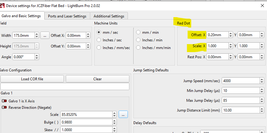

If I was you. I would run 9 point correction, then scale utility, then check skew and adjust if necessary, get your laser burning a perfectly square square that is exactly the right size. If you are running a 200x200, calibrate and then double check at maybe 100x100 and engrave on some black painters tape, then project the framing laser and adjust its scale and offset. The source calibration laser fields will not help with the framing laser, only screw up the source calibration.

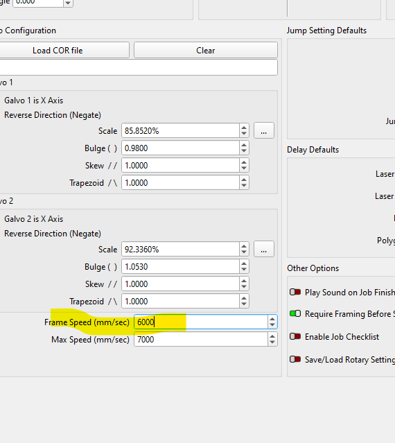

For taking a picture of the framing laser, set its speed to 6000+ and you will get a better image then the typical 3000

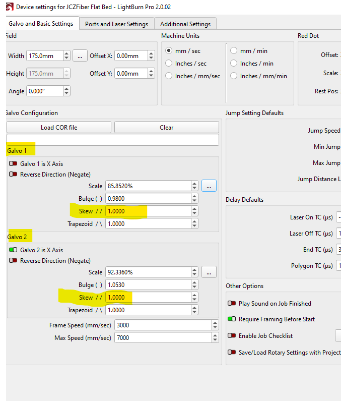

Skew adjustment:
Measure it from the edge of your bed. Roughly parallel?
That is the angle adjustment:

Then adjust the red dot:
And report back with pictures and screenshots.

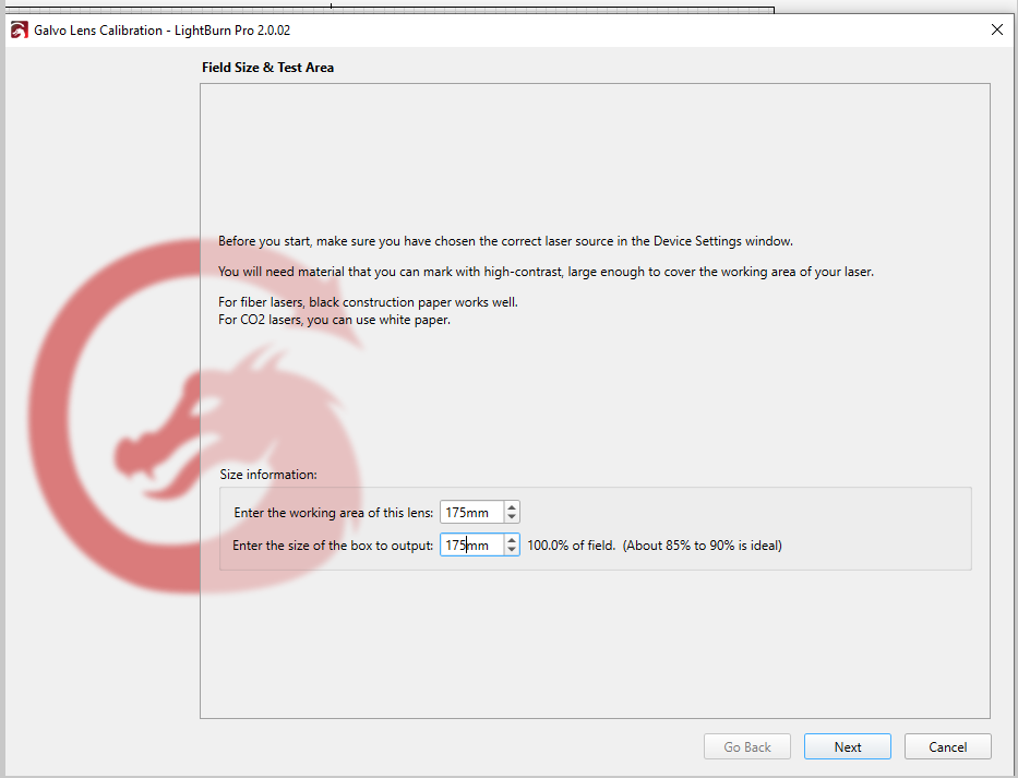

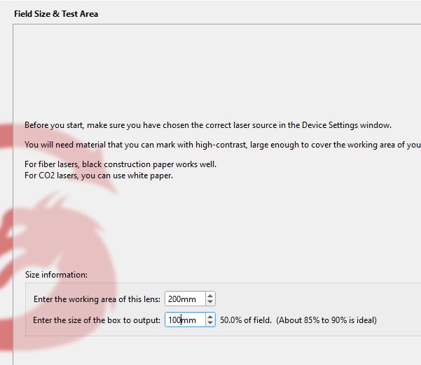

I’m trying to do the 9 point calibration, which I have done several times before with no problems, but this time the frame is way too big. Way too big. I checked the settings, and it’s set up for the 200x200. The 9 point screen says it’s 200. I lowered the frame size to 100 and it’s still too big. The focus is correct. This is after upgrading to 2.0.04.
Any ideas?
When you say you lowered it to 100, you mean here?
I’m not by my laser right now, but I would try to burn the 100x100 square even though the redlight is off the edge. Turn the power way down for the first test. Make sure you are in focus. Make sure rotary is off. I might have time this afternoon to try the 2.0.04 ver but I don’t have 200x200, do have a 300x300 lens though, I’ll try that. Might be next week though if I don’t make it today heading out for the rest of the weekend.
Yes, that’s where I put the 100. I’ll try it and see what happens. It is in focus.
I did an engraving right before trying the 9 point and it worked well.
No rotary.
No hurry and thanks.
I tried the various output settings (100, 150 & 200) and the framing size stays the same, about 235mm square. But, with each setting, the corners clip. The lower I go with the output setting, the larger the corners clip (miter).

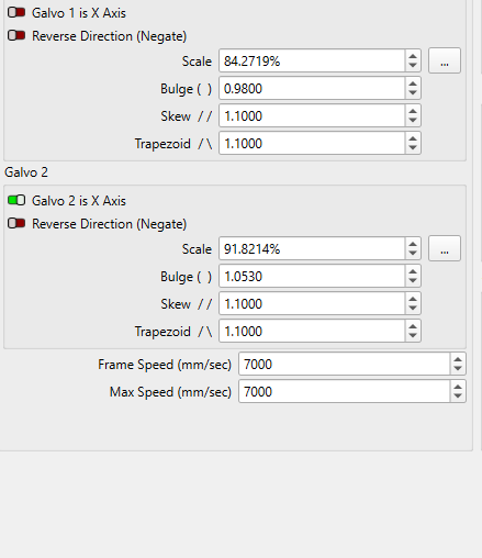

I tried correcting the original problem of lines not lining up. I tried various settings in ‘skew’ and ‘trapezoid’ and I could make the lines go FURTHER out of alignment but couldn’t make them go the other way. Seems LB does not accept negative numbers.
On your square with clipped corners the skew and trap should be affecting both the source and the framing laser the same amount as far as I understand the mechanics. If you are changing the redlight laser without affecting the source laser with skew and trapezoid something strange is going on. Unless I’m missing something.

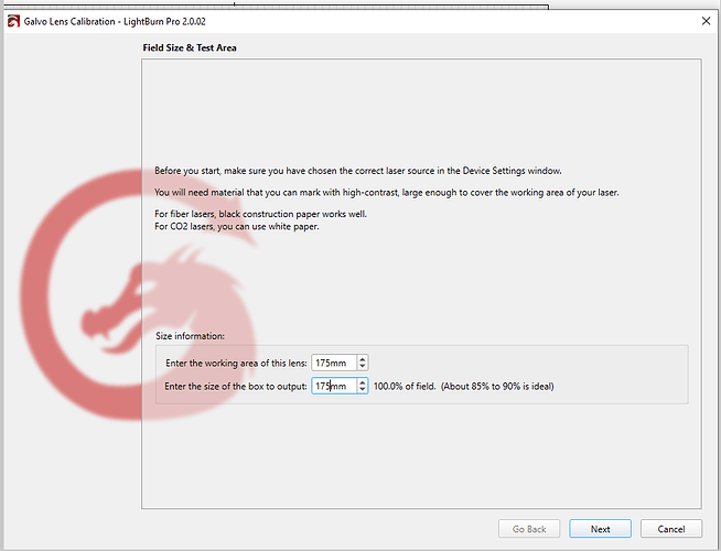

Ran some tests. 175X175 F254 lens. BJJCZ Lite board. at 100% the square is almost 200x200, (with no corrections) but projects fine. Both the redlight and the source laser close to same dimensions
https://youtu.be/4uxDZ5FVR_Y

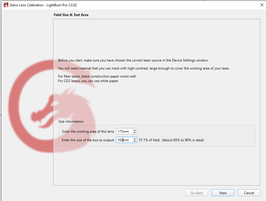

at 100mm setting 57.1% (Same lens) the projected square is 115mm.
https://youtu.be/GltYUkzNJ3Y
So reducing the field size and test area settings scale reduces the calibration square projected by both the redlight and the source (on my machine)
LB 2.0.02
After running the rest of the test and then the scale utility:
So if you notice on the 57.1% test, it projects the vertical and horizontal lines off the edge of the screen but still makes the smaller box and is close to the red light framing size.

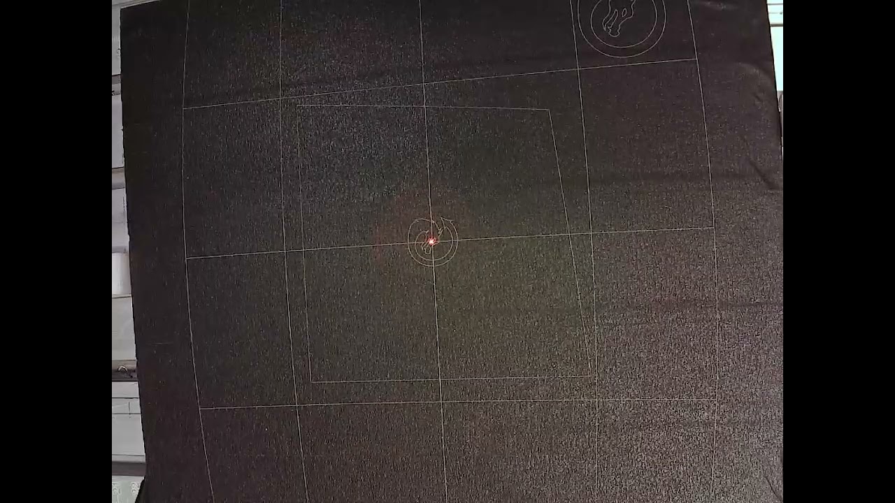

Here is a video with intentional skew and trap way off. Burn (Source Laser) and Framing (red Light) laser skew and trap identically.

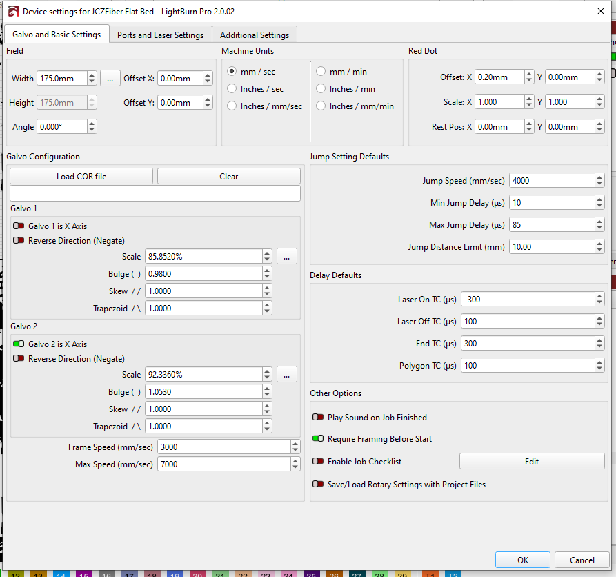

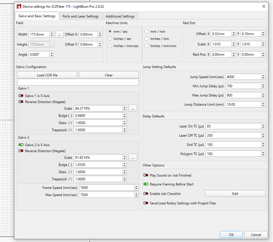

Post a screenshot of the device settings window Galvo and basic setup screen:
Checked a couple things on mine.
My 100X100 is F=160 and it measures 165mm from the table to the glass when in focus.
My 175X175 is F=254 and is about 280 from table to glass when in focus.
So if you have a 110x110 I don’t think you are in focus at 130mm. Not evven close. Should be over 160. Something to check anyway If it’s F-Theta is 110, then you have something like a 70X70 and 130 would make more sense, but I can’t find a F-Theta 110 lens on google to check.

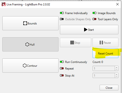

Clear count and set framing window to repeat or run continuous
. Crank the galvo up to the top, start there with the repeating or continuous burn and lower the galvo until it is making the most amount of noise. Go up and down a bit at a time until you are satisfied. Flip the piece over andd start there, go up and down a bit to confirm.
