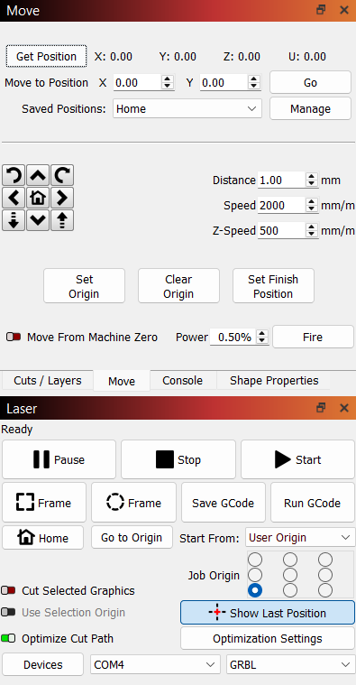

Using the X & Y axis control I can move to specific places correctly, BUT, when I use the “move to coordinate” function, it moves negative Y axis to the limits and beyond. Even sitting at 0,0, when I give the move to 0,0 command, it moves negative Y axis beyond limits.
Attached is the grbl settings and my “move” console.

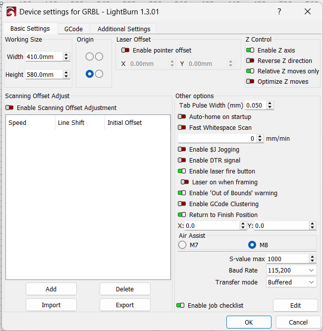

that is strange, the correct size is reflected in my device settings:
 ![image](https://forum.lightburnsoftware.com/uploads/default/original/3X/b/8/b83fe40cde1ed54f807f1b43998b035b7264bdf2.png)
and is reflected in the size of my work area:
 ![image](https://forum.lightburnsoftware.com/uploads/default/original/3X/9/f/9f819b4cf1b4a1d3e74ff375b4b8d4b95a141634.png)

> [@budprop](#):
Your device settings are entered manually. They do not necessarily reflect the actual size of the machine. Can you confirm the exact size of your work bed?
If you are positive that your machine is 410mm X 580mm, then you can enter that into the firmware.
Type each into the console:
$130=410 ,then press (Enter)
$131=580 ,then press (Enter)
Type $$ to see the changes have been written.
