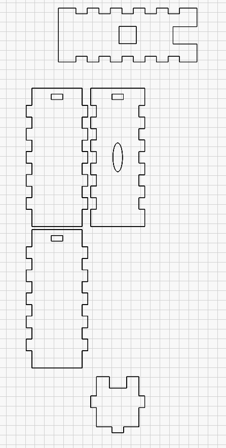

I don’t see any fundamental issue in the g-code.
Here’s what it looks like imported back into LightBurn.
This is a good indication that the issue is downstream from this. Your controller is mostly likely doing the right thing so still heavily implies a mechanical problem.
