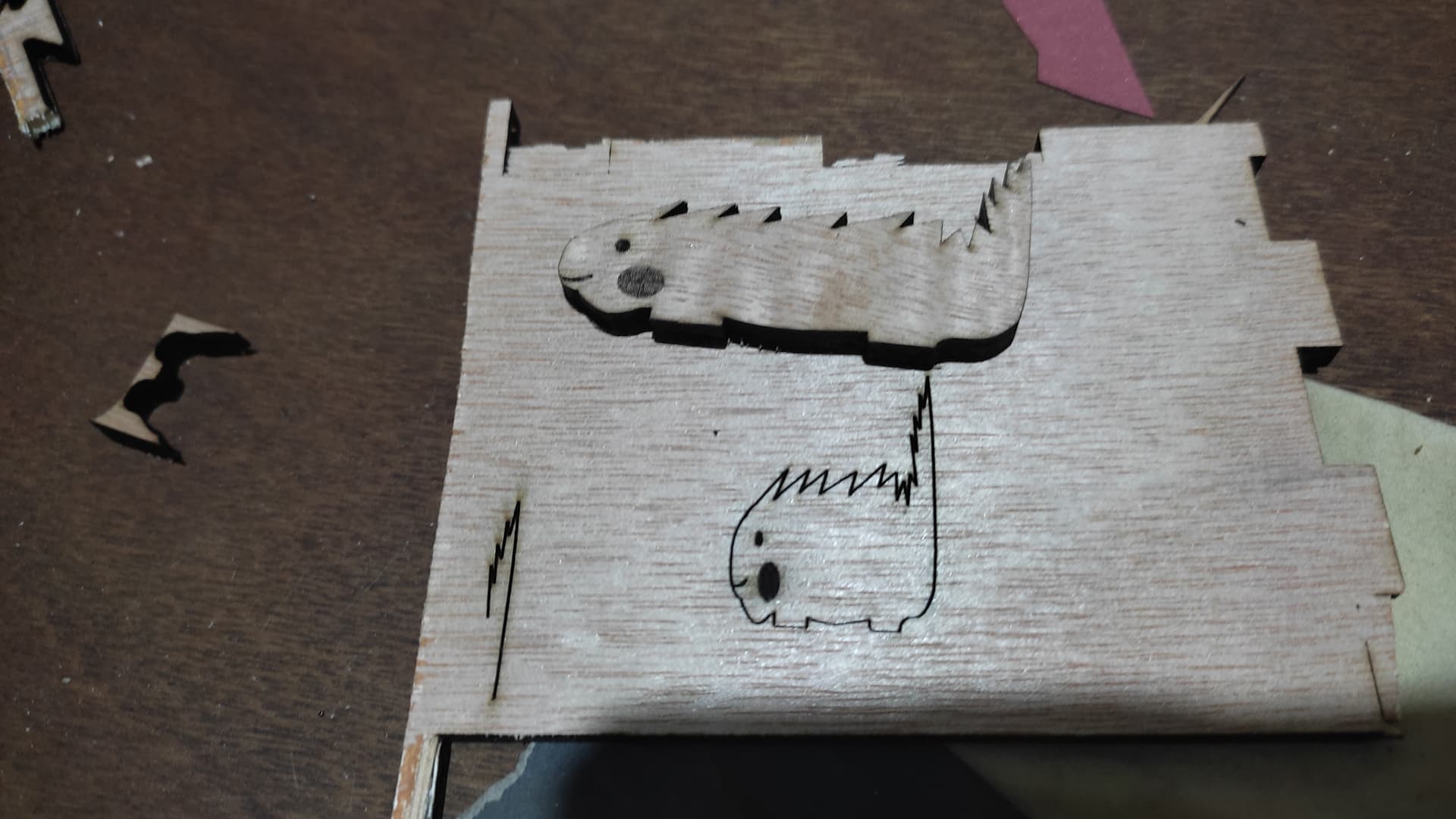

Suddently, my sculpfun S9 has problems withbthe x-axis. When I turned it on today, and let frame or cut, it is moving on half speed. Images are getting to narrow.
Two days agi I used it and everything was fine :thinking:
Im wondering if I (or my cat?) touched somthing.
Device settings seem to be OK, also unplugged and plugged the cable.
Any Ideas? Thank you!!!
Above the original figure, below how it is lasered now

I cleaned and tightend the belt. Now it runs very smooth on 45° test… But the problem is the same
Im not sure where to find the steps/mm adjustment. Is it this Windows?
I noticed diferent values on that (32 for x axis, 80for y).
Should I change this?
Thanks
Yes, you should. Send “$101=80” in the console window. Or set it in the machine settings window, after closing the calibration window. That’s the reason for the incorrect movement.
Great!
It was $100=80 but now it works fine!
… wondering how I changed this accidentally?!?
