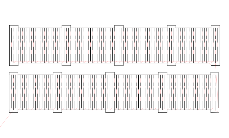

Hello,
Purchased a file on etsy, loaded the svg file into lightburn, put this picture on a separate layer.
Go to preview and there are two areas that are not closed (cut) that they need to be.
Tried custom outline, drawing an outline with the pencil tool, even imported it into inkscape and tried to use the path/union tool.
Re-downloaded it from the vendor, made sure it was unlocked before using it.
Had another issue like this and I was able to convert to a bitmap, then trace, re-save as an svg.
This file is too complex because the cuts are for a flexible band.
Any/all advice would be great.
The bottom, right of both of these should be squared off like the other tabs.
 ![tt](https://forum.lightburnsoftware.com/uploads/default/original/3X/e/2/e2187b78bad2095f4e07da173cdaa59feca94d6e.png)

NODE EDIT to manually connect the open spots.

Tried node edit, no luck!

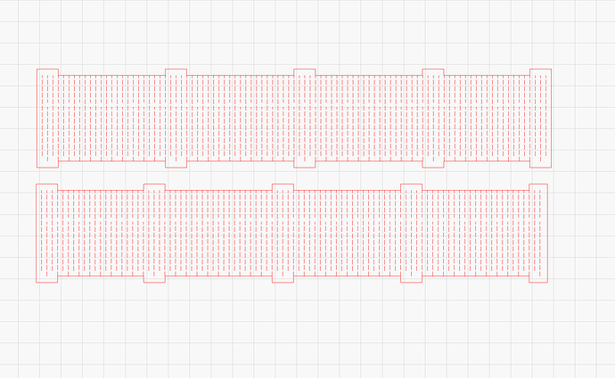

![Skærmbillede 2025-10-19 kl. 20.55.35](https://forum.lightburnsoftware.com/uploads/default/original/3X/4/e/4e17db87c884e92df3fac8a8be47af37b7070e41.png)
When I import the 1st file (SVG) there are no shapes that are not closed (besides the ones that should be).
So either I have misunderstood the task/problem or the file appears correctly here for me.
Image is with “select open shapes”

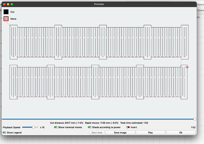

 ![Skærmbillede 2025-10-19 kl. 21.01.11](https://forum.lightburnsoftware.com/uploads/default/original/3X/0/4/047e2b5d4d0dbe59b9cde8a472aa82cbb83199c9.jpeg)
[Test-retur.lbrn2](https://forum.lightburnsoftware.com/uploads/short-url/hyg8DQGH6YY2DWv9LsMuuMmO5Aj.lbrn2) (1.4 MB)

Dang,
You have it right, for some reason my import had those spaces!
I just did the bitmap / trace option and just played around until I got it close, tested and it works fine.
No I am going to have to test this import again.
Did you drag n drop or import?
I’m using LB ver. 2.0.04
Appreciate you looking into this!!!
Thanks,
-Jim

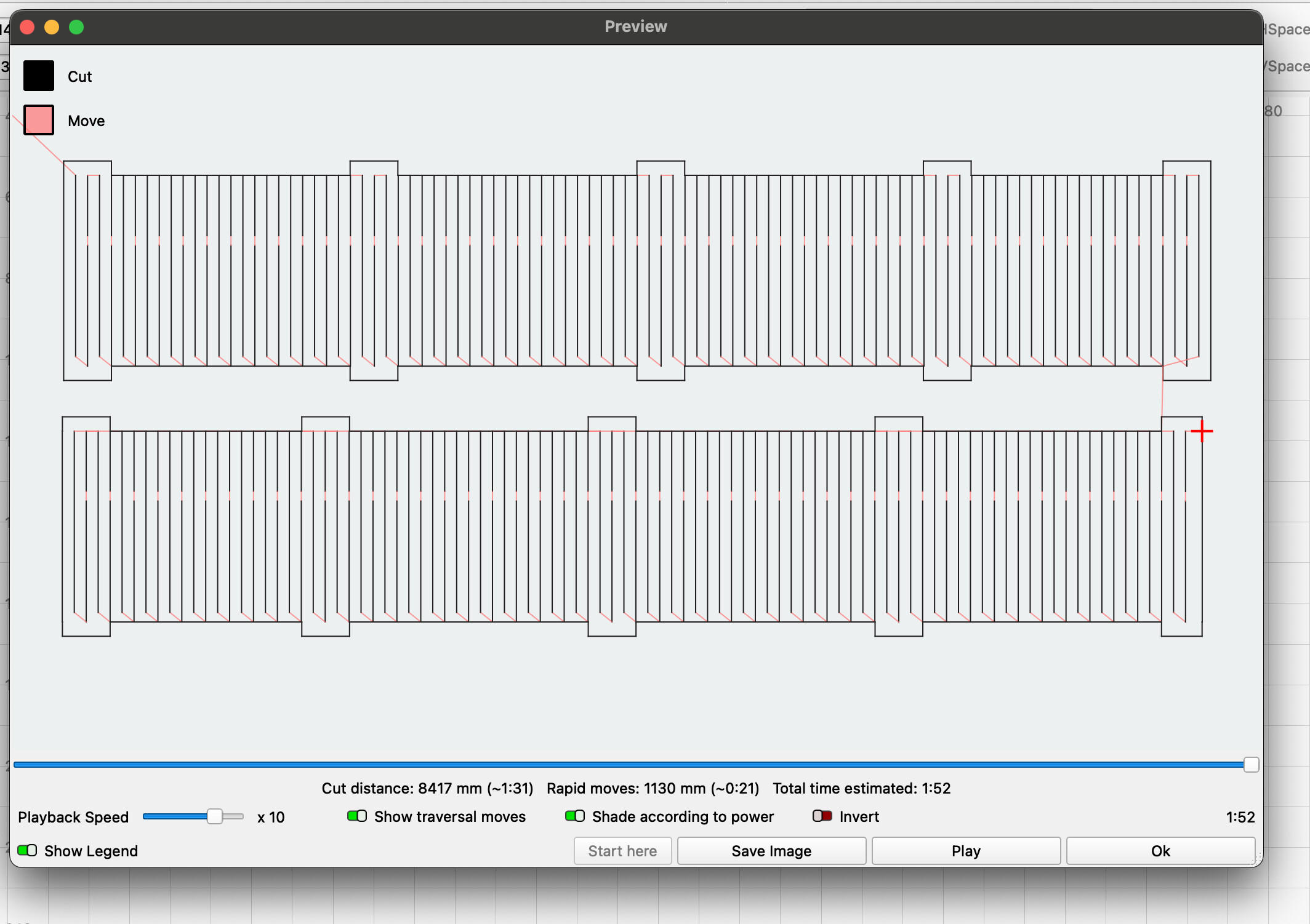

So now I am wondering why when importing the svg file it missed those couple of burning closures.
The mystery continues.
<div class="post-metadata">
**Author:** ![bernd.dk](https://forum.lightburnsoftware.com/user_avatar/forum.lightburnsoftware.com/bernd.dk/32/125208_2.png) [@bernd.dk](https://forum.lightburnsoftware.com/u/bernd.dk)\
**Post date:** [October 19, 2025, 8:23pm UTC](https://forum.lightburnsoftware.com/t/svg-picture-looks-all-joined-but-the-preview-shows-different/184008/10 "2025-10-19T20:23:29Z")
</div>
I saved your SVG on my computer and imported the same SVG into an empty project. (I didn’t use drag and drop).
It’s great if it works for you now too.
