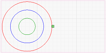

I whipped together a simple SVG to check. It has a background rectangle, three concentric circles (made the “normal” way), and “OK” stacked twice to the right (made with <def>,<symbol>, and <use>). I’ve attached three files:
Looks like that’s a no on <use>. Also, the forums apparently don’t like the SVG either, so I’ve pasted it as preformatted text with the < replaced with ( and the > replaced with ). Copy it, paste into a text editor, and replace all the parentheses with angled brackets to reconstitute it.

Thanks for trying it in the version 2 ![]()
Seems like I will have to code it in another way ![]()
