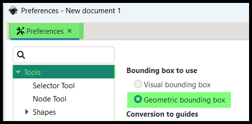

Make sure your Inkscape is set to this:
Edit>Preferences>Tools>Geometric bounding box
Thank you I will check that
