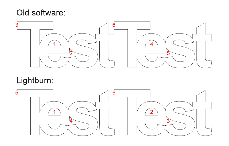

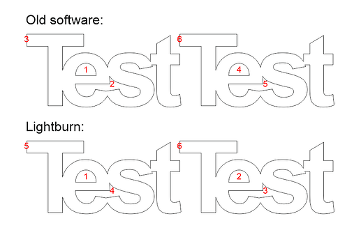

I’m having trouble setting the cut order. I have multiple shapes, and I want the laser to cut the inner parts of each shape before moving on to the next one. Everything is on the same layer. My old software did this automatically. I’ve tried changing cut order settings in LightBurn, but I can’t seem to get it right. I’m just exporing DXFs from CorelDRAW. I know making groups could solve this but i mostly export around 10 shapes and grouping things would take quite a lot time. Any tips?

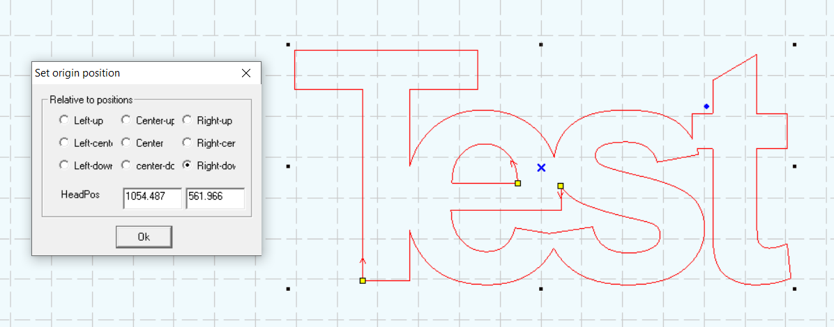

In LaserCutEngrave, I could click anywhere on the drawing to set the user origin. In LightBurn, I only see the 9-point system (top-left, center, etc.). Is there a way to freely set the origin by clicking, like I used to?

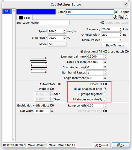

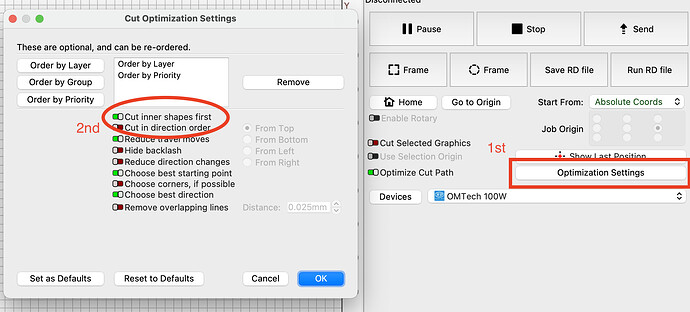

Usual handled via [optimization](https://docs.lightburnsoftware.com/legacy/OptimizationSettings) or setting it to one of these for fill use.

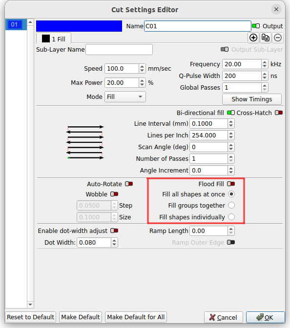

This can be set in Optomization Settings.

 ![example of the origin point](https://forum.lightburnsoftware.com/uploads/default/original/3X/1/e/1e6472a407e013bc4c209d231cc7b580edfe757b.png)
Here’s an example of the origin point I was able to set in the old software.

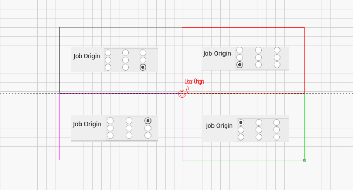

I don’t know your software, so what you say and what it does, doesn’t really make sense.
You can set a user origin, this is done by pressing _ **origin** _ on the console of a Ruida. There is no software way to set the _ **user origin** _ other than via the Ruida machine console. This seems to be inherent to the way most of the Ruida controllers work.
I’m not sure how you would use your way of doing this… There is a _ **User Origin** _ set within the controller and set via the keypad, there is also a job origin, as to where the job itself will be based. When you change any of the selections for _ **job origin** _, the green square will show that on the screen in Lightburn, black square shows machine origin.
What does putting an origin in the middle of an object do for you?
 ![user-origin](https://forum.lightburnsoftware.com/uploads/default/original/3X/8/8/88b67594c8de595b3f196ee5adfb746e132342e8.png)
Might want to go over the coordinate system and read how Lightburn implements it’s operations within the coordinate system.
> **[Coordinates & Origin - LightBurn Documentation](https://docs.lightburnsoftware.com/legacy/CoordinatesOrigin)**
> Better software for laser cutters.
This is the same document page, but covers using _ **Job Origin** _.
> **[Coordinates & Origin - LightBurn Documentation](https://docs.lightburnsoftware.com/legacy/CoordinatesOrigin#coordinates-and-job-origin)**
You really need to know the difference between the \*\*\* machine origin\*\*\* and _ **job origin** _. For example, the machines origin determines which quadrant the machine will operate within.

I read about this and I do have “Cut Inner Shapes First” enabled. It does cut the inner shapes first as expected, but instead of finishing all the cuts for one part before moving on, it jumps to another part to cut the inners there, and then goes back to the first part.

You could set the job origin anywhere on your drawing (just to clarify, I’m referring to the software origin, not the machine origin… sorry for any confusion). I used this feature to make nesting parts easier. I think LightBurn just doesn’t have an option like that. Here an screenshot of that option:
 ![image](https://forum.lightburnsoftware.com/uploads/default/original/3X/6/d/6d5589f0ff7c0ece00f77129e554728d78c1feaa.png)
Blue dot is the job origin.
This seems to be a workaround

This looks like the job origin and appears to work similarly. I can’t image a job origin marked at bottom right showing up in the upper middle right of the design… Can’t really get my head around why help that would be.
As with any software package, when you change packages, you end up re-learning how the software works.
Sorry about the Ruida only having three options, but it seems to work OK for my applications. Not knowing how your software operates makes this more difficult.
Hang in there, sing out if you have more issues.

> [@jameswild](#):
If you want to complete each part before moving to the next part place each part on a separate layer with the same cut settings. That would emulate the Old software method of cut.
