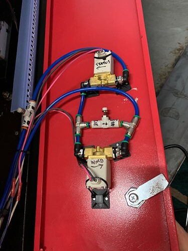

Most of us use the advanced air assist system to select air pressure. This is limited to Ruida as far as I know…
It uses the Status and Wind sinks from the Ruida. When the machine is in run mode, the Status pin sinks current. When the air assist option selected on the layer and it’s running that layer, the Wind output sinks current. You do have to configure the Ruida to enable the Wind output.
With the basic air assist, it turns on the air, via a solenoid, from the compressor. This goes through a restrictor to lower the pressure. This gives you low pressure air anytime the machine is in run mode.
When Wind becomes active, it will activate another solenoid bypassing the restrictor, giving full pressure to the head.
Here’s a pdf with a clunky drawing of it… remove the txt extension.
Ultimate air assist Mk2.pdf.txt (220.5 KB)

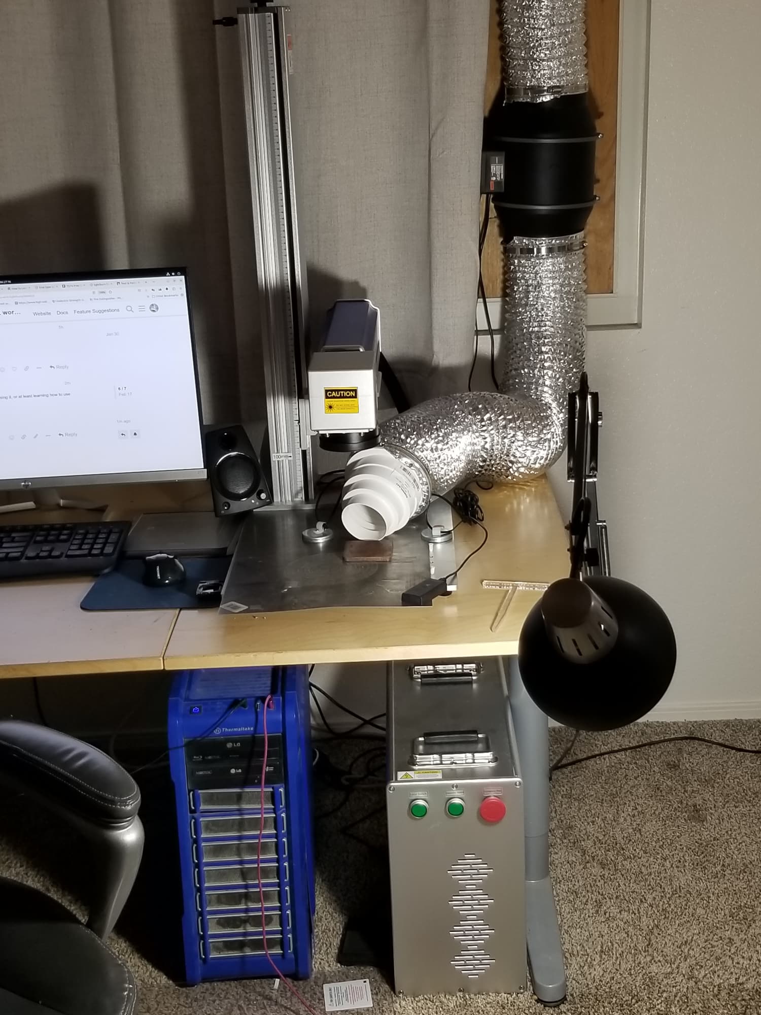

The fan in the photo moves about 350cfm… I think it’s light, but there aren’t many choices that will allow you to hear, don’t require a larger diameter and at reasonable cost that work well. It’s much better than the original…
I think you need to sit down and watch what happens to the debris flow… make decisions based on that… Nothing is perfect for all jobs.

Your pic looks pretty easy but the schematic has me wondering if I’m oversimplifying. Basically two solenoid valves instead of one, one line restricted with a flow control. This one always running when the laser is running by connecting to “STATUS” on the controller and the second running, at a higher pressure, in parallel connected to “WIND” and you have to select “air” in the layer (like I have it now).

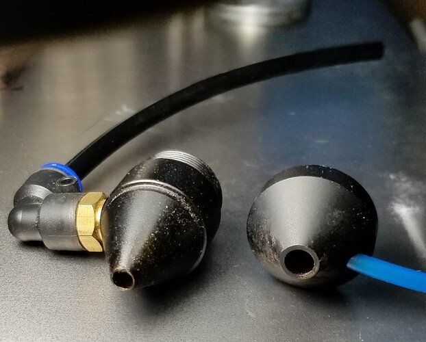

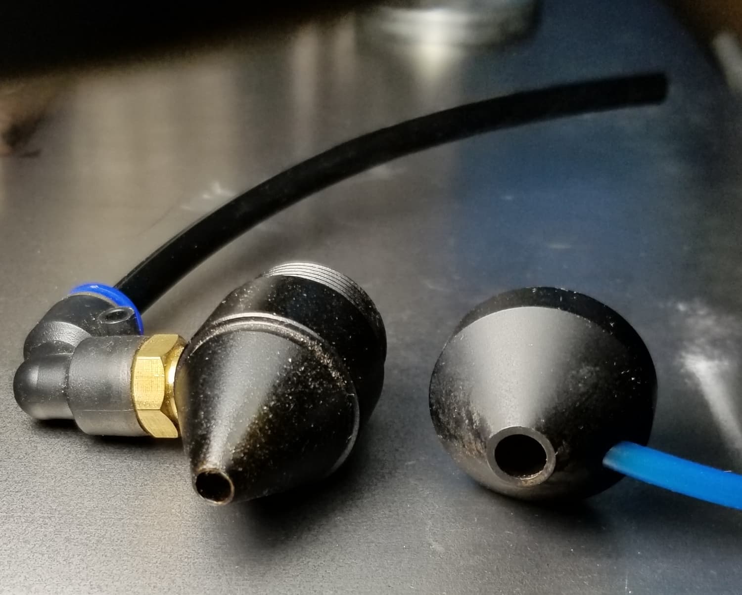

Here is a photo of the nozzles I use, the left for engraving and the right for cutting… Neither is exclusive to engraving or cutting, but the long pointed one with the small hole is going to give you more air speed than the larger hole (along with the smaller supply line)…
I don’t know anyone what knows what pressure their head is exactly. You can see the plumbing and nozzle size will determine what pressure is at the nozzle and what pressure is at the regulation point. They are probably not the same… You would need to measure it at the nozzle.
