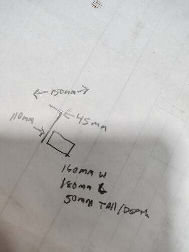

Looking at it from the side, the top piece protrudes backwards from the rest of the project. This piece will be 150mm wide by 45mm deep, with the tabs on one side only, to fit into the long piece.
The long piece is 110mm ‘tall’, 150mm wide, tabs on top and bottom of the 150mm edges. Obviously one of those edges connects to the 150mm piece described above. these 2 pieces make a ‘hanger’ for a tray that would be160mm x 180mm and 50mm deep. Ideally the 160mm side could somehow connect by tabs to the ‘hanger’? or I could glue it.

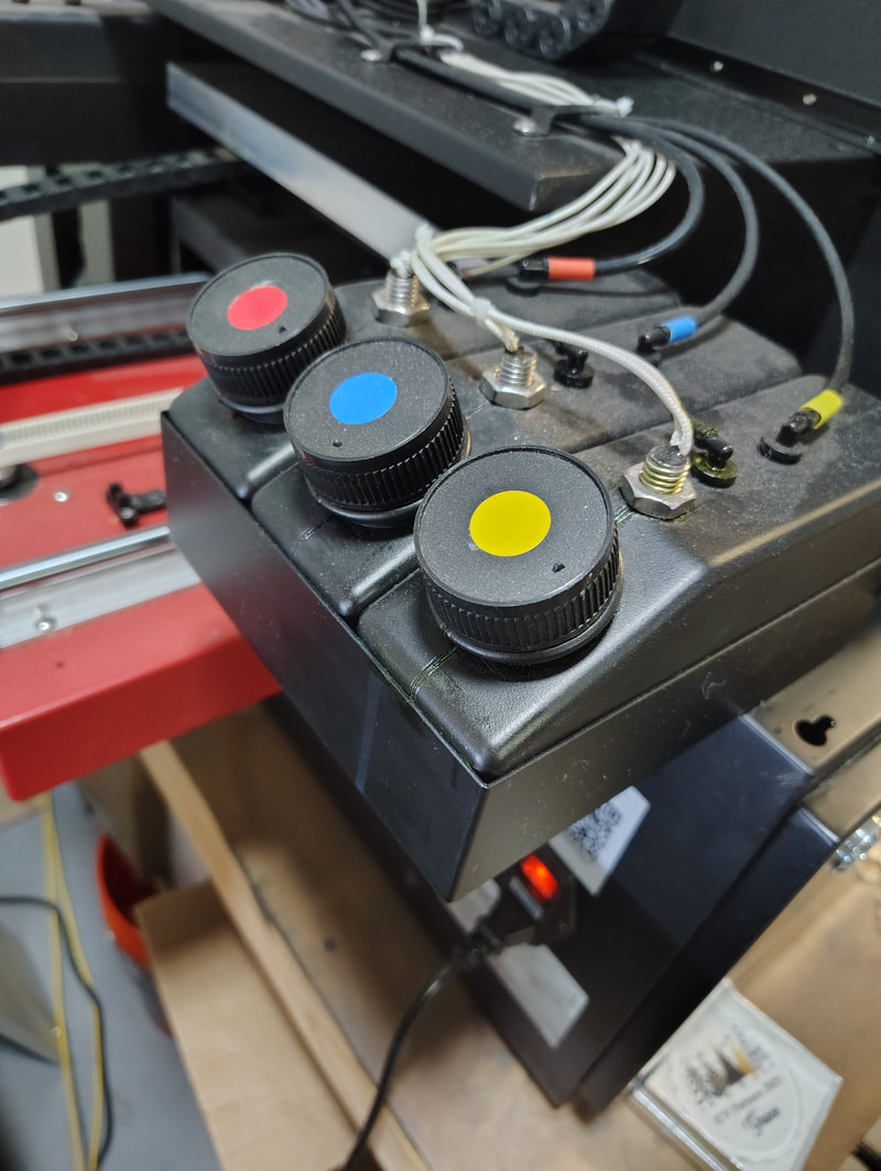

The purpose of the project is to create a bottle holder/hanger for ink bottles for UV printing. I have a ‘hot swap’ kit from the seller to change from hard to soft inks without draining the entire system, but no place to keep the bottles…

Hi Rick -

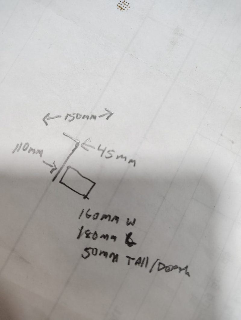

Here you go. Side view with some measurements - hopefully will help correlate to my description.

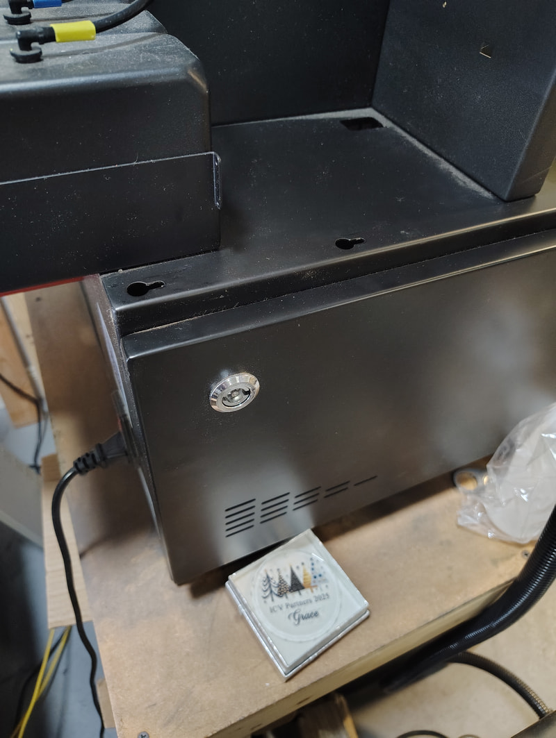

This one shows the ink containers in a tray that is a part of the printer.
and here is the side, with two holes in the top (where my 45x150mm piece will go, with ‘pins’ to hook through the holes.

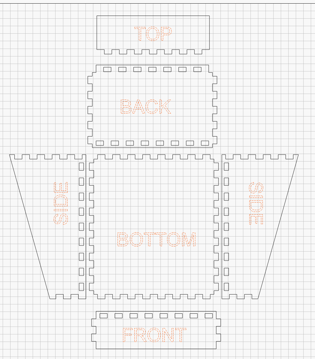

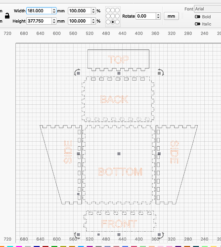

With this additional information I made a file for you. The sides angle to the back providing more tabs and with that, more glue surface as well as more torque resistance. The slots and tabs are for 6mm and you will need to adjust them for the actual measured thickenss of your material and take kerf into account. With 6mm material there should be enough strength in the glue joints, but I would add some pin nails for extra strength.
Ink Box.lbrn2 (72.3 KB)
Wow. Thank you. Did you start with boxes.py and edit from there? in any case, all but one side fits on a piece of material I have laying around here - so I’m cutting it out now!
John
No, I made it from scratch. I don’t like how boxes.py wants to add loops, making adjusting tab size impossible.

Almost perfect, by the way. My errors - assuming the box would hold as tight as the metal tray, and not measuring material first.
tabs/slots need to be for 5mm, and the tray needs to be 4mm wider. sigh.
how do I make those changes?
John

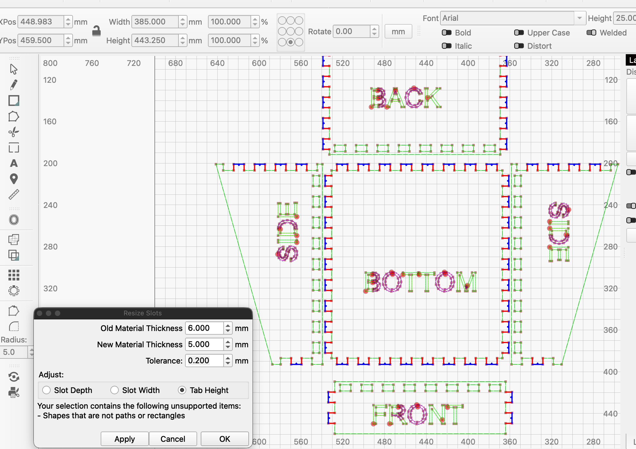

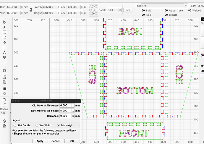

Select the front, bottom and back, but not the slots for the top. In the toolbar, make sure the aspect ratio is unlocked and in the width box add 4mm.
Now select everything and ungroup a couple times until everything is ungrouped. With everything still selected, go to Tools Menu> Resize Slots in Selection. Choose Tab Height, use these settings and click apply, then change to Slot Width and click ok.
In the pic you can see the tabs on the angled corners don’t get adjusted. This can be fixed with the node editor, but in this instance I would probably just sand the 1mm off after assembly.

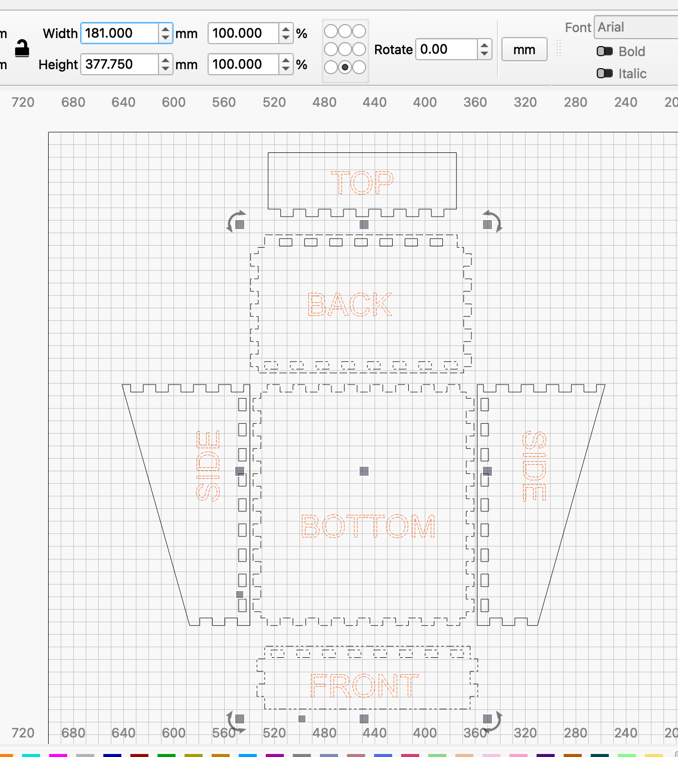

ok -
I messed something up. the bottom won’t line up with the holes in the back but the front fits fine…? The front fits on either end of the back, so I did something wrong to the back. So glad I have lots of scraps of this wood!
Also I was hoping for a slightly snugger fit. do I reduce the tolerance?

I thought that I had attached my messup file, but I see I didnt. Here it is now.
Ink Box-V2.lbrn2 (66.4 KB)
