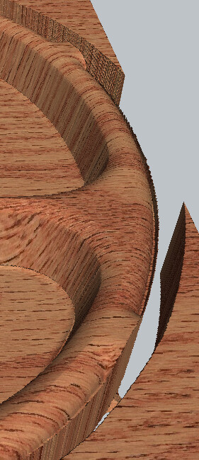

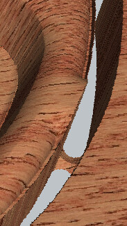

What I see happens (on more than one project) is, when you create a tab on the vector (for cutting the job out) Millmage is applying the tab to all tool paths oin that vector automatically.
Sure I go in and turn it off, problem solved, but sometimes when i open the project again the tabs will again be turned on.
I will attach images showing what the preview screen displays.

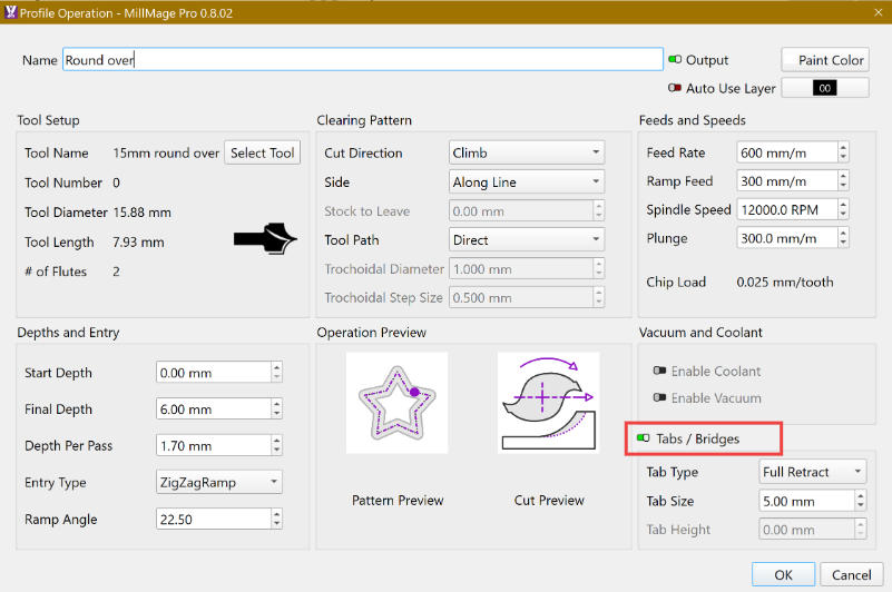

@soniclab Tab test project.mage (6.7 KB)
I created this project this afternoon to make sure i can replicate the situation.
It appears to happen when you go back and modify a tool path on the vector.
Just for clarification:
You have Tabs enabled for the first Op, is this intended?
That is the problem, they enable on their own on tool paths that i don’t want tabs on!

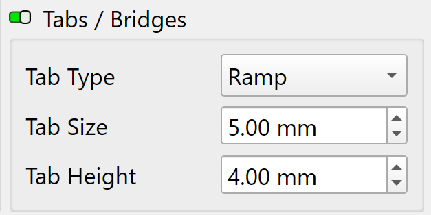

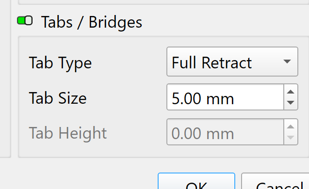

I can confirm this.
Created the Ops without Tabs.
Enabled Tabs in the 2nd Op.
Applied Tabs.
First Op:
Second Op:
I enabled Tabs in the 2nd Op even before I created them.
Are you placing Tabs manually?
Because if I use the Tabs Wizard it only applies to the Ops where they are enabled.
I too can create tool paths and apply tabs manually when i want.
The issue i am having is, when I apply another tool path to the same vector, millmage applies (turns on) tabs for the new tool path as well when i didnt request that action.
Further to that, when i modify one of the toolmpaths, it again turns on tabs for every tool path on the vector automatically.
Are suggesting i can not use MANUAL tab placement?
No! Is only to confirm the behavior (well… different).
We have to wait for the Devs to check this.
