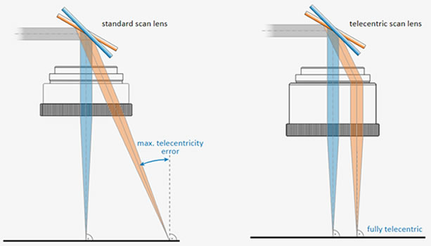

Has anyone here tried telecentric F-theta lenses on a galvo laser? I’m interested in real-world experience compared to standard F-theta lenses. Did you notice any improvements in marking quality, spot size across the field, or dimensional accuracy? And are the benefits worth the extra cost?
 ![1634613872634513](https://forum.lightburnsoftware.com/uploads/default/original/3X/5/a/5a510fd2e3e2f302a4f74103902ab21e6d236a3a.jpeg)

I’ve been looking at that and some of the information doesn’t make sense to me.
I guess I fall back on common sense on these, although I haven’t really dug down about them.
The drawing of the beam indicates the emf comes out straight down, indicating the scan area is limited to the size of the lens, which of course is unlikely.
If that were the case, I don’t really know if they fit being tagged F-theta lenses, I’ll have to think about that one.
The purpose of the F (flat focus) is better described in this article by this tutorial from ThorLabs.
> **[Thorlabs](https://www.thorlabs.com/f-theta-lenses-tutorial?tabName=F-Theta%20Tutorial)**
I’m thinking I don’t know, but have many questions also. Their diagram just doesn’t make sense to me.

Yeah, from what I’ve read, telecentric lenses tend to have a smaller scan field, and some of them look pretty bulky compared to regular F-theta lenses.
The main reason I started looking into them is precision cutting of thin copper foil and accurately marking graduations on measuring instruments. These are applications where the beam angle can really matter, whether it’s due to focus shifting across the field or geometric errors that affect dimensional accuracy.
I’m wondering whether a telecentric lens could make a noticeable difference in these applications, or whether the benefits are more theoretical than practical.
I’d also be interested in any quirks, limitations, or unexpected problems people have encountered with these lenses. There doesn’t seem to be much real-world information out there — I’ve only come across a couple of ads for them so far. If anyone has actually used one, I’d love to hear about your experience, good or bad.

That writeup was by someone selling them, so there is always bias. I also spotted this text, which makes youe question more difficult to answer…
> Telecentricity does not automatically mean lower F-theta distortion, better field flatness or a smaller focused spot.
