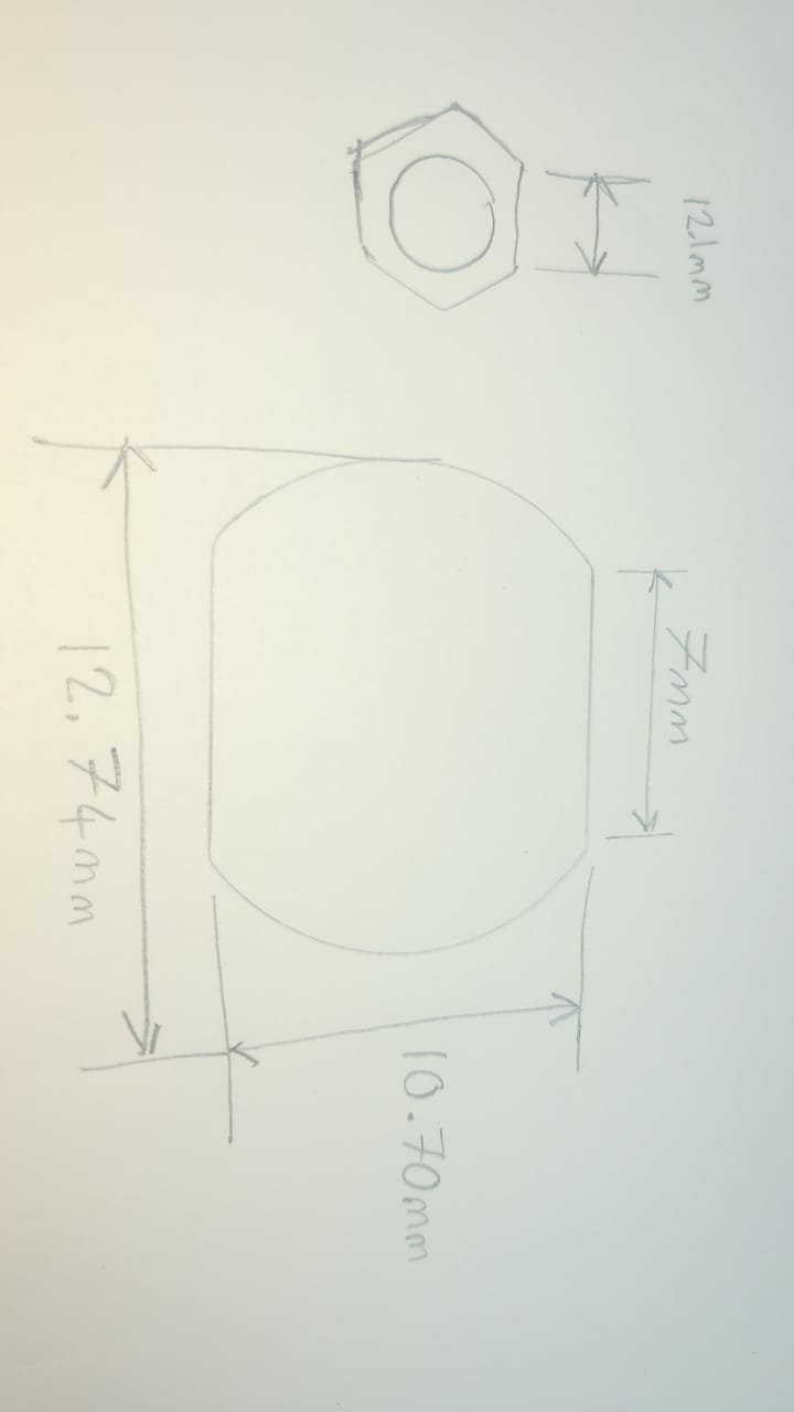

I am trying to draw a cut out for a switch it has 2 parallel sides 10.5 mm apart and the length is 12.7mm long the internal diameter of the lock nut is 12. 35mm I want to be able to cut this shape out for a control panel. I am not sure how to go about drawing it.

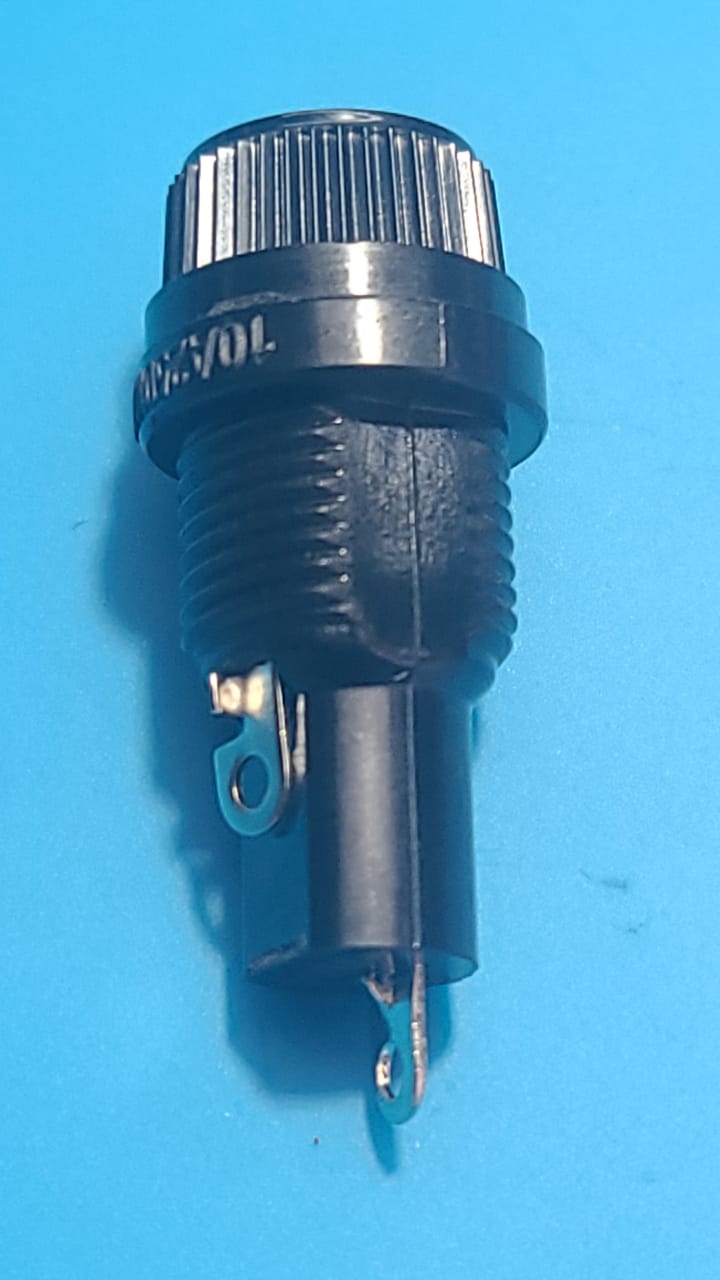

Sorry my Information was rather vague. To best describe what I am trying to do I have sent a copy of the fuse and a hand drawing. Thank you everyone who responded

The pannel thickness is 3mm. I have replyed with a ruff sketch and a pictuer

I have added a drawing and picture.

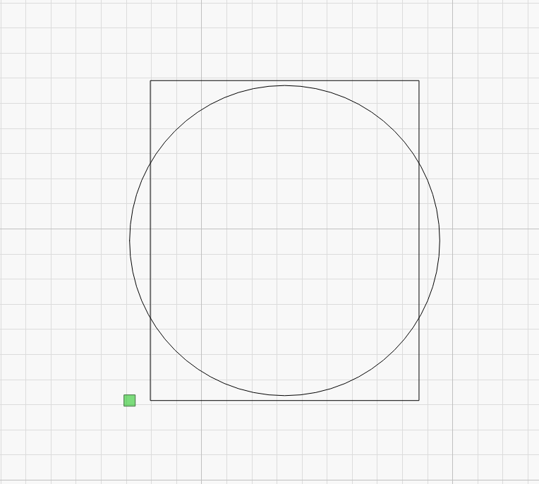

Start by drawing a rectangle and circle of the appropriate sizes and center them on each other.

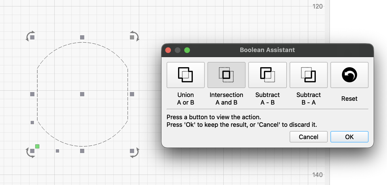

Then select both and open the boolean assistant. Select the appropriate operation, in this case intersection and click OK.
 ![Screenshot 2026-04-15 at 5.55.52 AM](https://forum.lightburnsoftware.com/uploads/default/original/3X/5/c/5c92bdcda77283c4f06b4045bf270a42b787915b.jpeg)
You may need to adjust the sizes to compensate for the kerf of your machine. Only experimentation will tell you that.

The question of thickness was solely relevant if the switch were equipped with “self-locking” tabs, but that’s not the case here.
Tim already represented what I would also do.
The drawing clarifies all my doubts!
