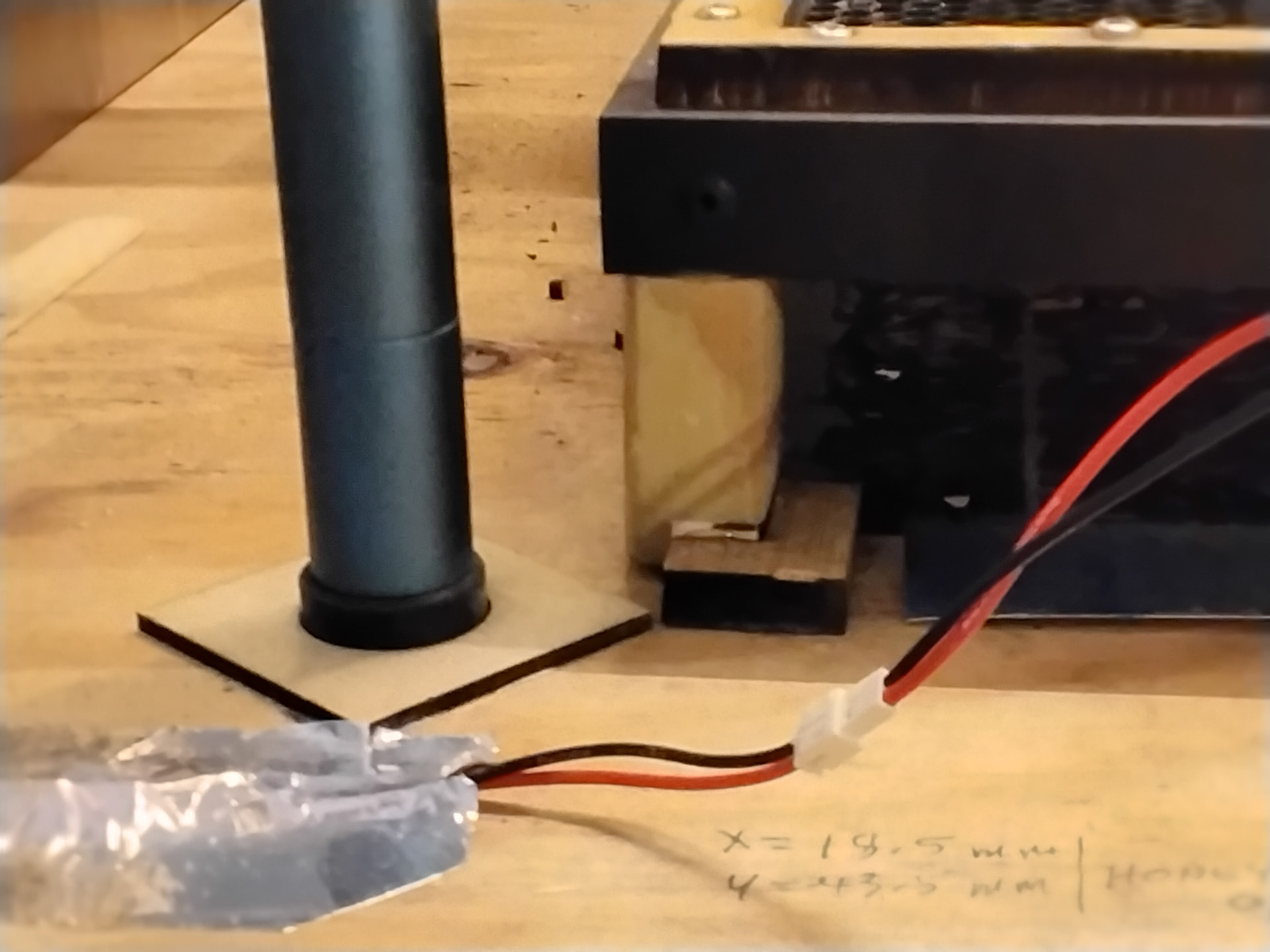

  3. Honeycomb fastened down so it cannot move. It should be raised and something to locate the feet in a given spot in case you want to remove it. (see image below) You want to home the laser, use the Fire button and [1] move the honeycomb until the lattice corner is under the beam, and [2] run the laser front to back to ensure the honeycomb is aligned with the laser.
