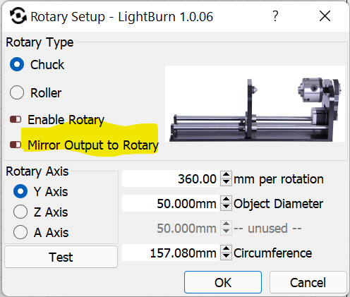

I have a NEJE Master 2 with a ORUTR rotary machine. When I preview the text and image it looks correct. But then when it comes out on the cup it is backwards. I flipped the rotary around and it came out correct. However, that is having the rotary backwards and the wires get in the way. Everything is fine when I am not using the rotary. I have it set up on the Y-axis. I am a first time user. less than 2 weeks experience.
Have you looked at enabling the Mirror Output to Rotary option?
