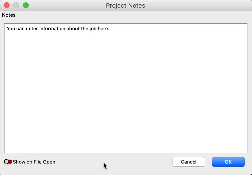

I’m making a template for engraving pencils. I am trying to write the information on the project Name, size, brand of pencil, etc. using T1 or T2 tool layers but wanted them as fill not line but those options just say tool. It’s ok on the main machine but hard to read on my tablet attached to the laser.
The Tools layers are not output, so there is no option to set the type or mode of output, such as Line or Fill.
We offer a project notation option called ‘Project Notes’, allowing you to chronicle the specifics of your job, design for exactly what you are describing. :slight_smile:

I found the project notes under show notes? Shouldn’t it be the same name? I put the info in there but it will not work as a quick visual to make sure I’m using the right template for the type of pencil. I’m not even sure it will matter maybe all pencils are the same size. I instead added another layer with the text set to fill with output off. That way i can see at a glance im using the right one.
