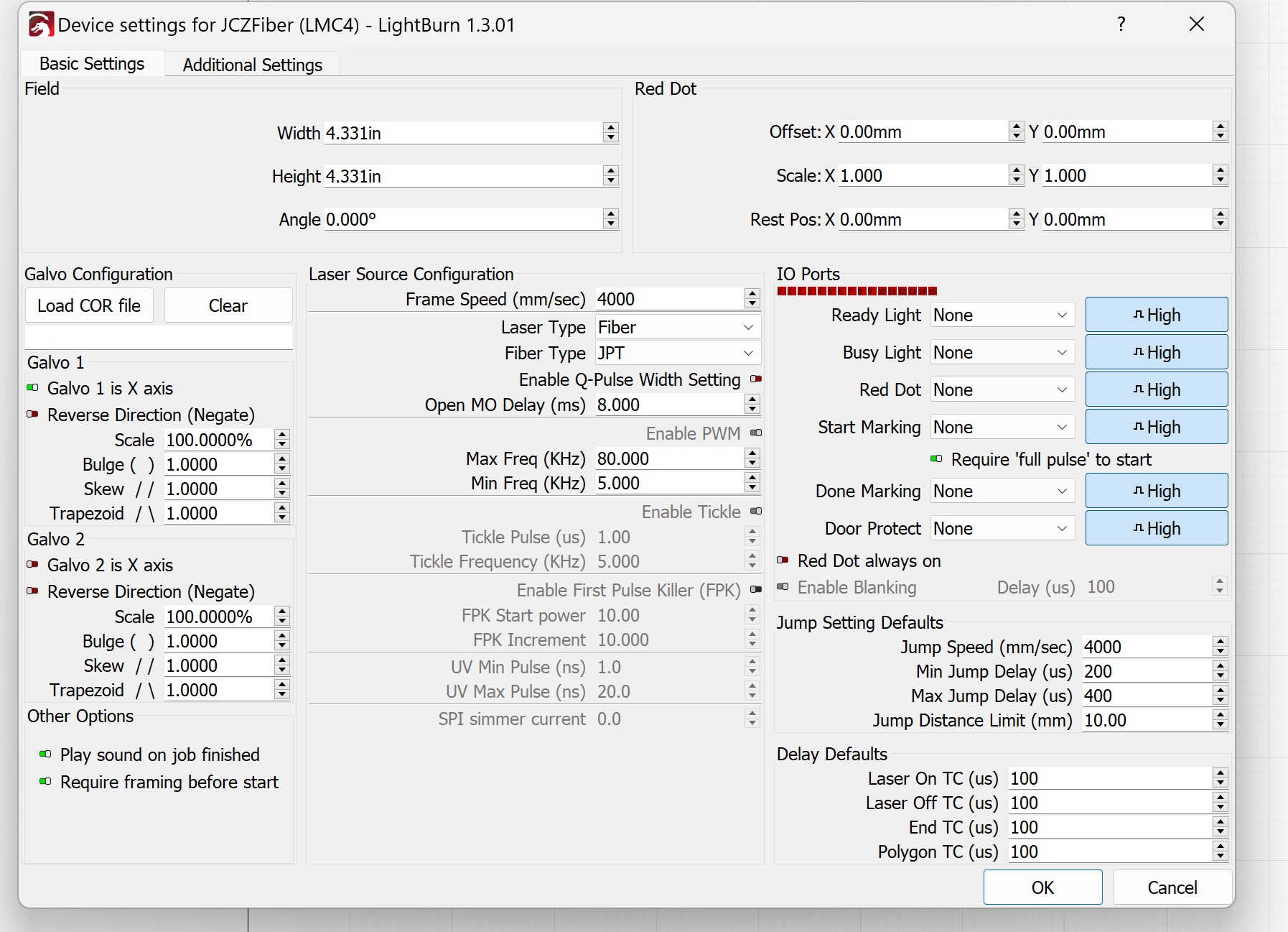

My text is printing mirrored. Research in this forum says to fix the origin in “EDIT>Device Settings” I do not see the option?
I have lightburn vers. 1.3.01 Galvo

The origin is the center… of the workspace…
It’s probably because you have one of the x/y galvos swapped or inverted.
Is this a new machine?
I’m new to these also…
On which axis (in which direction) is it mirrored? You may need to enable ‘Reverse Direction (Negate)’ for the axis it’s mirrored on.
You may also need to switch which galvo you have selected as your X axis.
I had the same issue initially. I swapped to the other galvo and sorted. I see that you are set to 100% on sizes. I think you will need to calibrate to set sizes exact.
