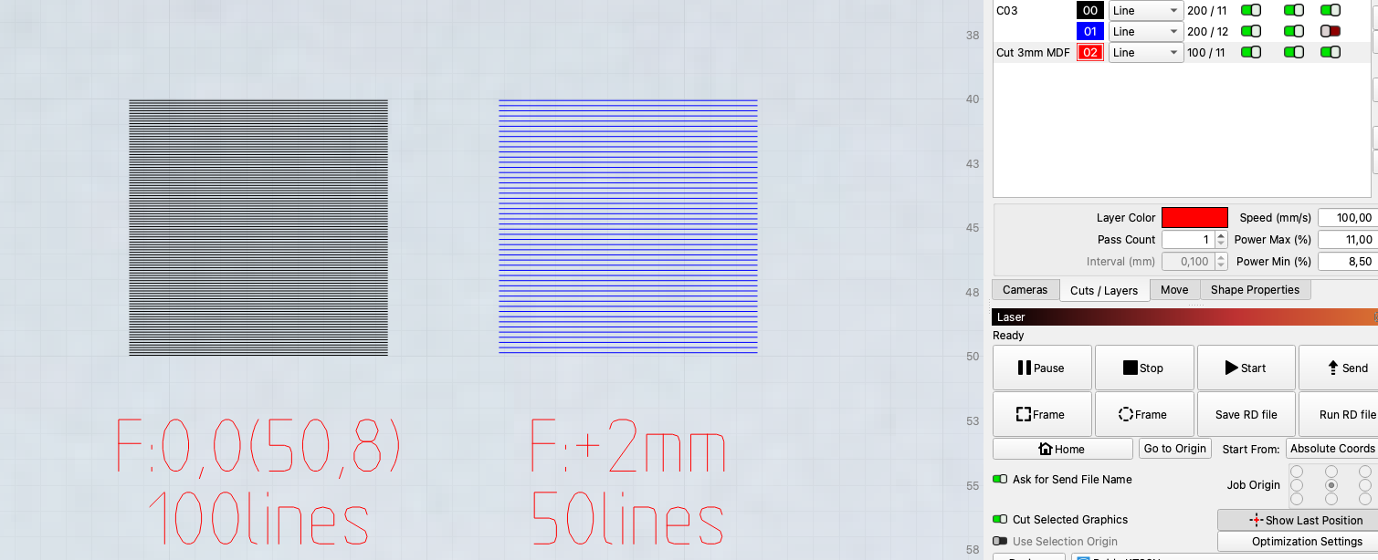

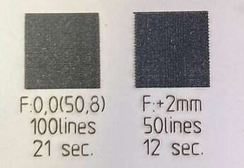

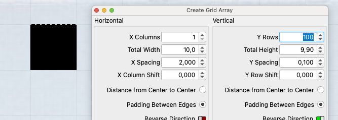

It is recommended to experiment a bit with focus distance and line spacing, it is fun and gives a lot of insight/experience.
In my example, there are 2 black boxes, consisting of 10mm lines. One box has 100 lines, the other consists of only 50 lines. But at the same time as I halve the number of lines, I have “defocused” 2mm. This gives roughly a twice as wide line or better said focus point on the material.
That is precisely what you can also see clearly in @Kuth answer.
The “effect” also brings a halving of the process time. A defocus together with e.g. cross-hatch can also be used in some cases, I use it mostly for decorative effects.
Try it a little, it can be done with all machines.
(I know that the scanning offset doesn’t fit in the picture, I used the wrong machine profile :wink: but I think the effect is very clear)

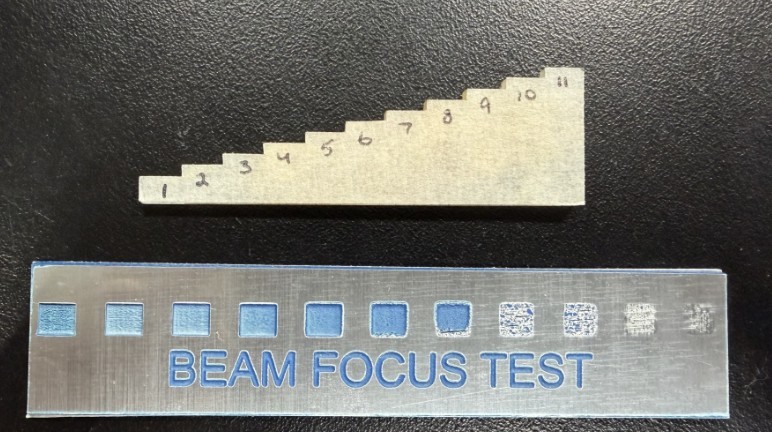

Hey there! After testing this I just had a few more questions - I would assume that based off of this test, from left to right would be negative focus to focus?
Maybe I am just over complicating things - But would it also benefit to run a material test before or after a focus test so that I know what speed/power I need to use? Or once I find my focal points would it be universal?
In my head, having this test in front of me, I would probably run a job with this at either notch 3 or 4. This being at 200spd/9.7pwr with a 0.040 interval (which Im sure I could increase with spd/pwr.)
Please let me know your thoughts - even if they have to be elementary lol
Thanks, all!
I thought 4 or 5 due to the engraved texture of the surface and how does that bright edge around the squares look to your eye in terms of quality finish?
I would def. say either 3,4 or 5 as well/ I probably wouldnt go any higher than 5.
Once you determine the best focal point, it will apply to all materials. But not to all thicknesses when cutting.
