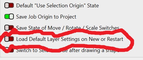

That is exactly what you can do when setting up the Defaults.
You will need something initially to have the Layers appear in the Cuts window It can be anything. Then assign your settings. Follow the instructions for saving as Defailt Settings.
Then close and reopen Lightburn. Pick a layer color and whatever you set as defaults for that layer will be applied.
I have set you up with a template file. It has all layers open. Adjust the name and settings for each layer. Then make it your Defaults. Lightburn used is the PRO version, so there should be no issues. I can’t do any more for you. Either use it or don’t.
