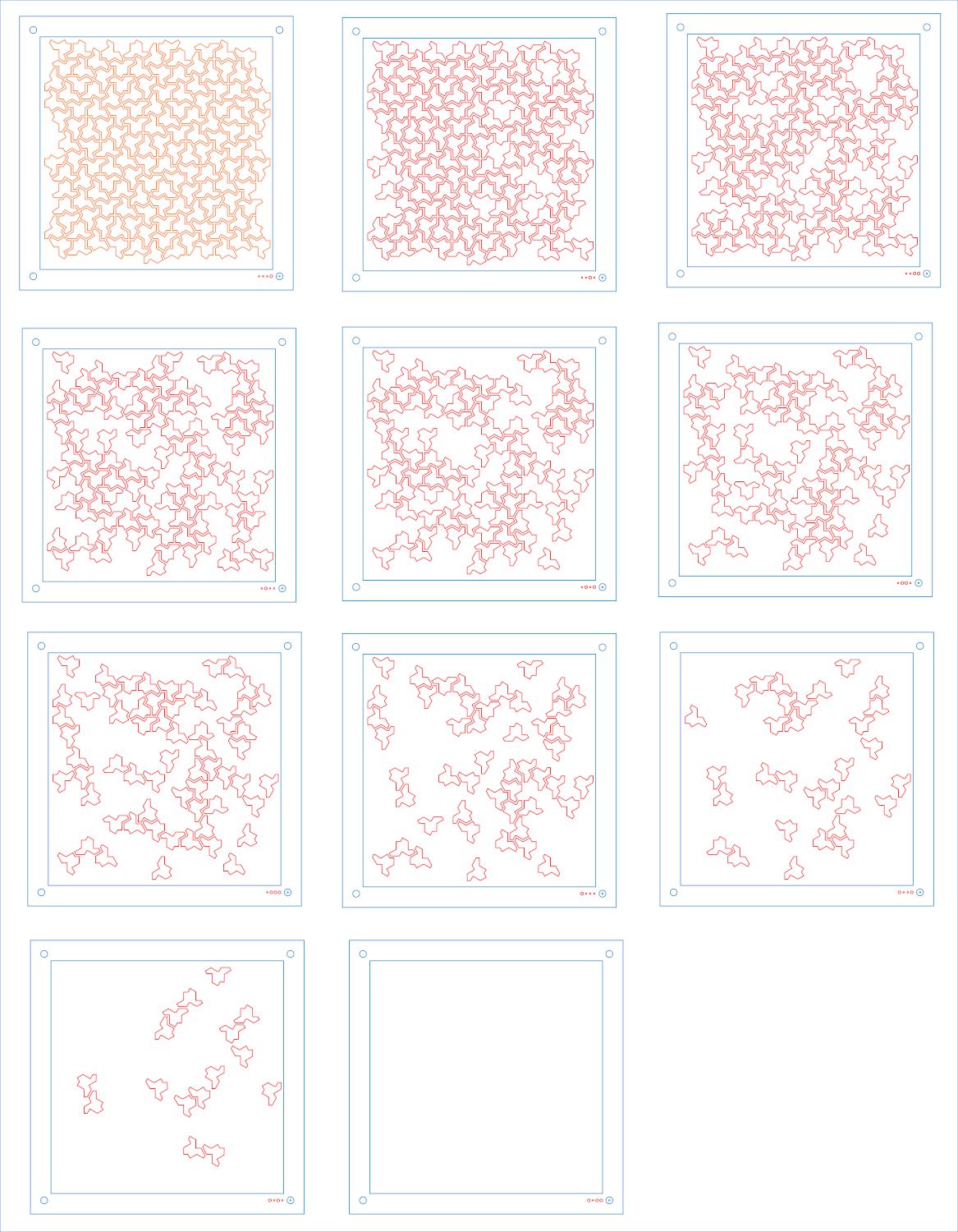

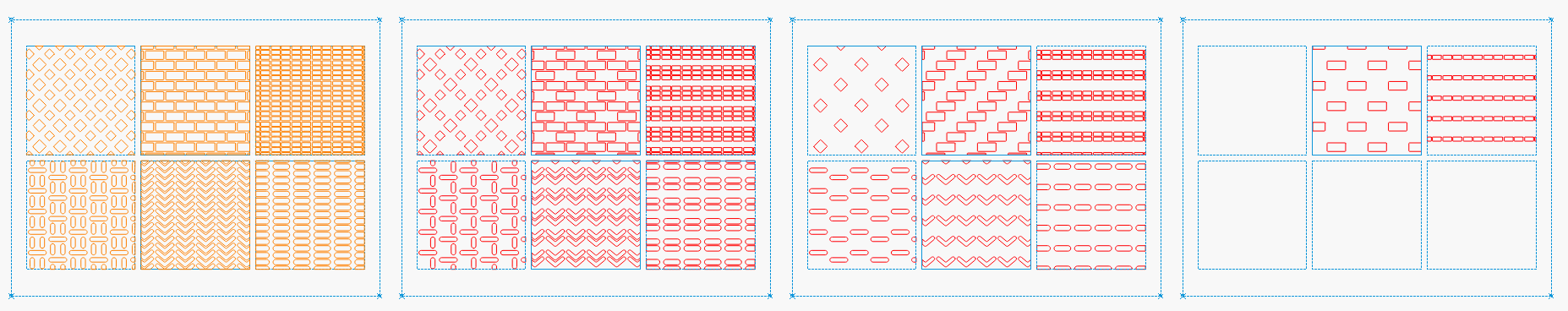

I also haven’t noticed any particular UI lag, even through RDP, for some moderately bulky layered vector projects:
Tiled einsteins:
Subpixel wall hanging:
