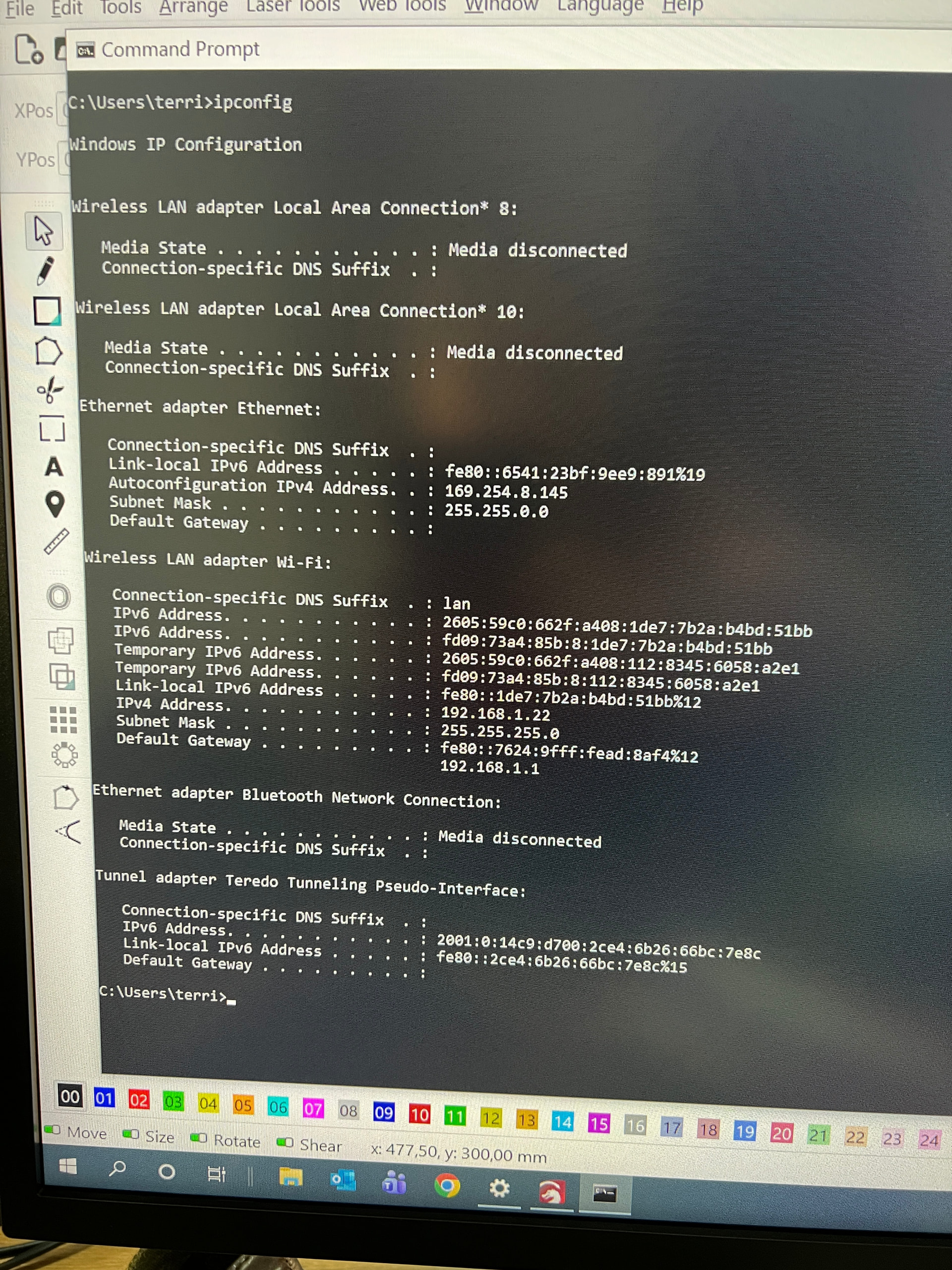

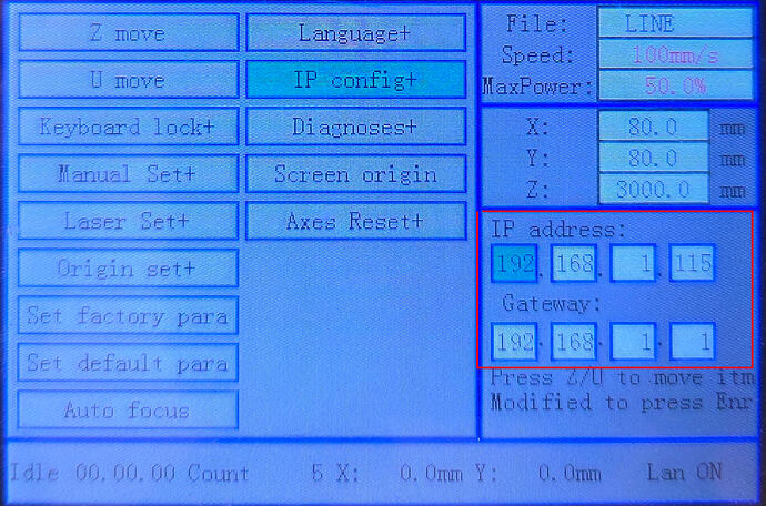

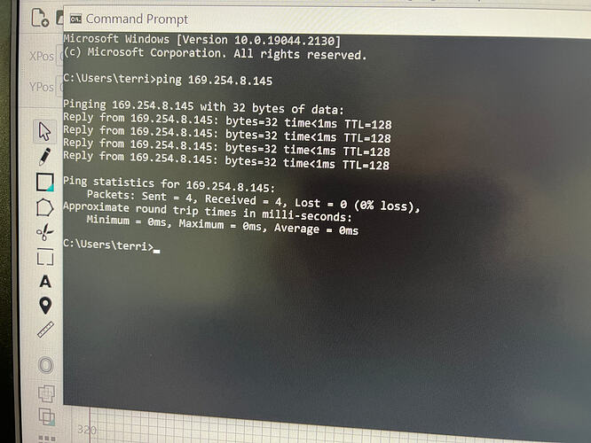

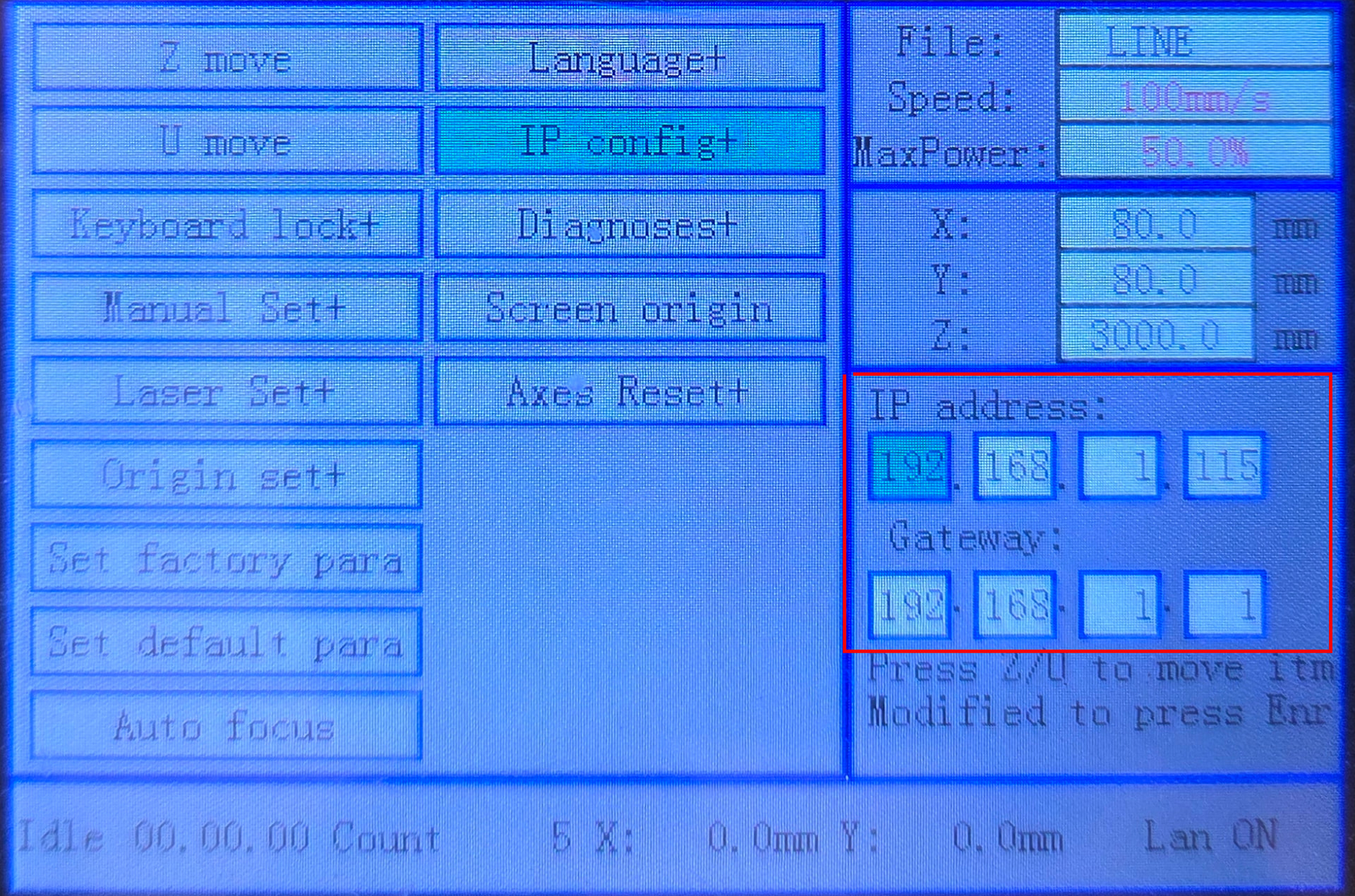

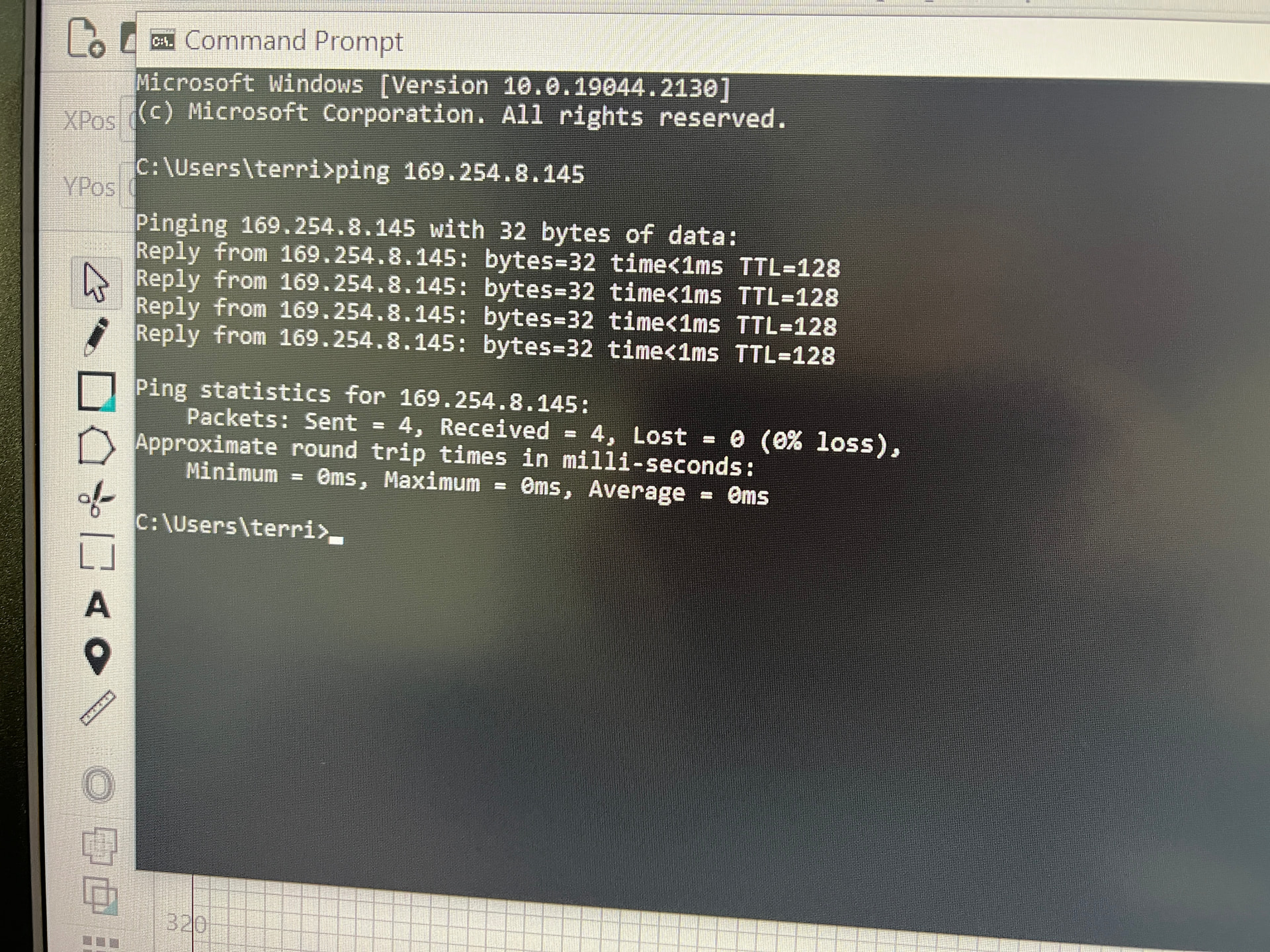

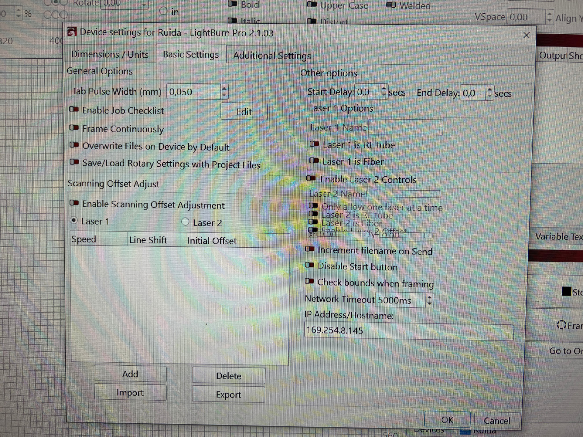

Morning. Please see attached
 ![IMG_3119](https://forum.lightburnsoftware.com/uploads/default/original/3X/f/3/f336d610990acee737e6549c16a601d5752f5180.jpeg)
 ![IMG_3125](https://forum.lightburnsoftware.com/uploads/default/original/3X/c/a/ca984b98d52de478303ed419531c982530cce02f.jpeg)
 ![IMG_3122](https://forum.lightburnsoftware.com/uploads/default/original/3X/8/7/87c31a78af311ab4d696cc7b44cb7209aac4cfd9.jpeg)
 ![IMG_3127](https://forum.lightburnsoftware.com/uploads/default/original/3X/9/2/926c9d467af63c903174280751cd8a020f32e6d9.jpeg)

> [@TerriLee](#):
> see attached
The `ipconfig` output shows the PC’s IP address is 169.254.8.14 **5**.
The Ruida controller’s display shows its IP address is 169.254.8.14 **6**.
The LightBurn `Device Settings` put the controller at 169.254.8.14 **5** , which is the PC’s address. This is incorrect: that setting should be 169.254.8.14 **6**.
The `ping 169.254.8.145` fails, because the PC is attempting to ping its own IP address. A `ping 169.254.8.146` should show the Ruida controller responding.
However, those IP addresses are in the [“link-local” = non-routable address range](https://en.wikipedia.org/wiki/Link-local_address), so the PC’s Ethernet port must have a direct cable connection to the Ruida controller’s Ethernet port. If that’s not the case, then it still won’t work.

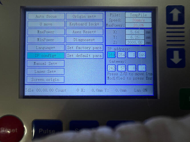

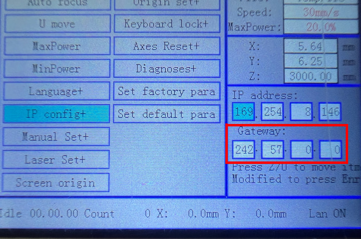

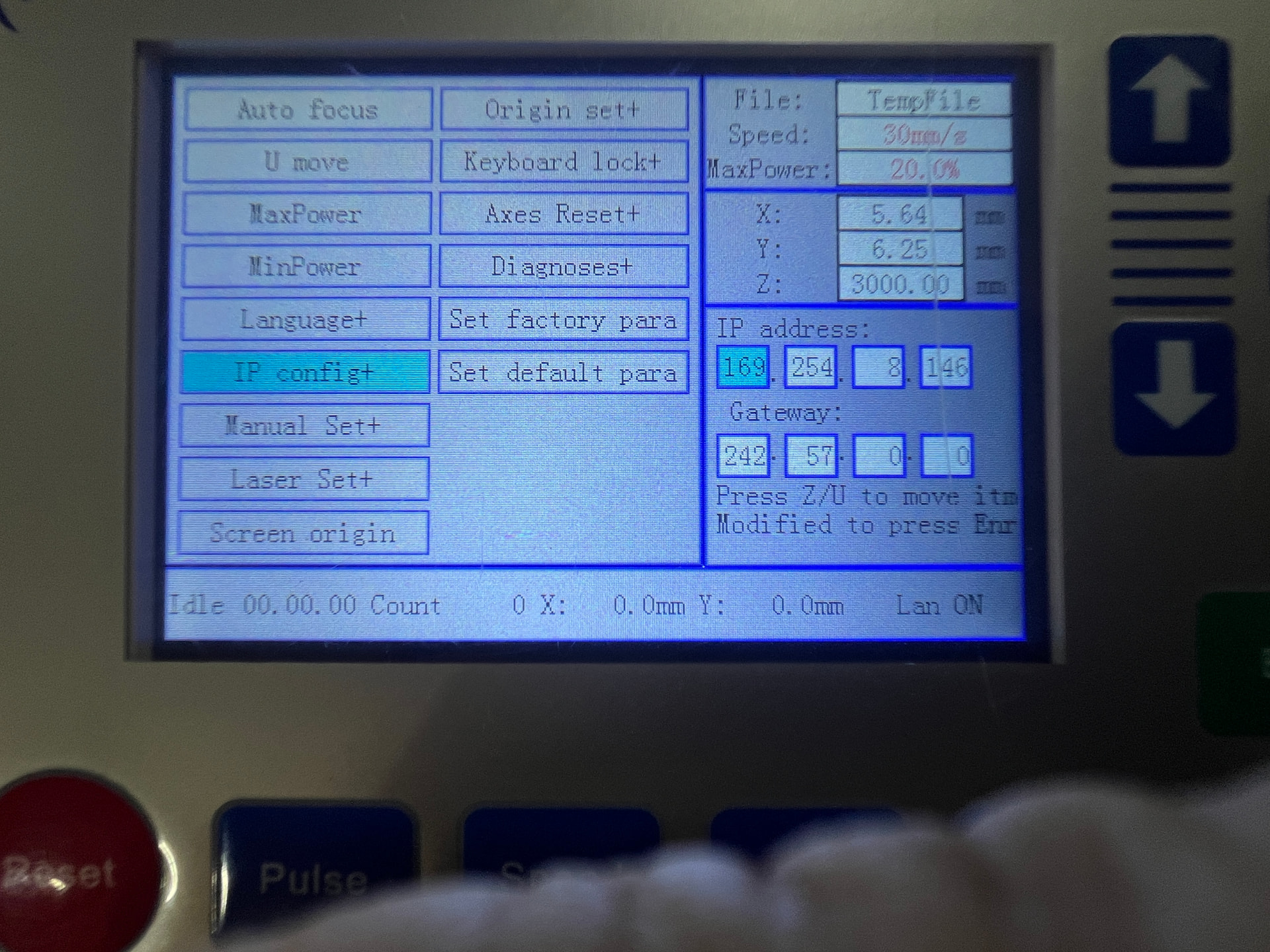

There is a lot going on under the Ethernet banner. Did you direct connect to your machine or via a router or wifi port?
The main issue I see that stands out is that it’s _ **gateway** _ is in a different _ **domain** _. As far as I know this can’t talk without a useful gateway entry.
 ![image](https://forum.lightburnsoftware.com/uploads/default/original/3X/8/6/8681704caa72af2e967ca1d87bf6283a801dd9d1.jpeg)
This is mine on a wireless lan connection.
 ![image](https://forum.lightburnsoftware.com/uploads/default/original/3X/c/a/cabc94be8d34c95a2d80d062ac086362a46dfd9a.jpeg)
 ![bridge-router](https://forum.lightburnsoftware.com/uploads/default/original/3X/c/d/cda9d515571b94bb4ec4009f71a69f2c8d861666.jpeg)

> [@jkwilborn](#):
The Gateway gets all the packets with an IP address [out of the current subnetwork](https://en.wikipedia.org/wiki/Default_gateway), so the PC and the Ruida can natter back and forth on the LAN without any problem, because those addresses don’t pass through the Gateway.
I betcha knowing the Gateway address lets the controller phone home every now and again, for reasons we’ll never know.
All the [addresses from 240.0.0.0 up to (but not including) 255.255.255.255 are reserved](https://datatracker.ietf.org/doc/html/rfc1112#section-4), so 242.57.0.0 isn’t a sensible IP address for a gateway.
On the other paw, I recently read of a mid-size company setting all their _internal_ LAN IP addresses to [US Department of Defense assigned _public_ addresses](https://en.wikipedia.org/wiki/List_of_assigned_/8_IPv4_address_blocks#List_of_/8_blocks_assigned_to_the_United_States_Department_of_Defense), with their firewalls set to _not_ forward those addresses outward. Seems like a Terrible Idea™, as the DOD has absolutely no sense of humor, but …

I would want to ditch those `169.254.x.x` automatic private addresses and manually assign new and simple static IP addresses to the laser and the ethernet adapter, for example:
In LightBurn and the Nova35: `192.168.2.200`
At the PC’s ethernet adapter:`192.168.2.100`
