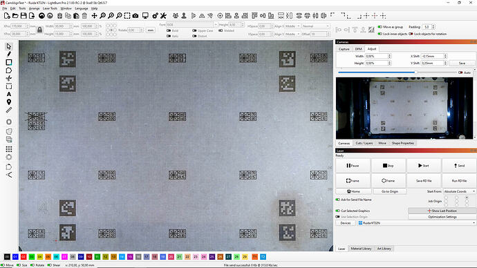

It was time for a physical camera adjustment, because I thought a perpendicular camera view/placement would be more accurate than one where I tried to center the entire visible working area of ​​my laser.
It halved the misalignment in the Y direction, which strangely didn’t have the overwhelming overall effect on accuracy. I assume that the misalignment of the lens is internally finely regulated.

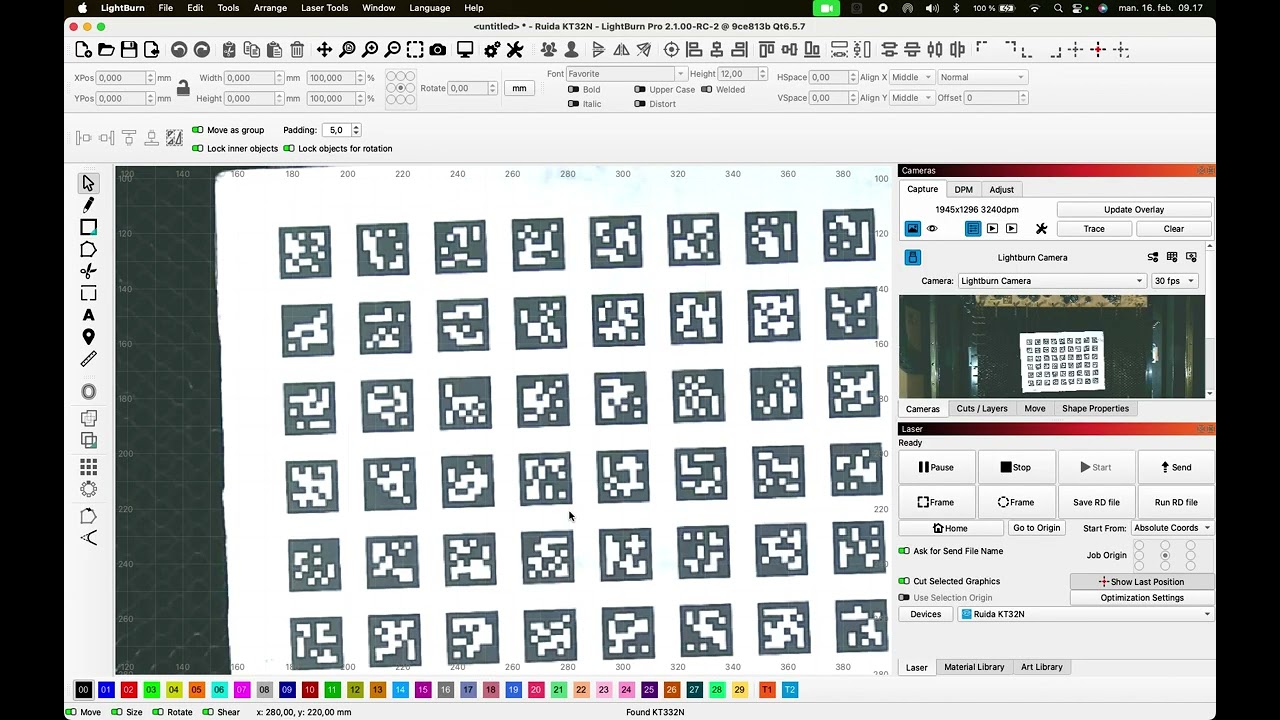

Since I have a Windows system at my disposal, which is the only OS that LB supports with image adjustment (light, exposure …) for the actual camera setup, I spent a Sunday trying to make it as precise as possible.
No matter how many times I tried, my lens calibration never got above 89%.

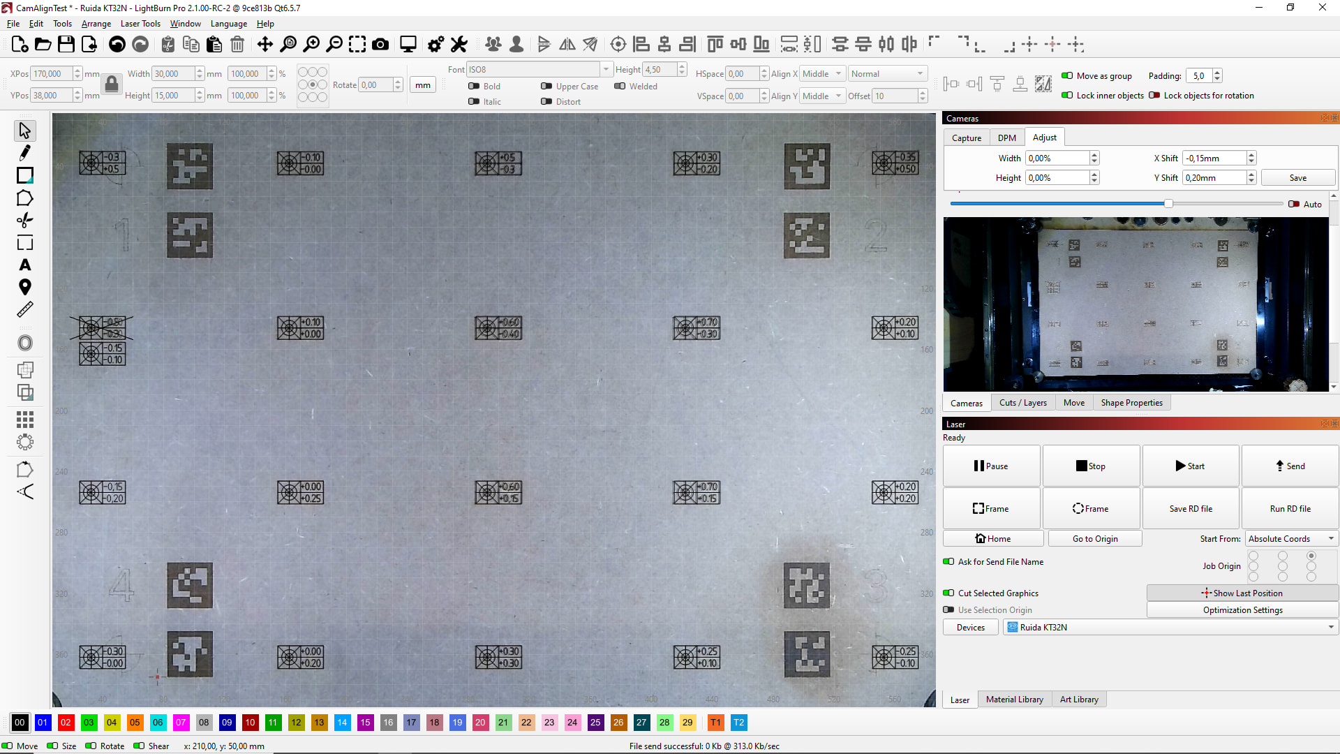

In return, April Tag camera alignment worked very well for the first time, in fact as well as the manual adjustment that I have gradually mastered. It is incredibly fast and painless. I think the lighting conditions are crucial, I used manual exposure and brightness settings.
I have made a target plate that I can use again and again, because I can reposition it 100% precisely.

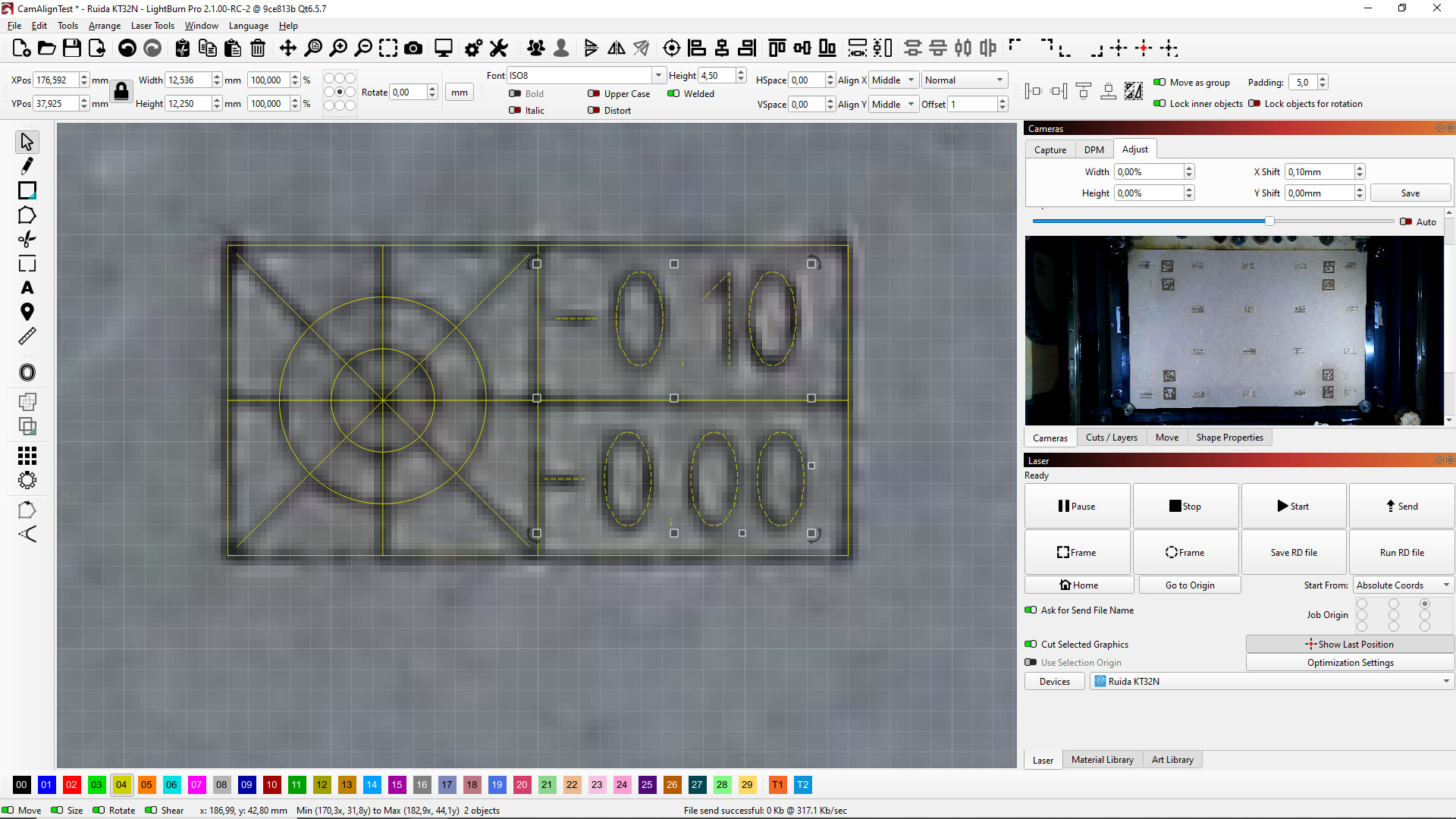

Then I did a mean deviation test, to identify good or bad areas that the camera captures.
Then a standard compromise must be found for correcting the deviation, it is in this Windows setup at X: -0.1 and at Y: +0.2mm.+ This gives me a very acceptable precision for most tasks. If I need further accuracy I can find an area on the machine bed that is extra precise.

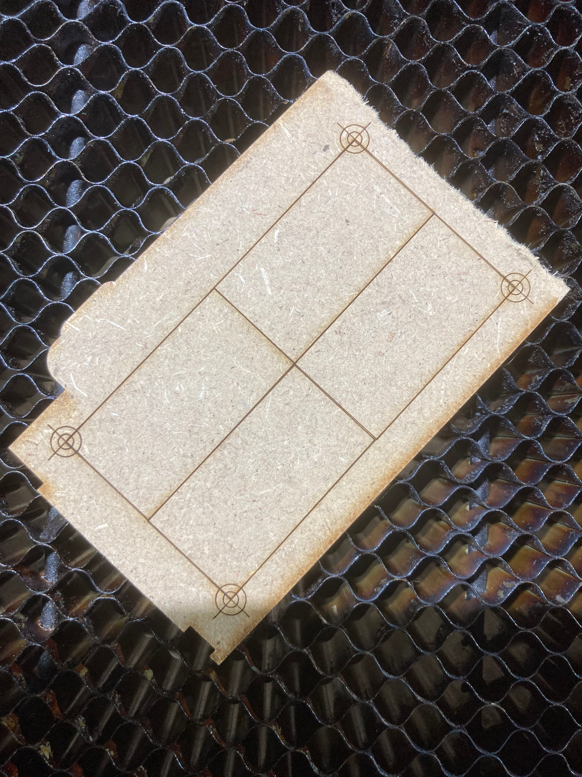

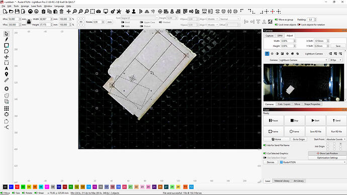

The pictures show some of the process and the last picture shows a final test.

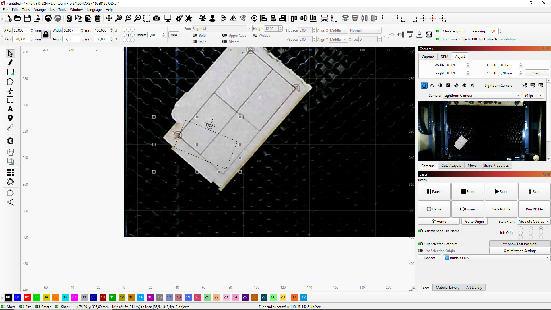

A square is filled with a smaller square and a cross target, in all 4 corners of the working area of ​​my laser. The small MDF is rotated freehand and each of the smaller squares and targets are manually placed.
I think it is a very nice result and should give inspiration to all those who do not think the camera system in LB is usable - or say it is a toy.

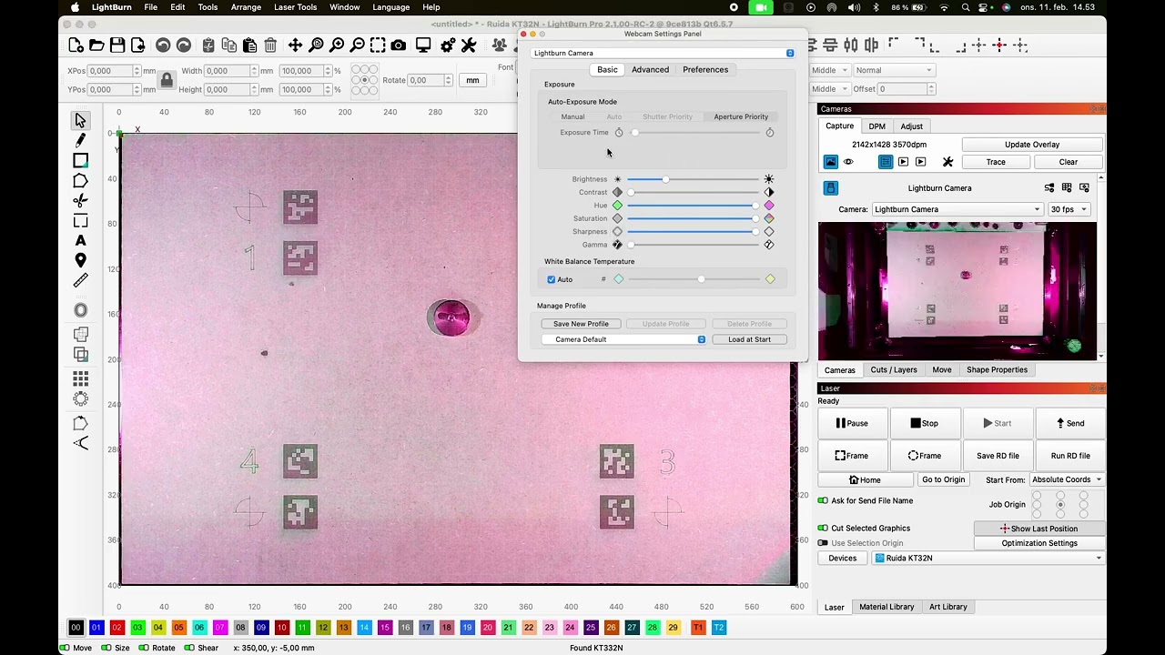

Update: I have downloaded “Webcam Settings” from the app store, costs about $8-10.
It was an attempt to end the frustrations that I have with LightBurn’s lack of ability to control LightBurn’s own camera settings under Mac OS.
“Webcam Settings” works very well and provides ample setting/adjustment options for the camera itself, including exposure…
Conclusion: There is an external solution for LightBurn’s not handling their own camera settings under MacOS, which costs $10. - and it works!

I have bought this app to test, and on my end it does not allow editing of hardware settings such as exposure. Only ‘post’ edits such as brightness, contrast, hue, etc. It is essentially applying filters to the feed (a lossy process that reduces image quality), not actually changing the settings of the camera hardware and giving me a better image.
If I switch to manual exposure and move the slider, the camera feed exposure does not change.
Can you show some video of you changing the exposure and the effect it has on the camera feed?
and let me know what camera you have?
Hi Billie,
I have downloaded and installed the app on both my Macbook pro and I can assure you that it works, it works exceptionally well.
However, I have chosen manual exposure because the automatic is not fast/efficient enough to react to extremes. Like for example from a light MDF board to a small piece of wood on the honeycomb.
Manually I can perfectly compensate for these extremes.
What does not work is the sharpness adjustment, which is logical with a manual sharpness setting on the camera lens itself.
If you open the app and adjust the parameters, you will be able to see the “live” effect in the right window from the camera settings, the main screen itself must be updated every time something is changed.
In the “Webcam Settings” itself there is the option to determine the read and write intervals to and from the camera you may need to activate them too.
Remember to start the “Webcam Settings” app - before LightBurn!!!

Here is the video, with and without “Webcam Settings app”
I downloaded the paid app from Apple’s webstore and installed it normally on my 2 Macbook Pro.
It is important that “Webcam Settings” is started before LightBurn.
Also note that the settings for LightBurn’s camera that are selected with the “Webcam Settings app” remain persistent in the camera.
I am still in the process of creating some profiles that make it very easy to adapt the camera to different conditions.
