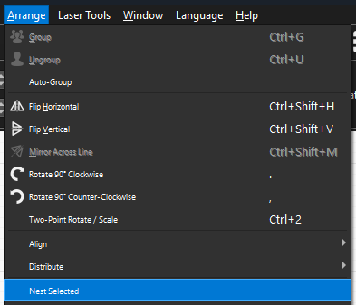

hello,
How do you mark in Lightburn so that it automatically arranges for you so that you have as little waste as possible?

Using bounding boxes:
A closer fit using an online tool, with transfers set up by LightBurn:
Neither of those may be Good Enough for your purposes, particularly for large parts that must tightly fit in a relatively small chunk of material.
If you have a bunch of identical small parts, tinkering with the Grid Array tool may produce a nearly optimal packing.
I find a camera is invaluable for manually arranging a fewe random parts on a small piece of material left over from previous cutting sessions, but that requires careful calibration.
LightBurn now has Quick Nest for Pro licenses, currently accessable in the Release Candidate of LightBurn 2.1: LightBurn 2.1.00 Release Candidate – LightBurn Software
Otherwise, you can use Arrange > Nest Selected to bring your work to SVGNest, or use the Docking tools manually
