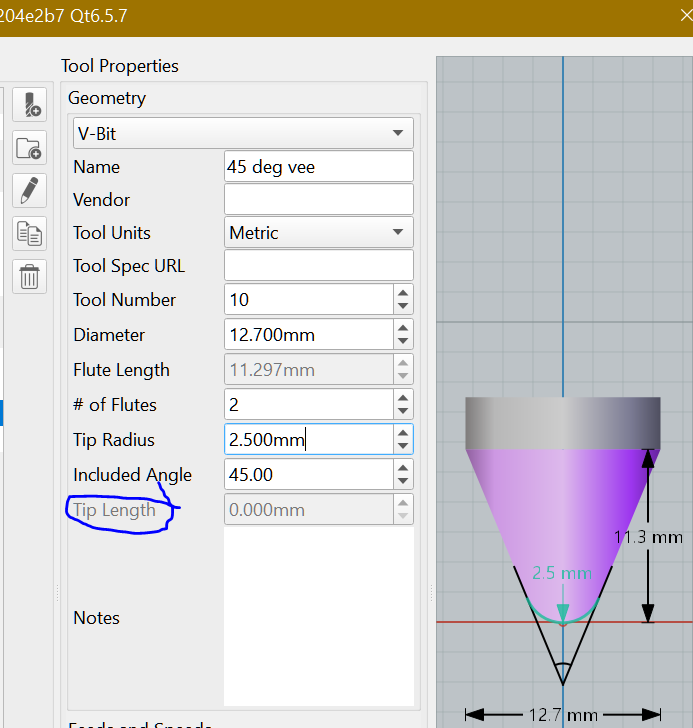

I’m not seeing any way to add these type of bits properly. V-Bit and Scribe don’t allow flat tips and End Mills do not allow angles. I’m not seeing how to enter large surfacing bits either?

Flat-Tip V-Bit, example: This is a screen grab from another software I have a license for. It calls these type bits Conical-Flat

If we can set/force Tip Length to 0:

I’m in the process of adding support for flat-tip V bits.
a large area surfacing mill is just an end mill as far as MillMage is concerned.
