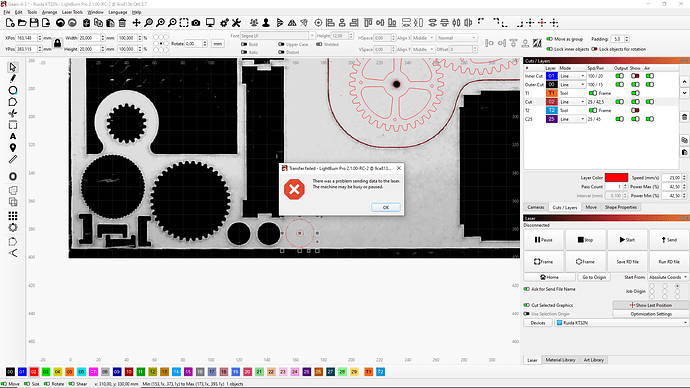

Transfer Problems LightBurn to KT332N
I also got it under Windos OS today…
If I was the only one with the error I would have bought another controller… but I’m not.
I hope there will be a review of the problem from the LB site.
It’s very hard for us to diagnose disconnections like this. The best thing would be for you to clear, then restart a debug log as per this guide: Enable Debug Log - LightBurn Documentation
And try to capture the issue. Immediately stop the debug log then email it to us once you capture it.
Thanks for the feedback, I’ll try to see if I can “catch” the transfer problem in a debug log.
Hi Colin, I have sent a log file with the symptom to your LB support address.
