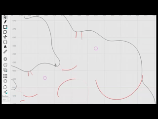

After using ‘fit shapes to arcs’ The trim tool has odd behaviour in Millmage but works okay in Lightburn?
MillMage Core 0.8.00-RC-19 @ de27901 Qt6.5.7
![Trim tool Millmage](https://forum.lightburnsoftware.com/uploads/default/original/3X/a/1/a1aca2f9b92ae83bfb6f01aaa6c878f97615145f.gif)
![Trim tool Lightburn](https://forum.lightburnsoftware.com/uploads/default/original/3X/e/6/e6e7d5c4f6cfd8a344aedd646187098729acf7e7.gif)

These files are imported as \*.dfx, after some testing I have found that if I import them as \*.svg then (In my particular case) this odd behaviour does not occur anymore.\*
Bearing in mind that this does not happen when working in Lightburn.
If it helps….the bottom gif is after importing the paths into\* Millmage as \*.dfx but leaving the nodes unchanged, allowing for the red lines outside the black shape to be trimmed
The top gif is after importing the paths into Millmage as \*.dfx but then applying ‘fit shapes to arcs’ to the black outline….after this the trim tool selects the whole red line and misses the intersection.

We’d need the file, just before you clicked the Trim tool, to be able to reproduce it internally and figure out what’s wrong.

The math in that code is _really_ picky. 🙂 So if you see it again, hit undo, save, then make a copy of that project file to send along with a description of how to repro it and a link to this post. In general, it’s a sub-micron off somewhere in the math, causing it to miss things that look obvious.
