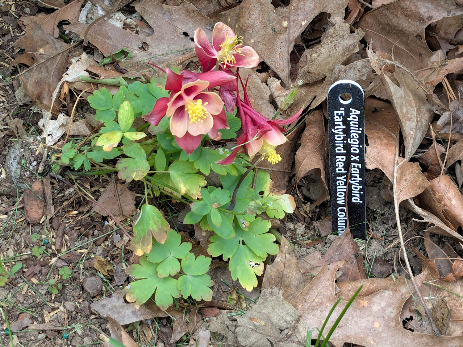

With the beam alignment & cleanliness checked and the scanning offsets lined up, compare these with your settings:
Trolase light engrave
  • 400 mm/s
  • 15% → 10-ish W
  • Bidirectional
  • 0.1 mm Line Interval
For example, our plant tags came out looking just fine with minimal cleanup:
