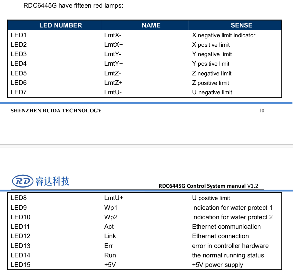

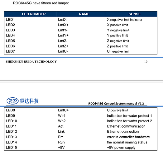

I’m trying to get a friends machine to work properly. My machine and his are identical–Lightburn DSP, Ruida 6445 controller. The Z-table goes up and down, but the limit switches at the top and bottom will not work. When the limit switches are tripped manually, the correct lights on the controller cpu flash correctly, but they will not stop the travel of the Z-table.

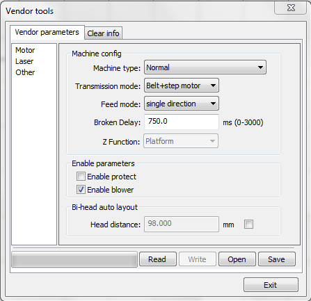

RDC6445 controllers have a U axis in addition the the Z axis and apparently requires internal configuration to select which functions apply to which axis.
Not having a 6445, I think that configuration isn’t visible to LightBurn, so you must use RDWorks:
Neither the 6445 nor the RDWorks V8 manual provide any details or much explanation. For example, the 6445 manual mentions a D-Axis used for what seems like either the Z or U axis, so it’s an Easter Egg hunt.

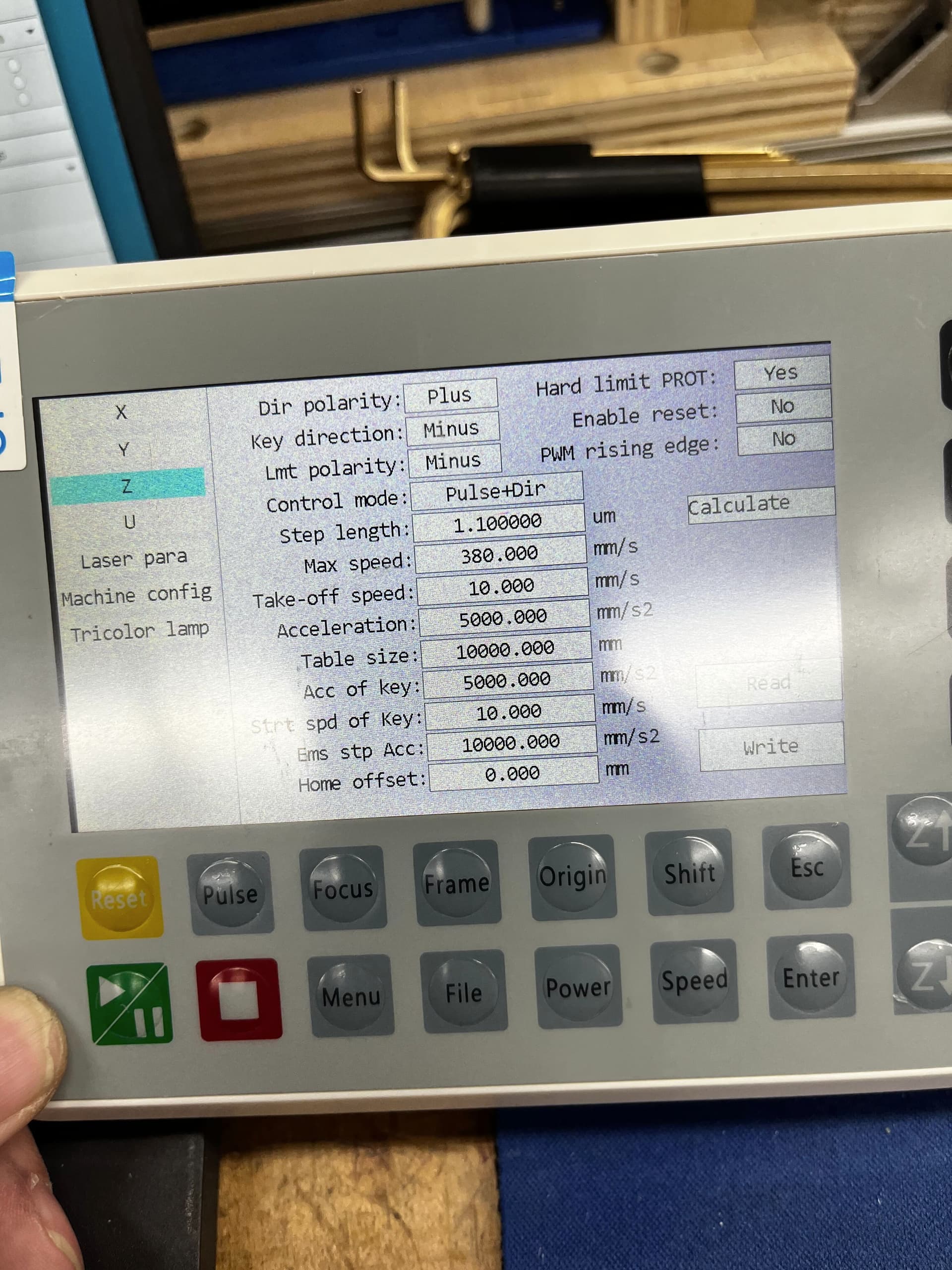

Thank you all for your help. I finally found the answer in one of the settings on the Ruida 6445 “Menu”. Go to Menu>Vendor Settings>enter password RD8888>Navigate down to the Z choice>change the “Hard Limit Prot” to yes>Hit “write”>and the Z limits work.
