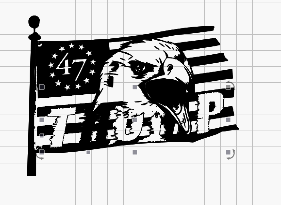

Not new to lasers, just new to Lightburn. How do I get the attached file to engrave the flag and just outline the letters. I want the letters the same as the original wood height. I node edited and pulled the letters down to separate and put on another layer. That didn’t work so I tried some different offsets around them still no good. What do I need to do to engrave around the letters?

I worked on it for a few minutes. This is not a good file to get the results you want without a lot of work. The answer to how you get the results you want is place the letters as a single line on the black layer, but your tracing is not very good. Not your fualt, it’s not a good oimage to trace for the purpose you want.
Thank You. I’ll give that a try.
