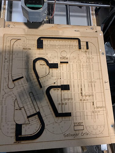

Doing a complicated project (Crib Wars). The design was done in Cut2d, carving was tried on a 3018 Pro. The design consists of 7 layers. 2 layers are carved and 5 layers are lasered. 7 different files. All the layers were designed as one project. Using the lower-left corner as my homing location and the center of the design as the origin. The file was exported as an SVG file so that it would be compatible with Lightburn. I opened the file in Lightburn and created 7 layers. I set it to laser all 7 layers. ( yes, I know 2 are meant to be carved, but I wanted to see if everything would line up properly). Lightburn proceeded and worked perfectly for the first 5 layers. Everything lined up perfectly. However, The last two, not so much. The last two are the holes (all 1067 of them) and the lines. the holes were aprox 10 mm to low as were the lines. What I discovered was that my XY Datum in Cut2d was at X150 and Y155; whereas in Lightburn it was X165 and Y183. How and why that is possible is beyond me. Also, why did the first 5 layers come out perfect and not the last two? Any input would be appreciated as I’m at wit’s end here. Thanks in advance. If the picture loads, this is the crib board that I’m talking about.

My issue is that not all 7 layers are aligned with each other. One would think that they should be, being that same origin position is used for all 7! The attached picture is what I first carve looked like. This is before I decided to do some laser work.

The last good burn was the dark patches. (these are penalty lanes). The next 3 didn’t line up. That is all the holes; the markers ( larger rings around the holes) and the lines.
Was this all run as a single job? Or you manually ran each layer one at a time?
I’ll bet the origin slipped during all that movement. You could test fire on a piece of tape then run the pattern without cutting then recheck origin.
One at a time. The first laser was the Pockets. That was perfect, but of course you have nothing to compare it to, because it was the first. Next was the advance lines. They were perfect. That’s when I let the machine do its thing. When I came back, the last three burns were all screwed up. I’m wondering whether the machine lost some steps somewhere? But, I have it running real slow, and this is a laser, it shouldn’t be losing steps!

Just ran a quick test with the laser just doing the holes on a piece of thick paper. Ran it at 800 mm/min. About 15 mins in, I heard it lose steps. Stopped it immediately and reduced the speed to 500 mm/min. Ran it again and it so far is running perfect.
Awesome. Nice that you caught it in the act. Would be good if that’s all it was.
Just finished running the file. Still problems with the origin. The first three layers went perfectly. The last 4 only worked after I had to manually adjust the origin. One all four of the layers in question, when I opened them, I noticed that the origin (that little green square marker that shows where the origin is) had moved to a different location. Four layers, four different origins. Have no idea why this is happening. Will go back to Cut2d and export another SVG file, making sure that the origins are all in the same place, and then run Lightburn to see if the problem still persists!
