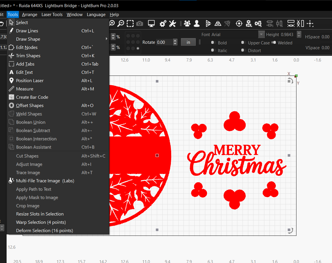

I recently upgraded to the newest Lightburn version and didn’t have any problems until today. I need to do a trace of a couple images but the trace tool in the “tool” section is dimmed. I’ve tried everything but still can’t figure it out. Can someone help me with this? Thanks!

Also when I right cllick I get a box but it doesn’t have the trace in it.

Ok, lets see if this one works
Great job with the snip! That is perfect :blush:

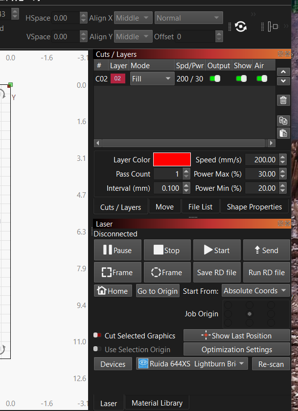

Please show what your cuts/layers window is showing. I bet you already have an SVG object, instead of a raster image (.PNG or BMP)
Thanks! Yes, it is an SVG not a .png. Do you think that’s the problem?
Yes, no need to trace an svg.
You trace an image to get an SVG out of it :slight_smile:
The image is made up of small blocks of different colored greys and blacks. An SVG or vector, is a line that is defined mathematically. You can zoom in on an SVG and it does not distort. An image will get blurry as you go in zoom.
