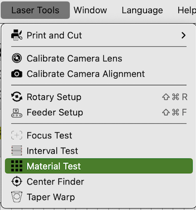

Lightburn material test menu.
Materials test after you get home/origin set up:
