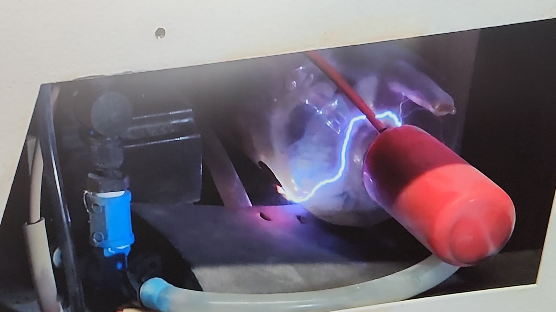

Tube arcs to machine body
I managed to catch this on video, the tube seems fine, cuts and engraves, this happens more when engraving though.
Every so often I hear a crack, and figured something was going on, so I opened the end of the gantry and saw this happening. Usually just after starting a job and maybe again in 30 mins if running a long job.
Been doing it for few weeks, sometimes not doing it for few days then doing it more.
Tube problem? Is only 3 years old and like I say cus fine.

Generally when we see this, the tube has failed. The lps keeps increasing voltage until it reaches trigger voltage and the tube starts to conduct. If the tube doesn’t conduct, then the lps keeps increasing voltage and it can punch through the hv insulation. I’ve never seen a tube that would work then fail then work.. Doesn’t mean they don’t exist, I’ve never seen one.

Yes it’s outside the tube. Coming from under the silicon sleeve down to the frame, don’t know if it’s touching the tube or not.

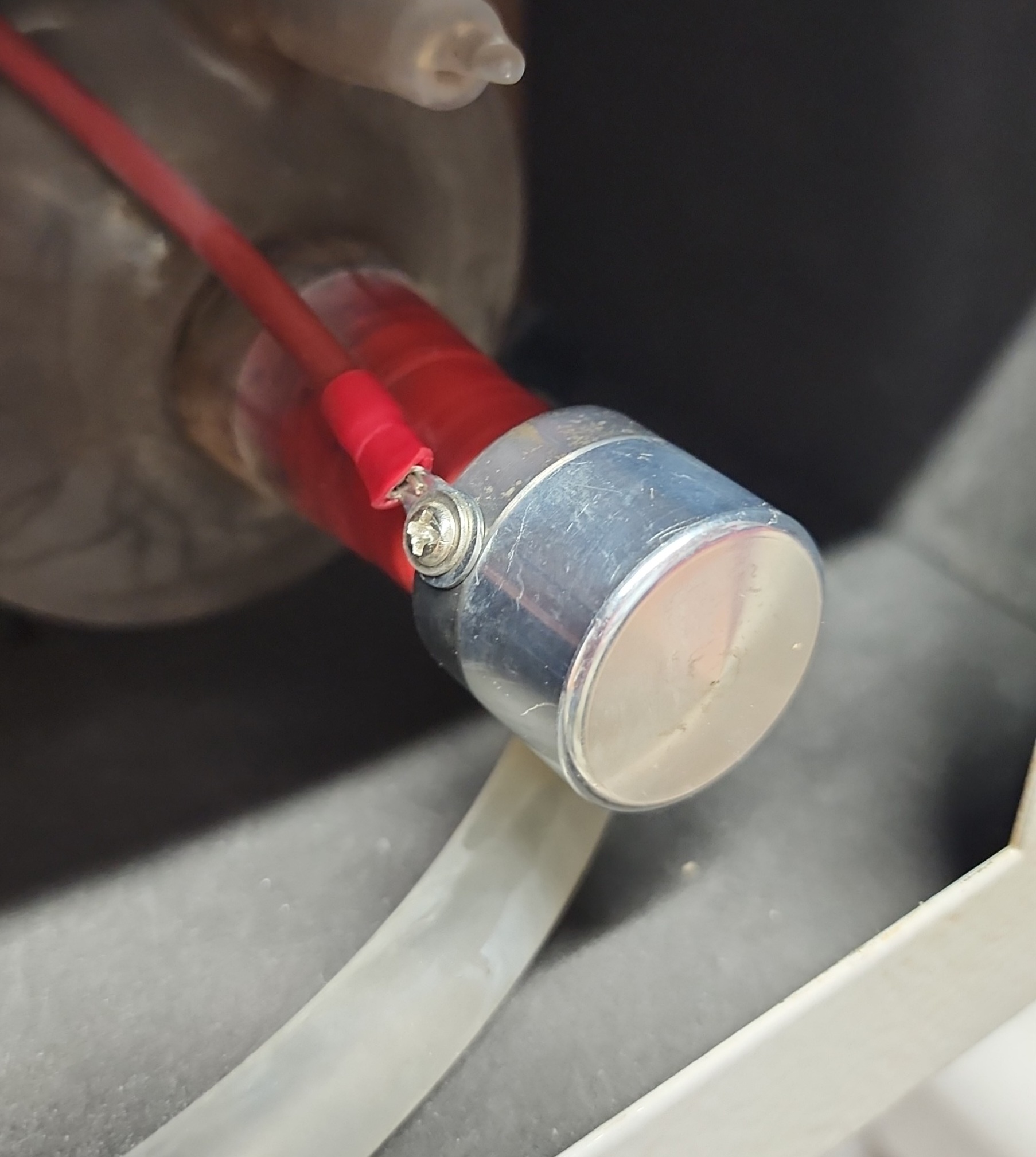

I do have the HV connected with a circle spade connector, could this cause the issue do you think, maybe I should remove this and just put the wire under the screw
That looks pretty secure. I wouldn’t rule it out though. That’s 2 connections VS 1. You could always give it a try if you have enough wire. How do the other connections look.
If there’s no holes in the insulation, this isn’t the issue.
Keep in mind that this is a 20 to 30kV area, so it doesn’t draw much current and with these high voltages, I’d leave it as is.
Look for a replacement cap, that’s it’s purpose.
:grinning_cat:
The ring lug puts a sharp metal edge half an inch away from the metal cap and creates an air gap under the silicone HV insulating cap. As a result, the silicone cap isn’t doing much: the arc travels through the air along the wire, latches onto the conductive dust coating the tube surface, and proceeds to the nearest part of the frame.

HI,
Before I saw your reply here is what I did so far.
I turned the ring lug 180 deg, so the hv wire comes round the hv metal end and attaches so this lug is inside the cap completely.
I cleaned everything with alcohol.
I covered everything over the screw and lug with dielectric grease and pushed some into the cap, to keep any moisture out and help insulate.

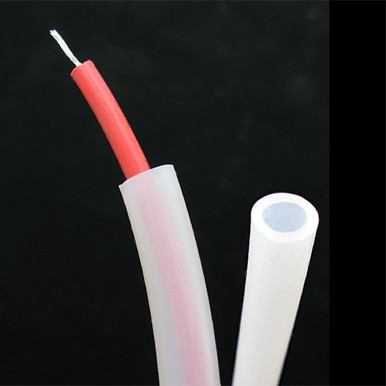

The other thing that might help is to use a silicone tube as a nice thick insulation sleeve in that area.
Something like this:
