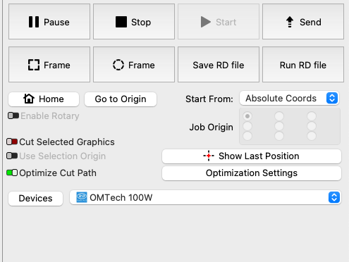

Show last position button? It’s not entirely clear what you’re asking for.
When I click the laser position button and then click the desired position on the workspace, I used it see a cross hair that remained visible so I could position the material properly.
I no longer seer the cross hair.
Can I turn it on somewhere?
Are you talking on the laser itself or in Lightburn? If the laser we need to know what laser / type of laser you’re using.
I’m talking about the workspace in Lightburn on the computer screen.
A crosshair used to be visible on the computer workspace when working with the laser position feature.
I could click a designated position on my workspace on my computer screen and the laser would move to that position on the laser bed.
I would continue to see the crosshairs on the workspace on the computer providing a reference point on the computer screen to make adjustments.
That’s turned on and off with the “Show Last Position” button in the laser window. I’ve found that sometimes you have to toggle it.
