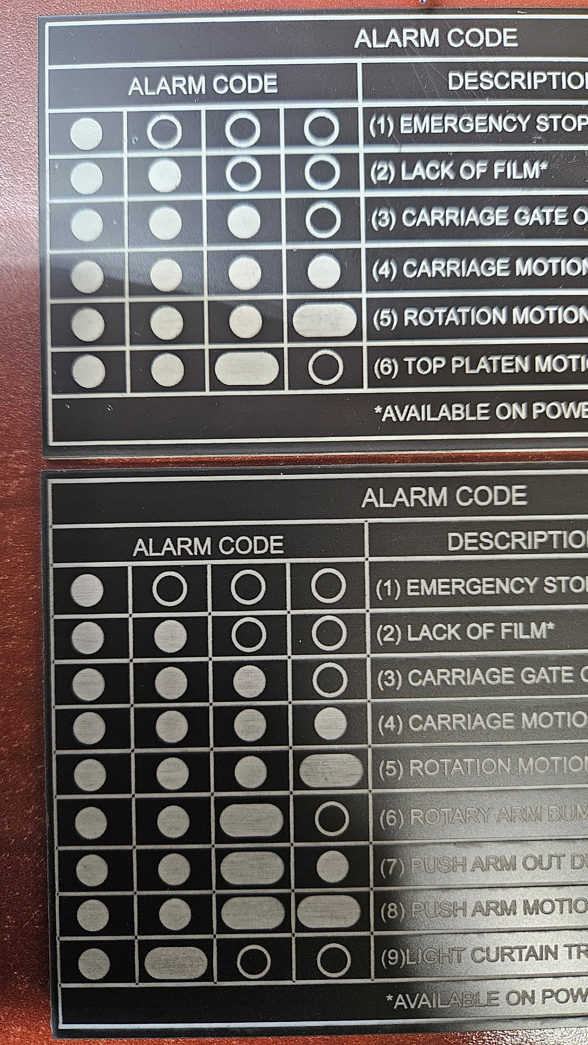

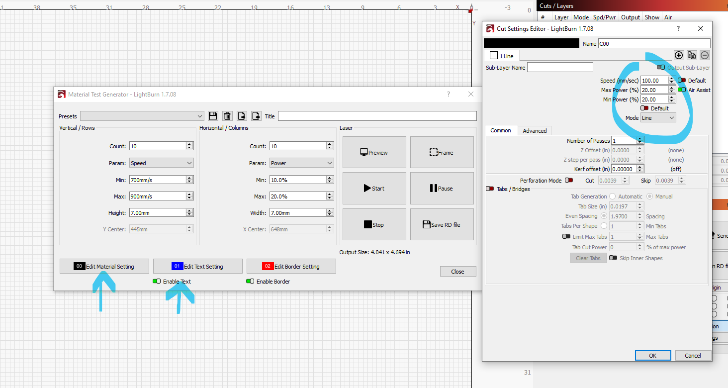

hello looking for help on trying to raster a two tone acrylic, without going to deep nore making dirt marks, i get it just enought, to almost have a clean look but still not coming out clear, as the older laser i once had. im using a rm laser 120w on dell computer, a rudia controler, and my acrylic sheet is 0.069 inch thick black surface and white under. i chaning image to bitmap, and trying to use the dither options just can’t get it good enough also make two path still comes out dirty.. what am i doing wrong. top acrylic in pic is from old machine epilog and the second one is rm laser.

That’s probably a step in the wrong direction, because bitmap dithering will make a mess of those sharp edges. Use a simple Fill layer with those shapes.
However, the small squares at the intersections of the lines suggest this started as a combination of thin rectangles on a layer set to Fill, where the intersections of the lines produced small unfilled squares:
Go back to that original design and Weld or Boolean Union the rectangles into a single shape to get a uniform grid:
The rough bottom of the large ovals and slightly jagged edges of the letters suggest the Line Interval is somewhat too large:
The spacing between successive scan line should be about the same as the focused spot size of the laser, roughly 0.2 mm for a CO₂ machine, so running an Interval Test around that value will help fine-tune the spacing for that material.
However, getting good-looking results with a glass-tube 120 W laser (assuming that machine) may be difficult, because the tube probably won’t fire reliably below about 15% and may be somewhat erratic slightly above that level. Engraving at the highest possible speed may let you use enough power to stabilize the beam, but expect to do plenty of experimenting to find the right tradeoff among speed / power / interval / material.

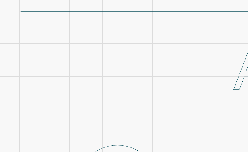

sorry even when i pull dxf in lighburn i have to re touch my circles for some to be double outline. do i need turn them into object from corel first to not have to alter in lighburn after.
I touched up your file. It only took a couple minutes. The circles needed to have an inward offset to appear as an outline. Your grid needed double lines as well in order to have it fill. As single lines, there is no width and they would not work in a fill layer. It took some clean up work because your grid lines were too long in places.

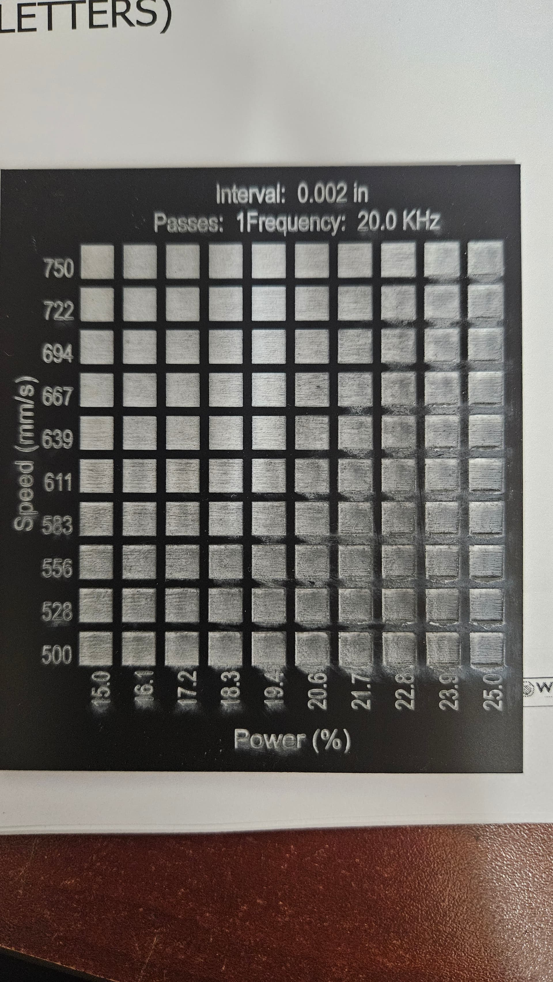

hi im still having trouble to find the right setting for power and speed to come out clear on the laser,. clear as in for the white layer to be white its like im not going deep enought or it to deep or not good interval. :confused: thanks for helping me the imiage is great that u done.
Can you upload an SVG file from CorelDraw? And, it would be good to see your settings for Lightburn. @thelmuth offset the circles inward in LB, which will get you close, but you are using (it appears) a 1pt stroke width on the grid lines. The easier fix, if you continue to use CorelDraw, would be to convert the grid lines to curves, and then Boolean Weld in CorelDraw. When you then export a SVG for LB to import, things should be in the right places.

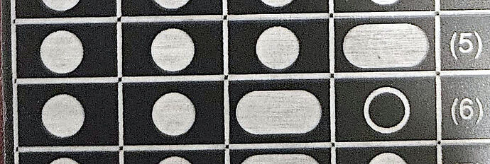

Here is a test grid of the out come i get. Pay no attention to green tape.
What are the words under the green tape?
Another material test, with lower power may help clean up the results.

Sorry here better pic without tape.

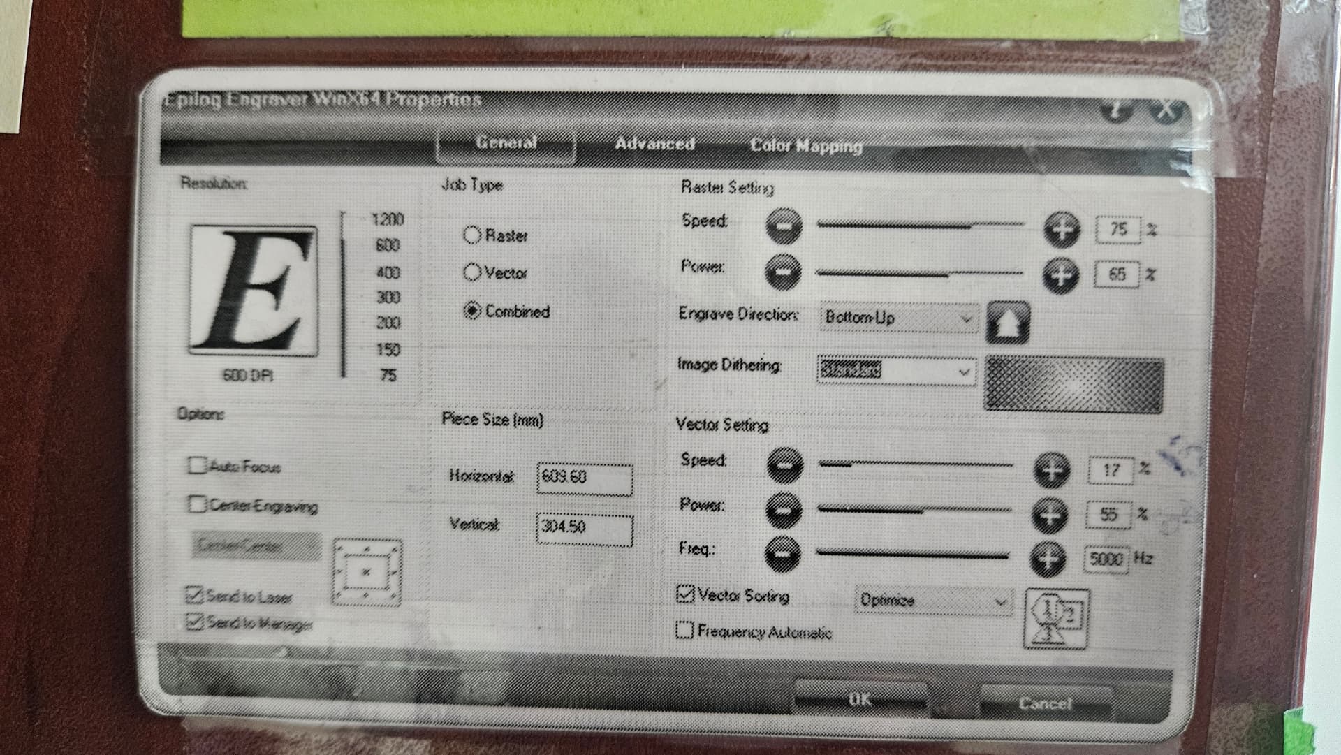

On the old machine was 50w mini epilog, my setting was at this pic below. New laser is 120w
This is an interesting challenge. If you were running a 50W tube at 55% power, you’d need to be able to turn down the power of the 120W tube to..
50W * (55/100) /120 = 23%
Your laser seems to be set up to go lower.
I’d recommend another 10 x 10 material test
700-880 mm/s and 10-19% power
The new laser has a different ‘sweet-spot’.
I’m hoping power can be reduced enough to do this nicely.

yes on the old machine those were the numbers over time the number been reduce from speed 75% to 35% and power 65 to 80% cuz it wasn’t lasering good anymore.
but i will do another test grid, the do i need to change any number in here when i do test grid.. for material setting / text setting boarder setting.. or leave it what ever number there..

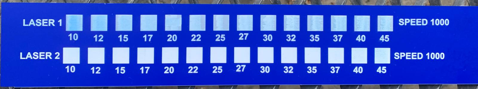

A similar situation. Two identical devices (THUNDER BOLT, RUIDA), identical software (LightBurn 1.7.08). One prints perfectly, the other has dirt on the engraving. I drew a test strip directly in LightBurn. I have been suffering for a month, I can not find the reason. I changed the equipment from working to non-working, everything except the pipe. Did not help. I think that the pipe is unstable. What do you say? It is impossible to swap the tubes. Stop production.
