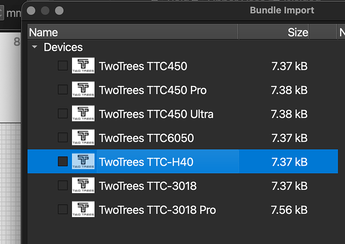

Are you using the profile we put in the software for your machine?

Thank you for the reply, yes ma’am I am running the profile from Millmage.
