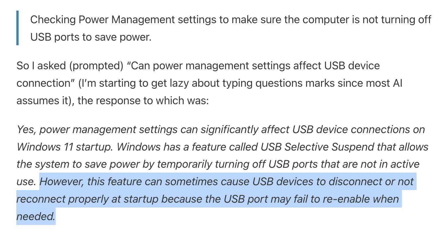

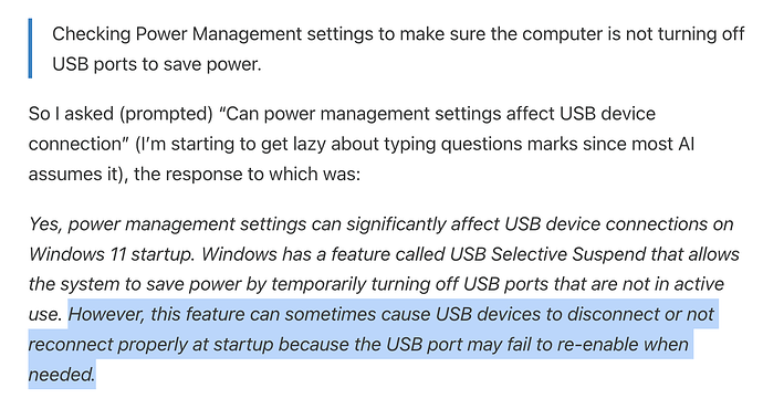

Windows USB power-saving strategies might be to blame for shutting down the port halfway through the burn (that or a screensaver setting). The connection should have woken up and reconnected right away.
I found this when I was looking.
From the article, this punchline may be AI generated.

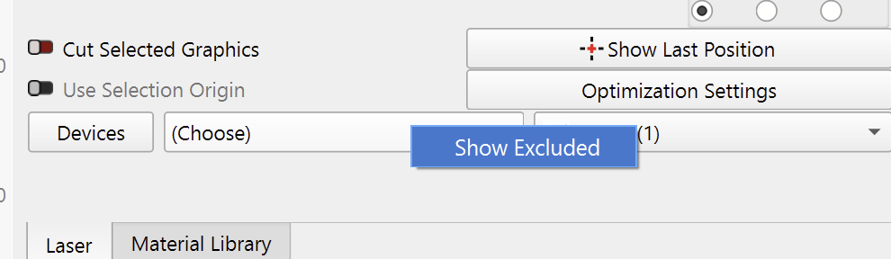

In addition to this, if the COM port shows up in Windows Device Manager, make sure no COM ports are excluded in LightBurn.
Right click the drop down, and select “Show Excluded”
If none are excluded, will it show “Exclude COMn” instead?
Correct. When a Port is selected, you can toggle it between include and exclude.
You can always toggle between Show- and Hide Excluded ports.
This logic makes sense if you play with it. Most people won’t need this, but I’ve seen Bluetooth headphones that were assigned a COM port.
