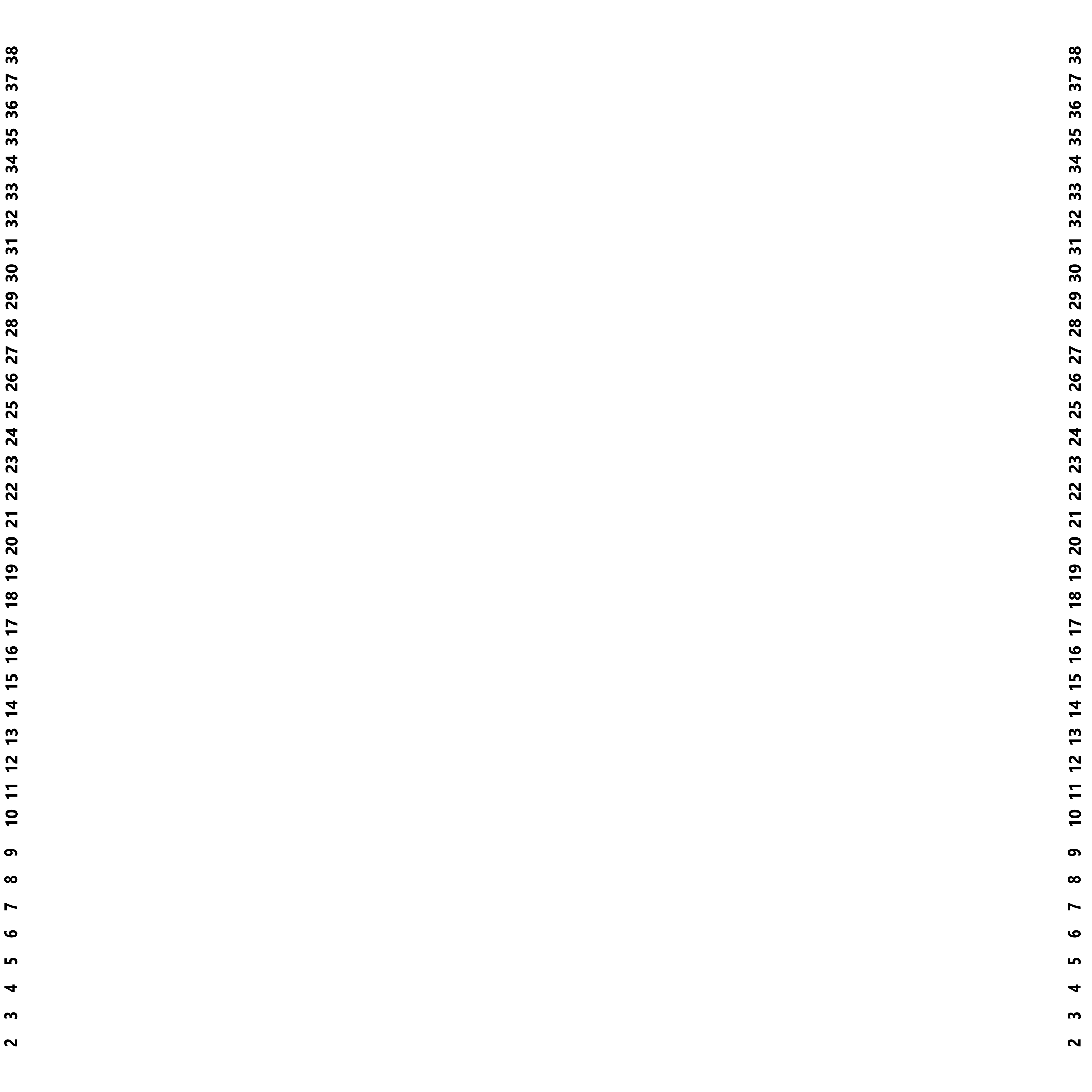

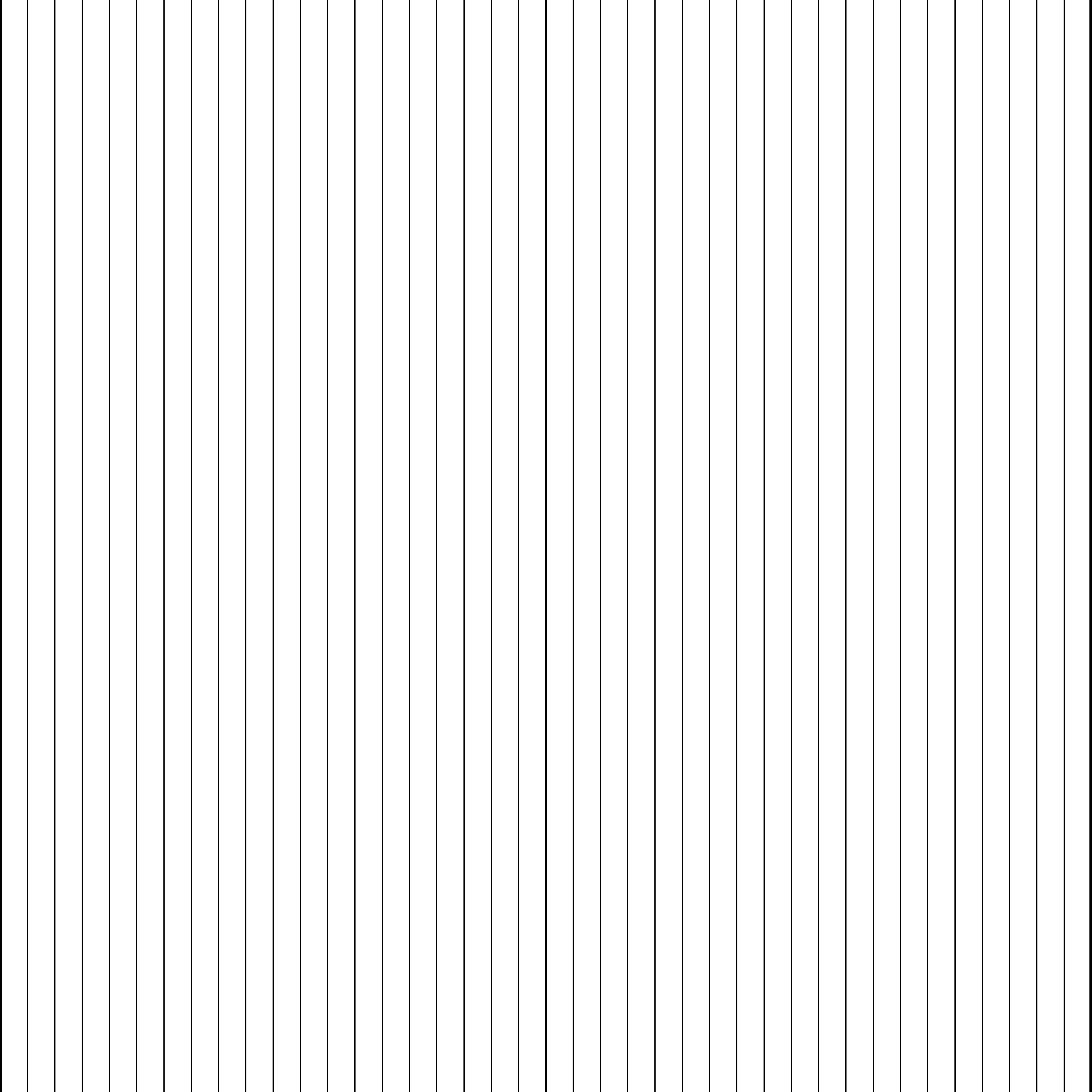

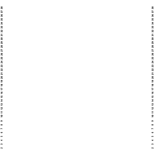

Trying to burn a grid onto my waste board and am unable to get the job started.
I just got my ortur lasermaster 2 pro assembled and am trying to burn a grid onto my waste board. I let lightburn detect my laser and everything seemed correct with the dimensions and home position. I have attached the files that I am trying to burn in case that matters. This is my first laser.
