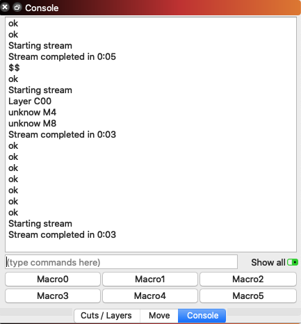

Type “$$” into the console and hit Return/Enter, then post what gets spit out here for review.

Screen Shot 2020-10-21 at 4.27.47 PM
Note: image of portion of Console.
Just realized, the software (BenBox)which came with the Universal Engraver, is showing in Console. I am evidently not even accessing Lightburn’s software.HELP!!!
LightBurn does not support the benbox custom firmware. You will need to flash your board with GRBL 1.1f (or later) firmware first. I think you can use the benbox software to do this but am not familiar with the exact steps required.
