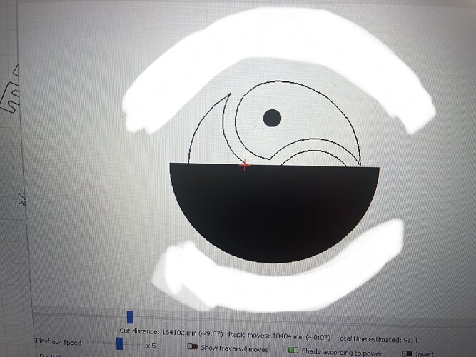

Good morning,
I’m getting fill in a shape where I don’t want fill. The only duplicate layer clean up pass is on some lettering.

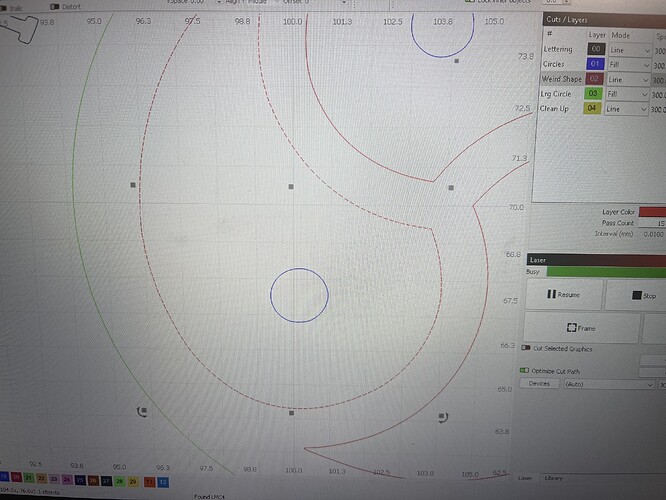

My shapes are all closed but the big circle just fills everything on the inside. Should I un group?
Blue circles fill - no problem
Red shapes no fill - line
Green circle fill - problem & fills everything
Space between red layer & green layer fill
What do you want the green circle to do?
The reason why it’s filling the entire area is because it’s on a separate layer and set to fill. Each layer is evaluated separately. If you want it to interact with the other shapes then you need to put them on the same layer.
