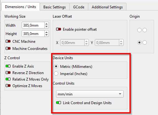

Update 2.1 now my settings, power, dpi all look wrong
Can someone help me fix this back. when I put 20 speed I dont want 20,000 speed.
Check the units settings, there are “new” options now:
I have the same issue as above, icon size was microscopic and I had to slow speed down to a 2 vs 25 normal speed for it to sort of work. My units setting does not show the same options as your post. How can I roll back this update?
laser tools->device settings
Took me a little bit to find it

Thank you! It now works like it should!
