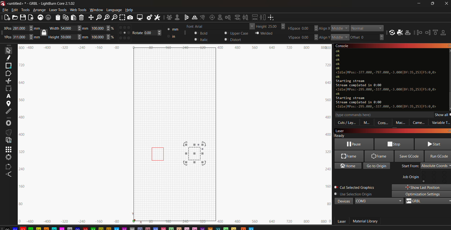

ALARM:2 G-code motion target exceeds machine travel. Machine position safely retained. Alarm may be unlocked. (Right-click the ‘Devices’ button to reset the connection) On or near line 4: all was fine before I updated to 2.1.01 and I am unable to sort it. I am running the FoxAlien 80W Fixed Focus Blue Laser Module Kit | Optical Output 20W Bed size 380x800

laser will now home at bottom left which it should. But when trying to frame a job it will travel to top right always

Sorry when launching litghtburn laser will auto home which it has always done. Then when finished comes up with this.
<Idle | MPos:-377.000,-797.000,-3|Bf:35,253|FS:0,0|WCO:0.00,0.000;-3.000>
I can jog manually.

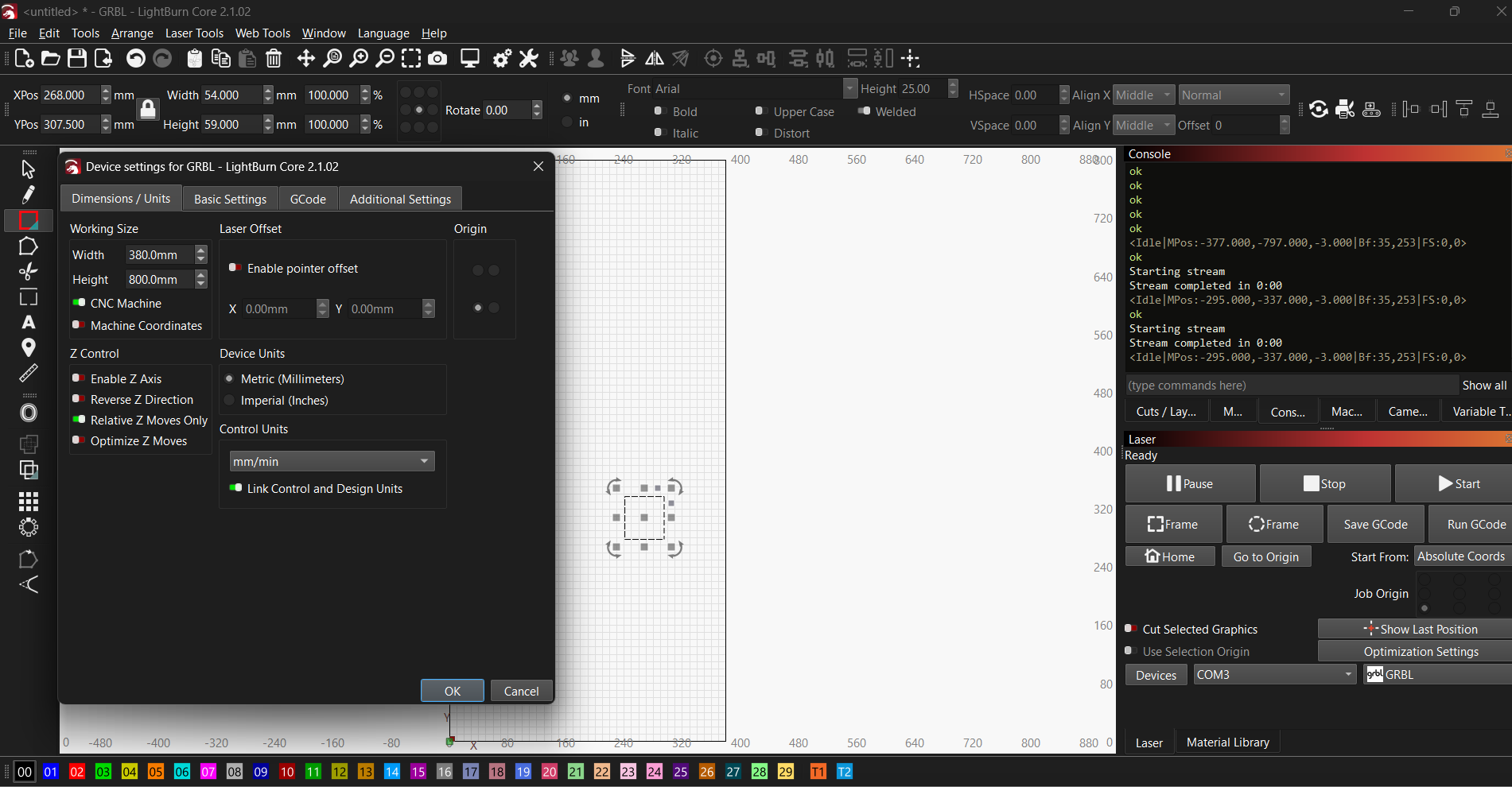

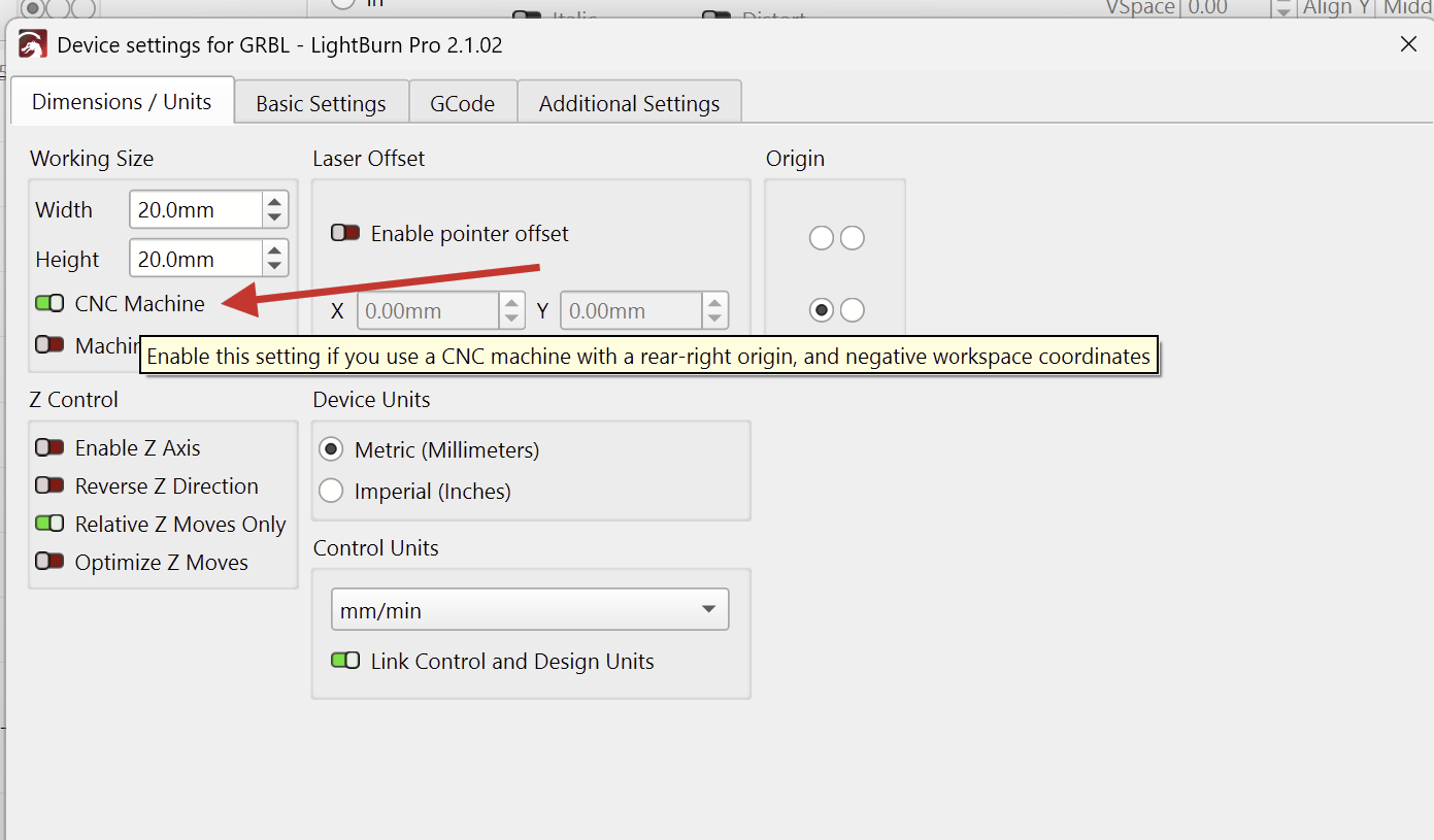

Enable the “CNC Machine” toggle in the Device Settings, and try framing again with “Absolute Coords” selected.
Are you using the GRBL device profile or Custom GCode? (Please send a screenshot of the Device Settings, so we can check.)
I have always used absolute coordinates I only use the machine for laser Work so Lightburn is my only option

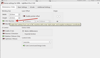

I’m talking about this option in “Laser Tools > Device Settings”
Enable this toggle and send us a screenshot, so we can see your other settings.
Hit OK, and try framing again.

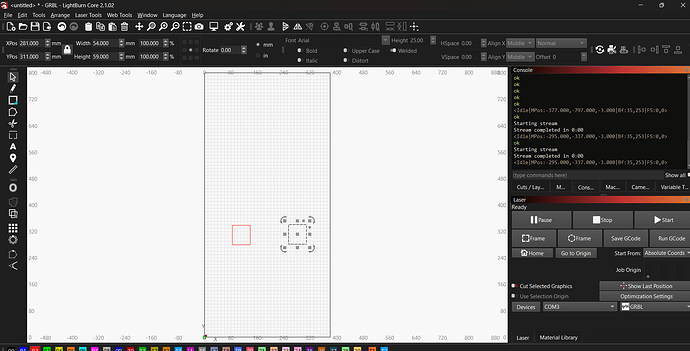

ok now it will frame once where as before it used to frame continuously until I stopped it. but it framed on the opposite side of the bed the one in red is where it framed and not the black where it should have.
