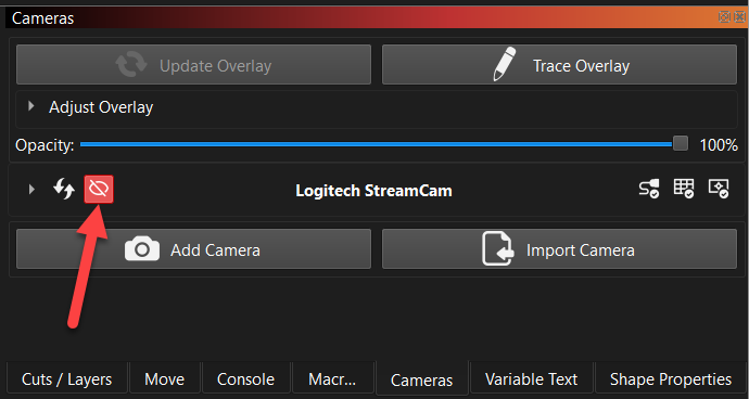

I have installed an overhead camera on my laser setup but I’m having some issues getting the overlay to appear on my Lighburn workspace.
I have been through the lens calibration and alignment procedures with no problems, ending up with a good looking overay which I have saved, but then what? The update overlay button is greyed out so I can’t do anything more. What am I missing? Can anyone help?

In the Cameras Window, do you also see the alignment icon in red here like this?
If so, click on the red alignment icon (which is also a button), and redo the alignment. There is a known issue with alignments sometimes not being saved correctly in v2.1.02, and starting the alignment wizard from this tool button can make a difference.
Another thing that can disable the Update Overlay button would be this little “global overlay visibility” button that may be deactivated (red) - click it again to activate:

Thank you for your advice NicholasL. I redid the calibration and alignment as you suggested and it worked out for me. Cheers
