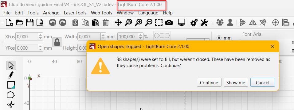

Updated to 2.1.0 - Shapes not closed
In the new version 38 shapes were detected not closed.
When i select “continue”, those shapes are missing in the preview
When i select “show me”, i cannot find any way to close those shapes
When i try to close those shape, the functionaly is greyed.
In the previous version 2.0.05 it was not the case. I have verified that all my shapes are closed and the job is ok.
In advance thank you for your help.

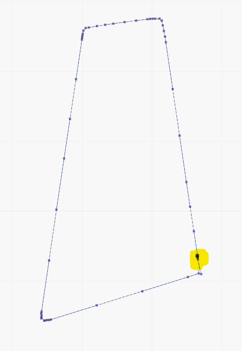

I’m having the same issue. I’ve edited the nodes on the object and the object is closed. Sample file attached.
Coaster.lbrn2 (243.4 KB)
You can Ungroup the C09 shapes, Brake Apart the shapes, Delete Duplicates, Auto-Join selected shapes and Group.

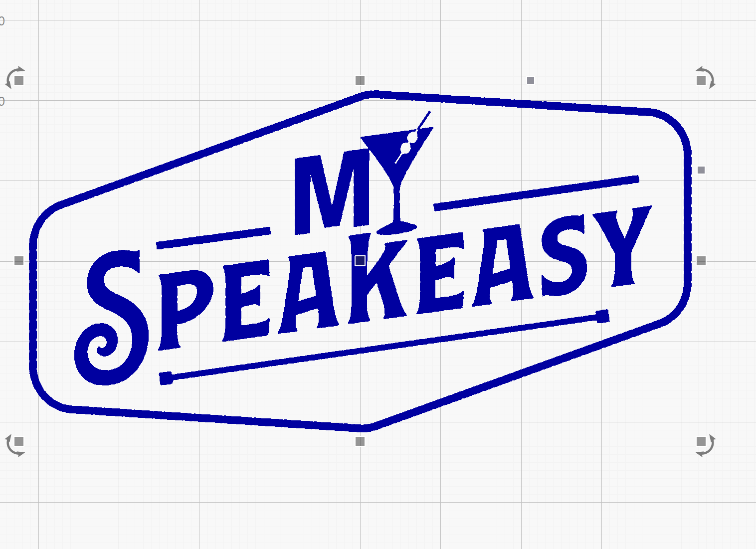

This appears to be a genuine bug. I’m working on a fix now.
Ok, this is a real bug, and has now been fixed, but it’s triggered by the artwork being kind of sloppy.
In the middle of the last ‘A’ in ‘SPEAKEASY’, zoom in here:

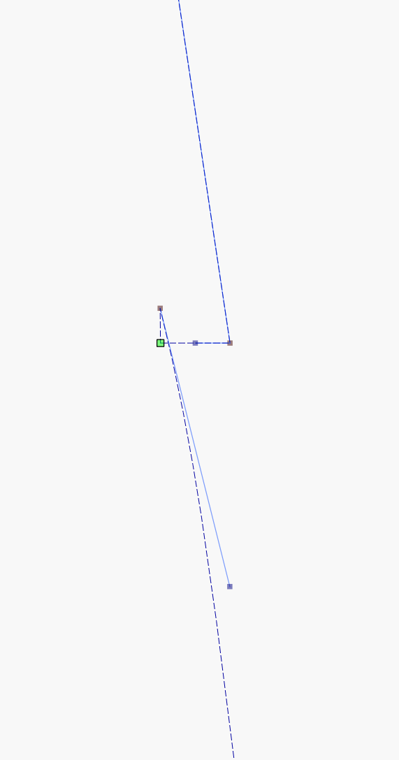

… and you’ll see this:
Those 4 points are all less than 0.01mm apart, so they’re contributing nothing visually, and if we left them in, the laser would actually stop there because that’s several 90 degree changes in a row.
LightBurn automatically removes them before sending the shapes to the laser, but there was a bug in the code that did it. If the line removed happened to include the very first node in your shape (the bright green one), the result would end up an open shape.
This is now fixed, but if you manually delete the useless nodes and reconnect the shape, so it looks like this, it will work for you right now:
