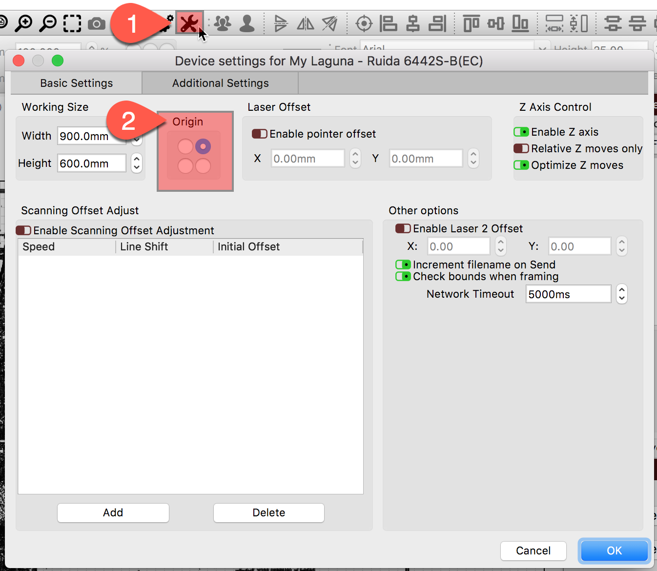

I am New to this.
I did a test run and typed Andy.
I did everything I had to,sent it to the laser and it cut it upside down.
I’ve looked at all the settings but can see anything that would rectify this.
Please help
Set the ‘Machine Origin’ to where your laser homes in the ‘Device Settings’ window. (Double-click the ‘Spanner/Screwdriver’ icon to expose.)
