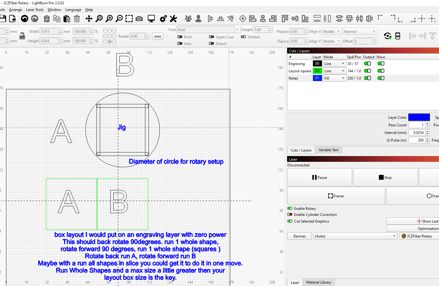

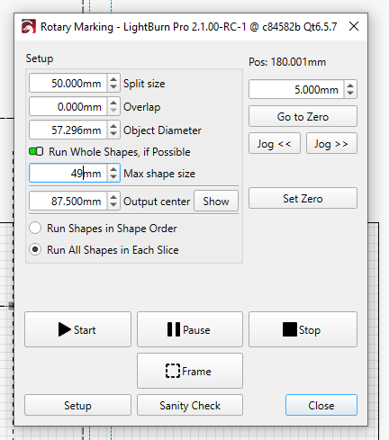

If you set your rotary to “Run Whole Shapes” and placed the art a distance apart equivalent to 90 or 180 degrees you could engrave 2 sides as you describe, would take a little experimenting to get the art placed correctly but it would be no different then doing something similar on an X table.

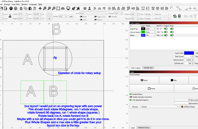

This is how I would approach your project. might work.
The rotary would flip over, but would then rotate as usual across the width of each design, distorting them perpendicular to the rotary axis. You might be able to pre-distort the geomtry using an inverse Cylinder Correction.

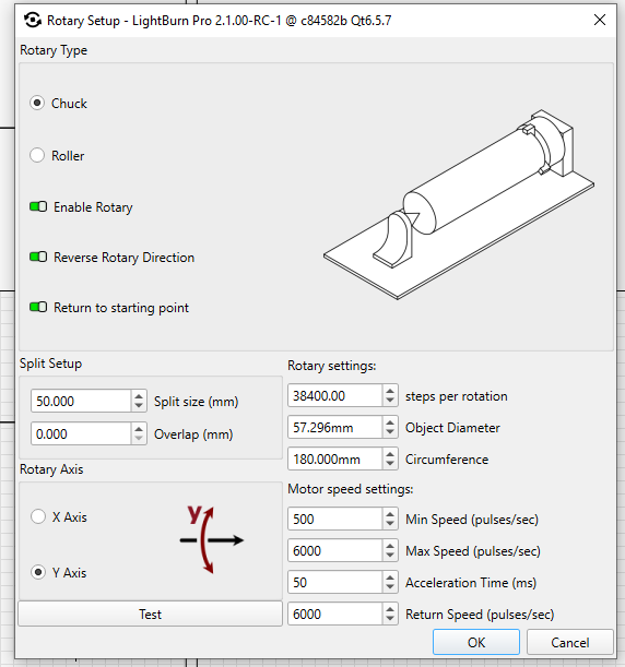

The split size may be a solution to this. I’ve never tried to use it so large, so I don’t know how it would work out.
Making the split size the size of your objects should stop the rotary from moving in fine steps.

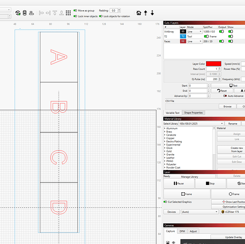

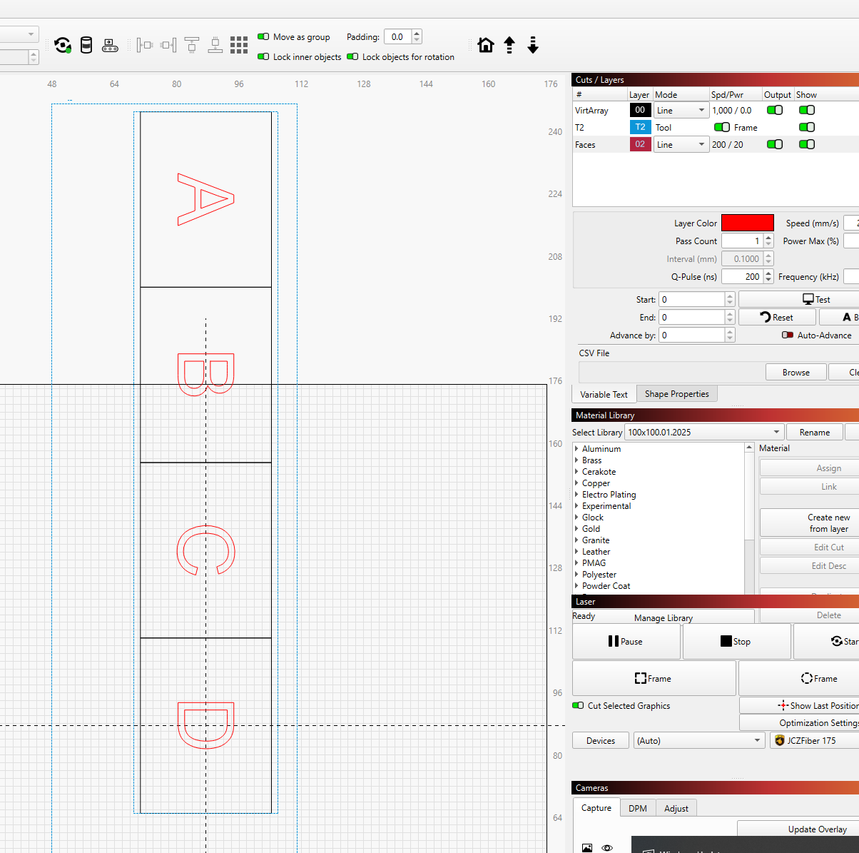

Correct, the run whole shapes : on, Max size a little more then 1 box and split size just a little larger then that.. Boxes should be separate squares but could be touching, don’t remove overlapping lines. It would then be forced to put A, B in the correct location.
I’m going to go and try. In theory, theory and practice are equivalent, in practice they are sometimes not…
Made 4 boxes 45mm, and used 180 for circumference. Doesn’t really matter that much as long as one is 4X the other and the 4X is the circumference

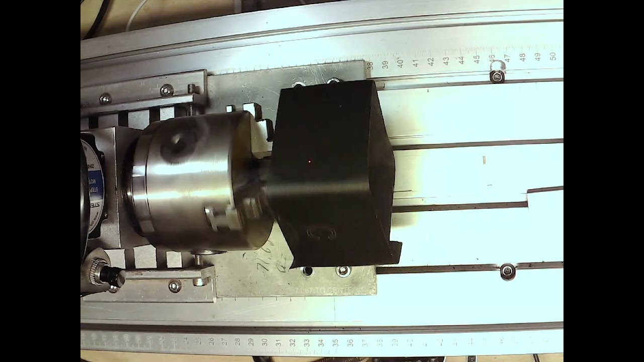

Well this application is for scope rings. I make them for certain actions. I currently rotary engrave the part number on the bottom and my logo on the side while the parts are still in the mill. I want to try to do this on my laser engraver.
