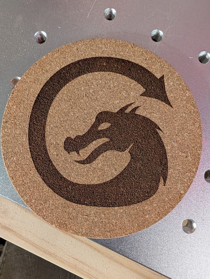

I just did 50+ cork coasters with my UV laser. They turned out great. I Have a test one I can clean up and send you a vid if you want. Just not sure what you want to see put on it lol.

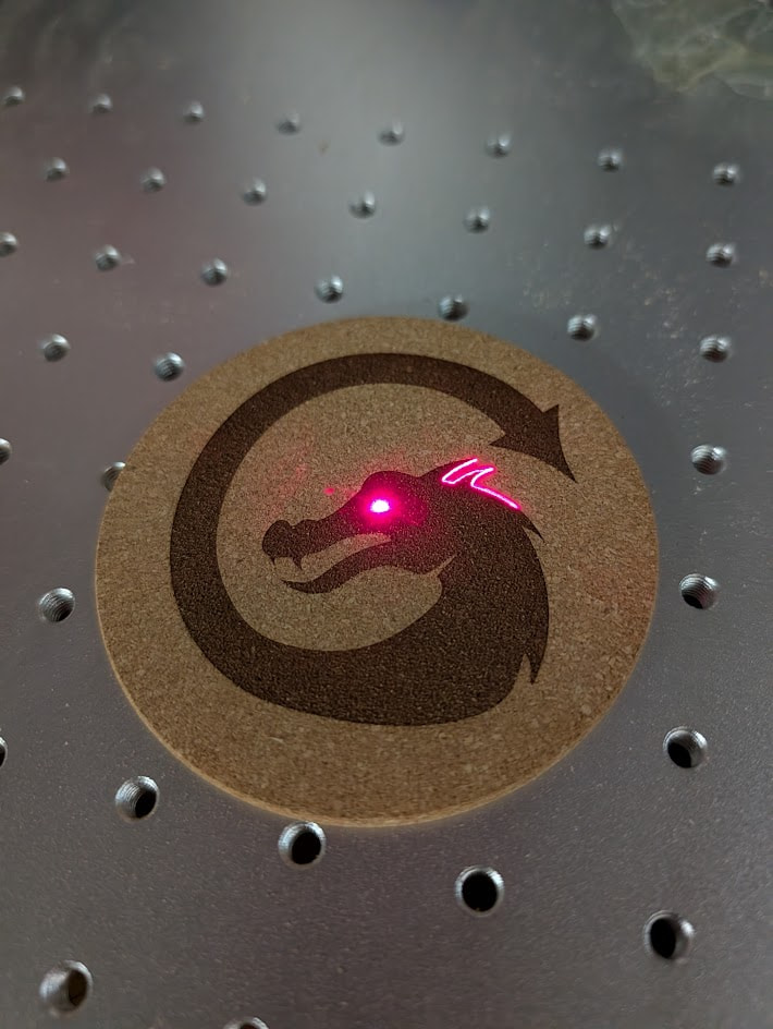

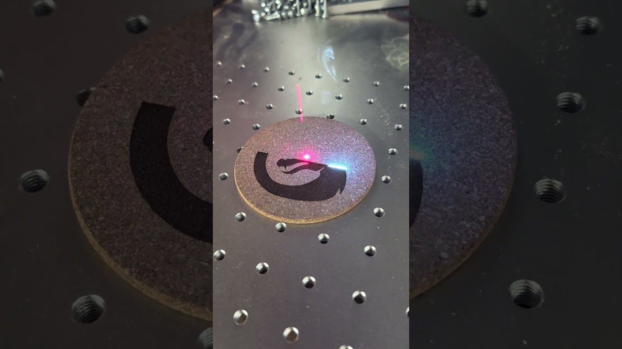

Here is a short I just did with a 5w UV on a 3.5” cork coaster. I like the red eye effect.

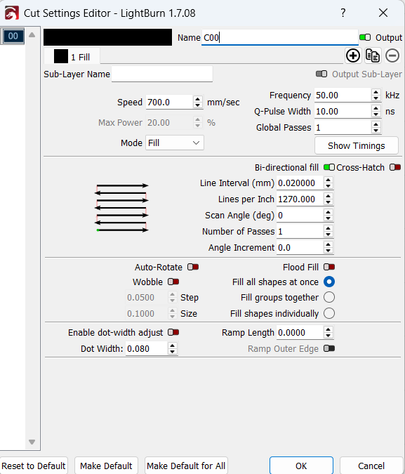

What kind of speed and interval are you using?

Here are the settings I used for the vid. They probably could use some tweaking.
